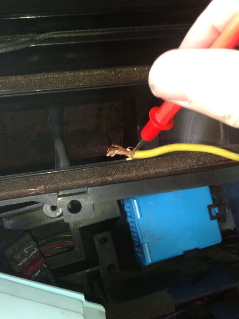

Here are some pics i just took like 20 minutes ago[IMG][/IMG]this is testing the yellow wire coming from ignition switch read 12.5 v

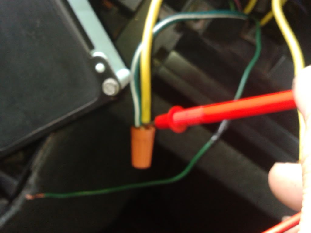

This a yellow wire now conected to the green and white wire. After connectin the reading show now 11.6 v.[IMG][/IMG]

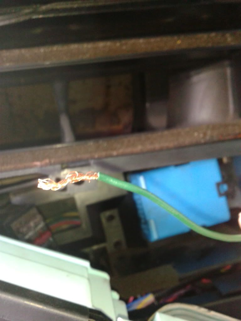

This is the small green wire. Dont know what to do with it?????[IMG][/IMG]

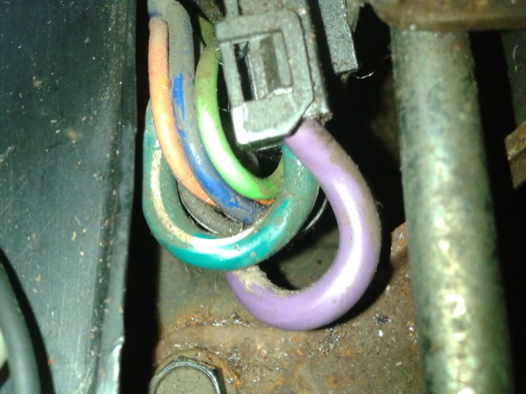

Green and with wire go to gear selector switch. But is very hart to riach to take some reading here is a pic of green and white wire going into the gear selectior swithc[IMG][/IMG]
