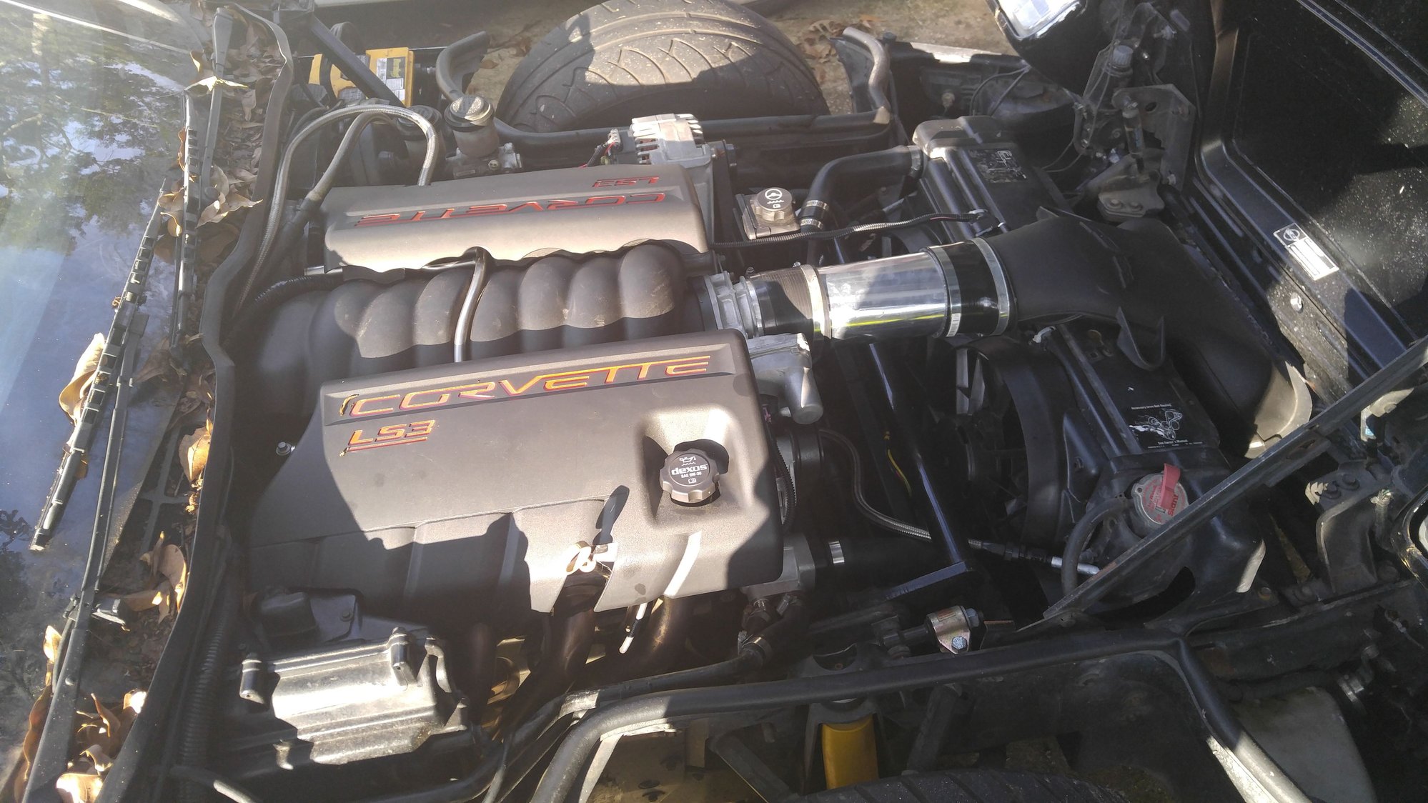

I just installed ford focus dual fans on my 85. Some trimming on the fan shrouds are needed. They work great

I can't quite put my finger on it....But it LOOKS like you might have installed something else -- in addition to a fan. I doubt it needed much trimming though!
That is one sweet looking LS3 swap! do you have a thread on it?
Sorry I don't have a thread on it, I hardly have time to work on my cars so when I do I don't want to fiddle with taking pics and updating threads. I'm happy to answer any questions though, just shoot me a pm.
