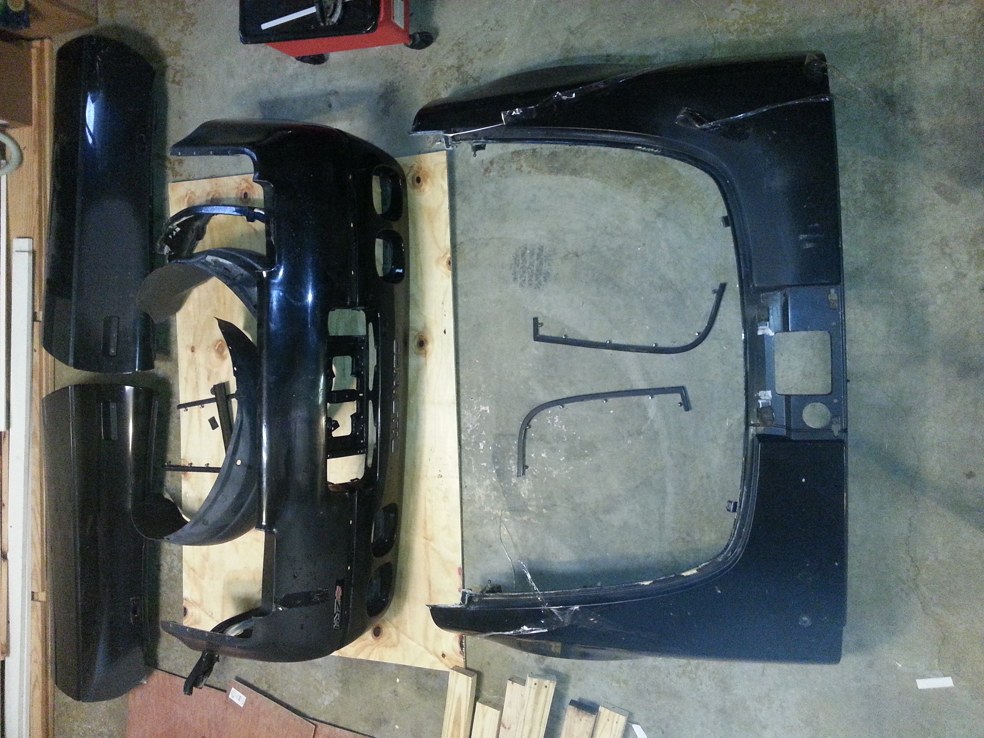

Default Parts have arrived
Recieved the ZR-1 parts today. My first home delivery by semi-truck!
Unfortunately the crate was put on the truck via fork lift and the dolly the driver had couldn't raise the crate high enough to clear the welded gate brackets of his door.
I had to unbox and remove the parts in his truck.
Also, we're getting a ton of snow right now!
However, Dino's did a great job of packing these parts up. The crate was 6' x 5' x 3' and weighed over 600 lbs but everything was in good shape and well padded.
I now have:
ZR-1 doors
ZR-1 rear quarters
ZR-1 rear bumper
ZR-1 rear wheel wells
ZR-1 door jams
ZR-1 body trim
What I need:
ZR-1 rockers
ZR-1 rear wheels (89 style 11")
I'm still moving forward with a custom rear bumper so I may have a ZR-1 rear bumper for sale. Or maybe I'll hang it on the wall.
