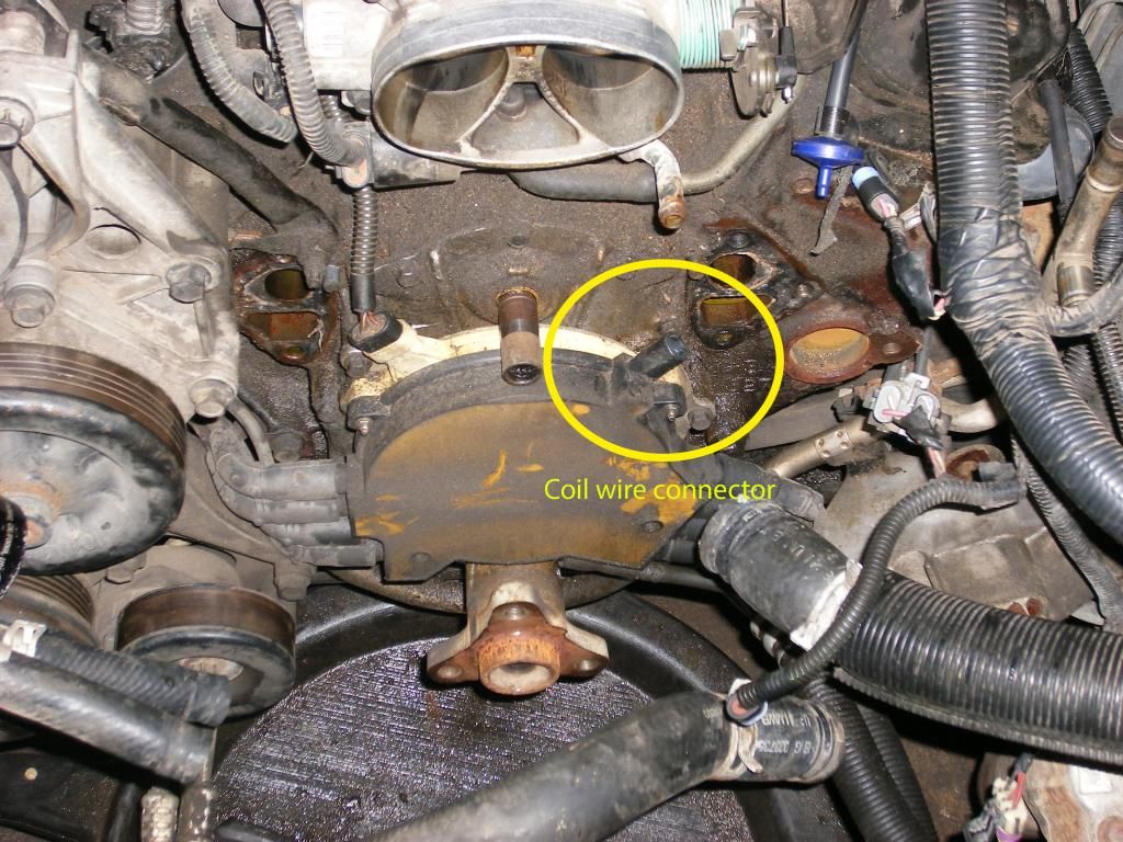

This definitely sounds ignition-related. How old are your spark plugs and your plug and coil wires? If you don't know or have never ever changed them, this might a good time. If you do, be sure to coat the spark plug threads with anti-seize and run a glob of dielectric grease all the way around the inside rim of both ends of each and every wire boot. You could have voltage short-circuiting at the coil wire connector on the distributor to some place on the block or water pump that's in close proximity, thus preventing it from ever reaching your ignition coil. If it's dark outside the next time it happens, and you can have someone crank the engine for you, you can check for arcing at both ends of the coil wire. It's best if there's no ambient light whatsoever when you do it, and even then, you'll have to look very closely. The coil wire connector on the ignition coil is somewhat easier to put eyes on than the coil wire connector on the distributor. If you have one of those little telescoping swivel mirrors, that might help as well. Any arcing is a sure sign of a problem. That's the first thing to fix if you notice any. Either way though, I'd stick a glob of dielectric grease all the way around the inside rim of both ends of your coil wire, whether you notice any arcing or not. When you put the coil back in, make sure you get the boots back on the connectors all the way. You'll usually feel the boot snap into place when it gets to where it's supposed to be.
