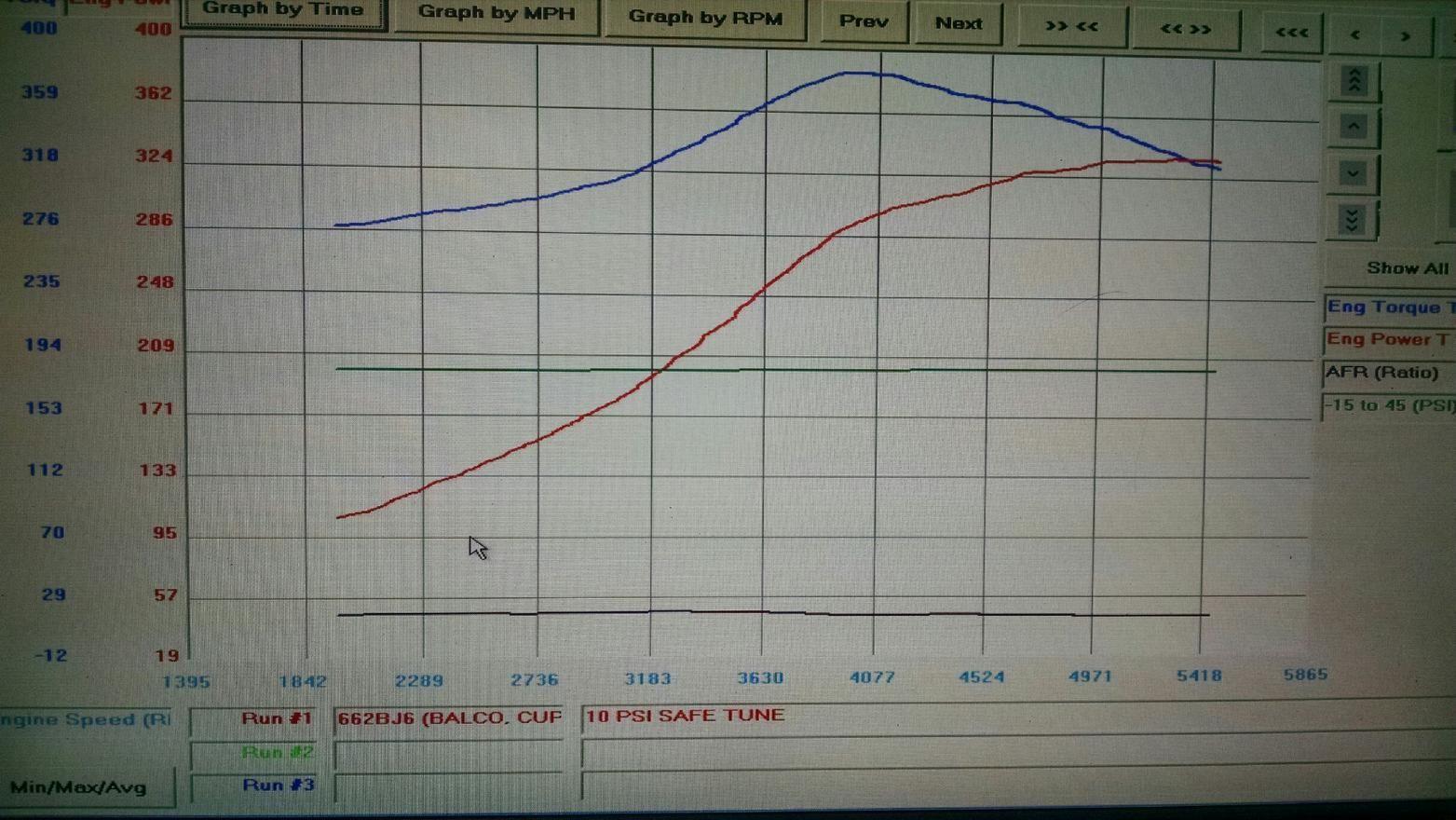

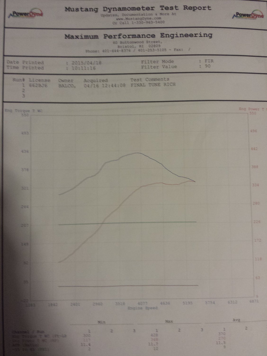

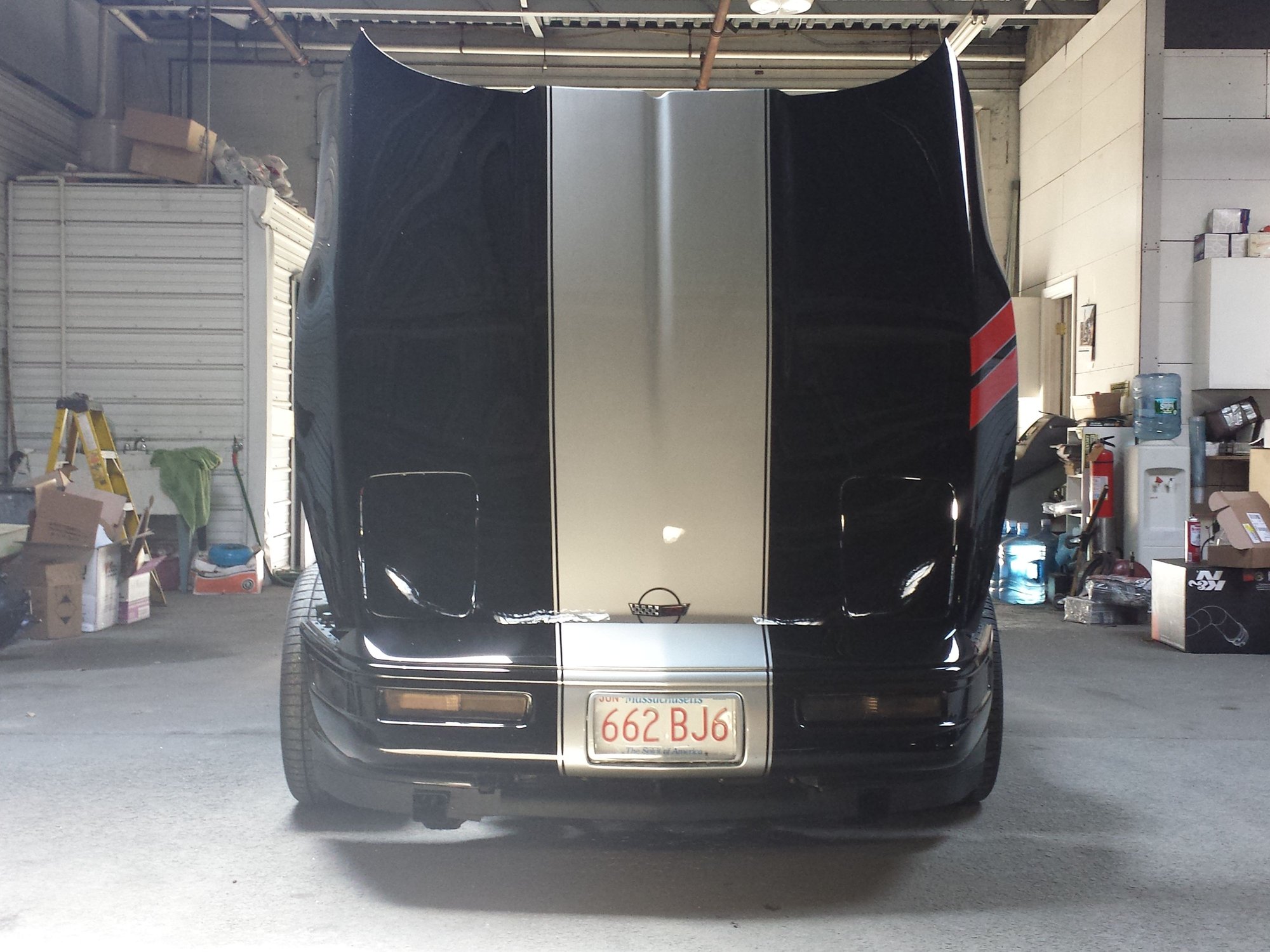

I dropped the car off at the tuner and he quickly let me know that his dyno doesn't give up the great inflated numbers that other dyno shops do. He uses a SAE Calibrated Mustang Dyno which from what I am told read lower than any other dyno on the market. I received a phone call from the tuner, Buddy Sousa of Maximum Performance in Bristol Rhode Island. He told me he started tuning and so far after a little bit of tuning he squeezed an Uncorrected 347 HP 397 ftlb to the rear wheels at 10 lbs of boost all on a very conservative safe tune when the motor was hot and with a max RWHP of 367 when it was cold. Now I know the numbers don't sound impressive but let me put these numbers in perspective my tuner has tuned a number of LS cars and he states that a bone stock 505 hp C6 Z06 puts down 385 RWHP, stock 425 RWHP with headers exhaust and cold air intake. I can not wait to pick up my newly transformed budget build rear mount turbo corvette to see what it is like. If I am not impressed I am told I can ad meth injection and retune it for some more boost, timing, and power... FYI the 2010 ZR1 in these pics put down 505 RWHP in stock trim on this very dyno.
Here is a picture of this gorgeous vehicle

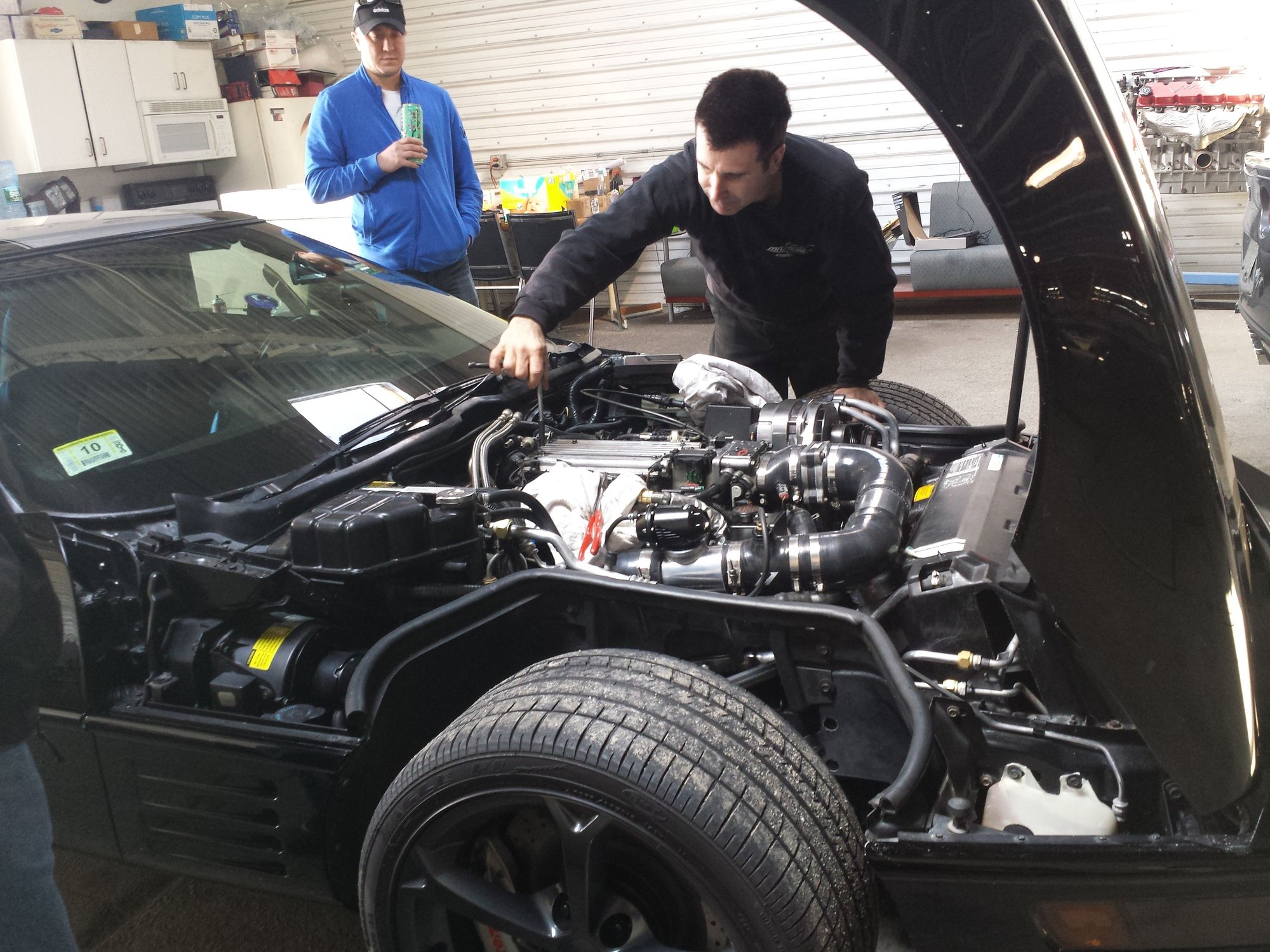

Completely stock motor with 50# injectors Walbro 255lph pump... I am picking it up tomorrow so I will know all the information and should have some pictures and videos of it.

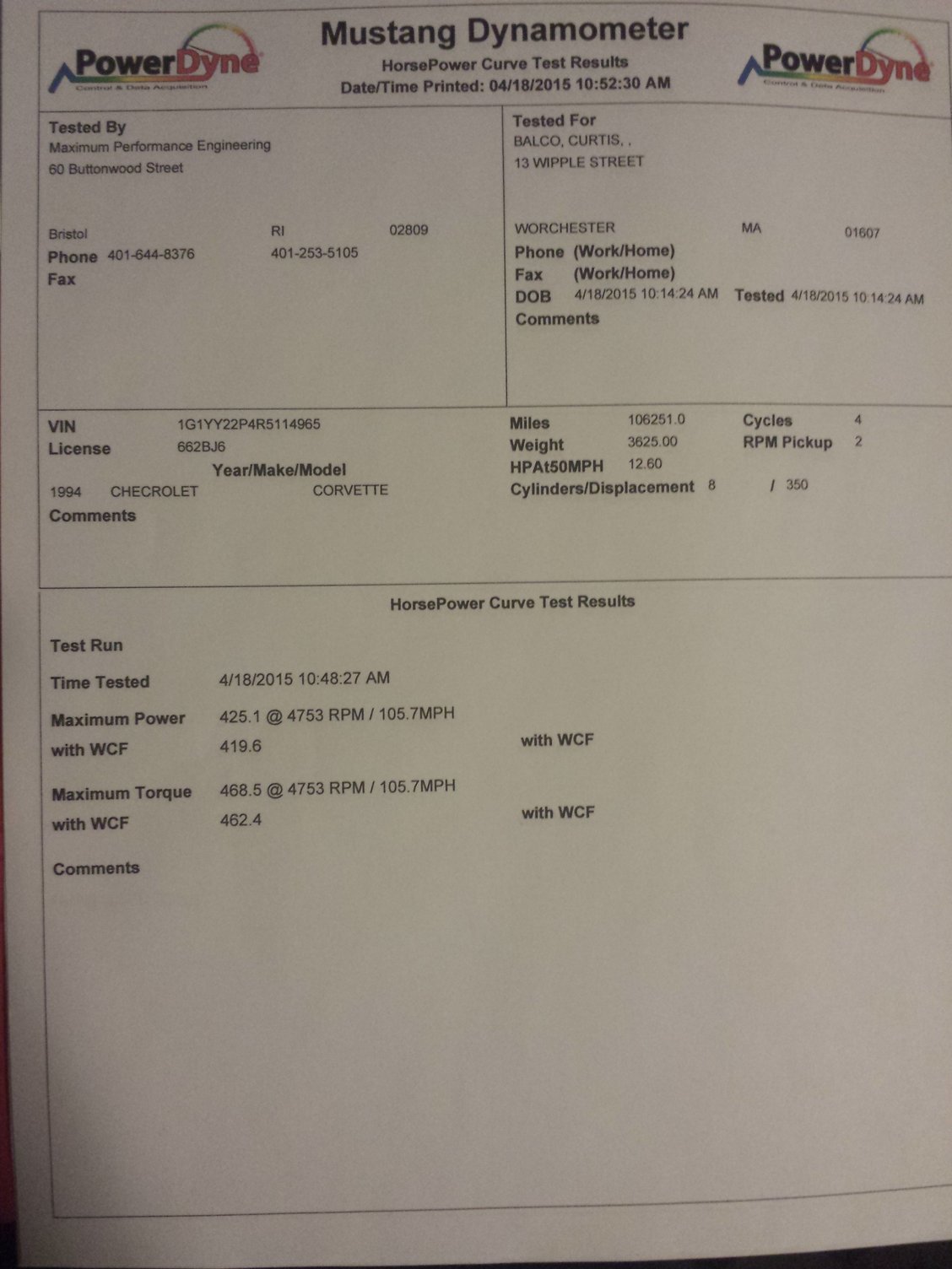

I think the tuner stated that the intake temps seem to stay fairly low on boost bit they do climb when the car is idling around because of lack of air flow and the charge pipe is close to the exhaust in some areas. On a cold pull the car made a corrected 425 RWHP with 10 lbs of boost when the car got hot it's running 347 rwhp. The car behaves like a stock LT1 vette until you kick in the boost then it really throws you into your seat. I a happy with the results and i can't wait to get this car on the track.
