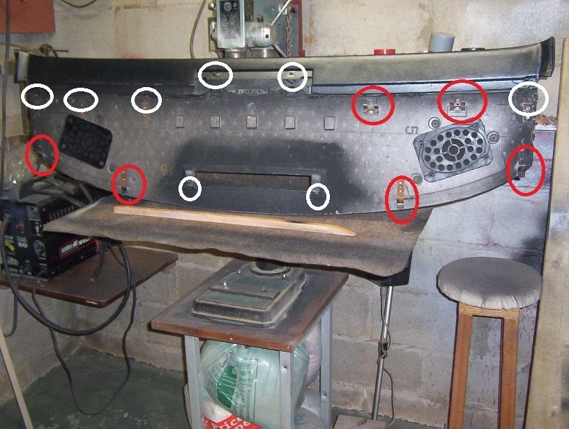

This is my 84 with the screw locations circled in white and clips in red.. Your 89 may be similar..

Thanks! Appreciate advice and pics.... Very helpful!
