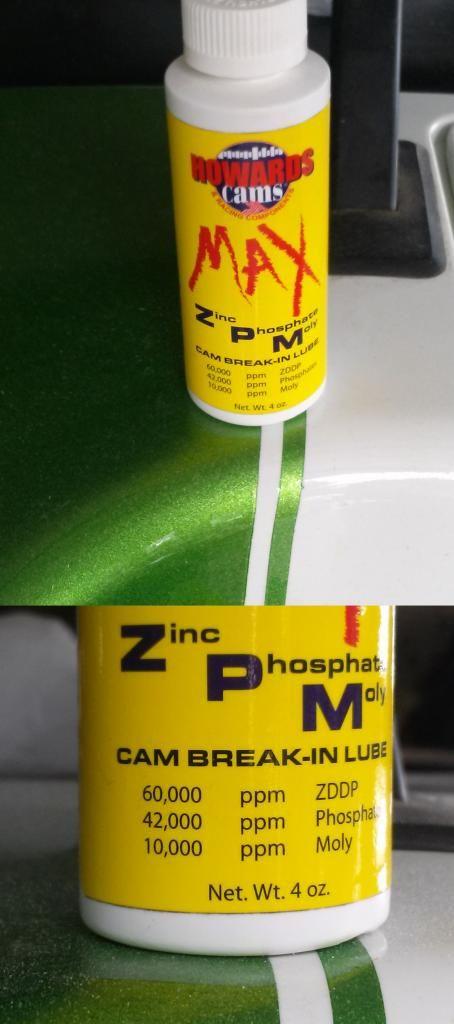

I put in an order at Summit this spring for stuff needed for a 383 build, and I forgot I had ordered this for the cam break-in. It's a 4oz. bottle of Howard's cam break in additive. States right on the bottle the ppm of the zddp, phosphate, and molybdenum. $8 at Summit.
Was just out at the barn mocking up the exhaust on the test stand. A few more tidbits to take care of and I hope to break in the cam on the 383 this weekend.
To Zddp
