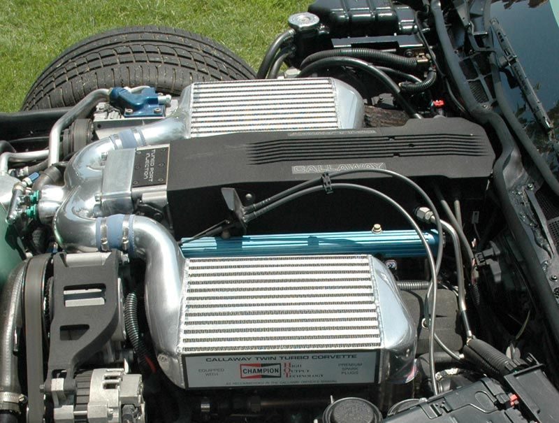

if you remember guys,there was a custom intake made by Callaway in the early B2k conversion.It was a TPI intake without runners,basically the same as previous pic. A plenum welded over a single plane intake...Making an elbow out of a stock TPI plenum is a piece of cake,instead of lot of welding on a prototype,i would take this way...

^That is not a
That was a "TPT" looking intake (plenum) cast as one piece with short-mid length runners. Very much like a shorter runner HSR, or a tall plenum version of a Miniram.
