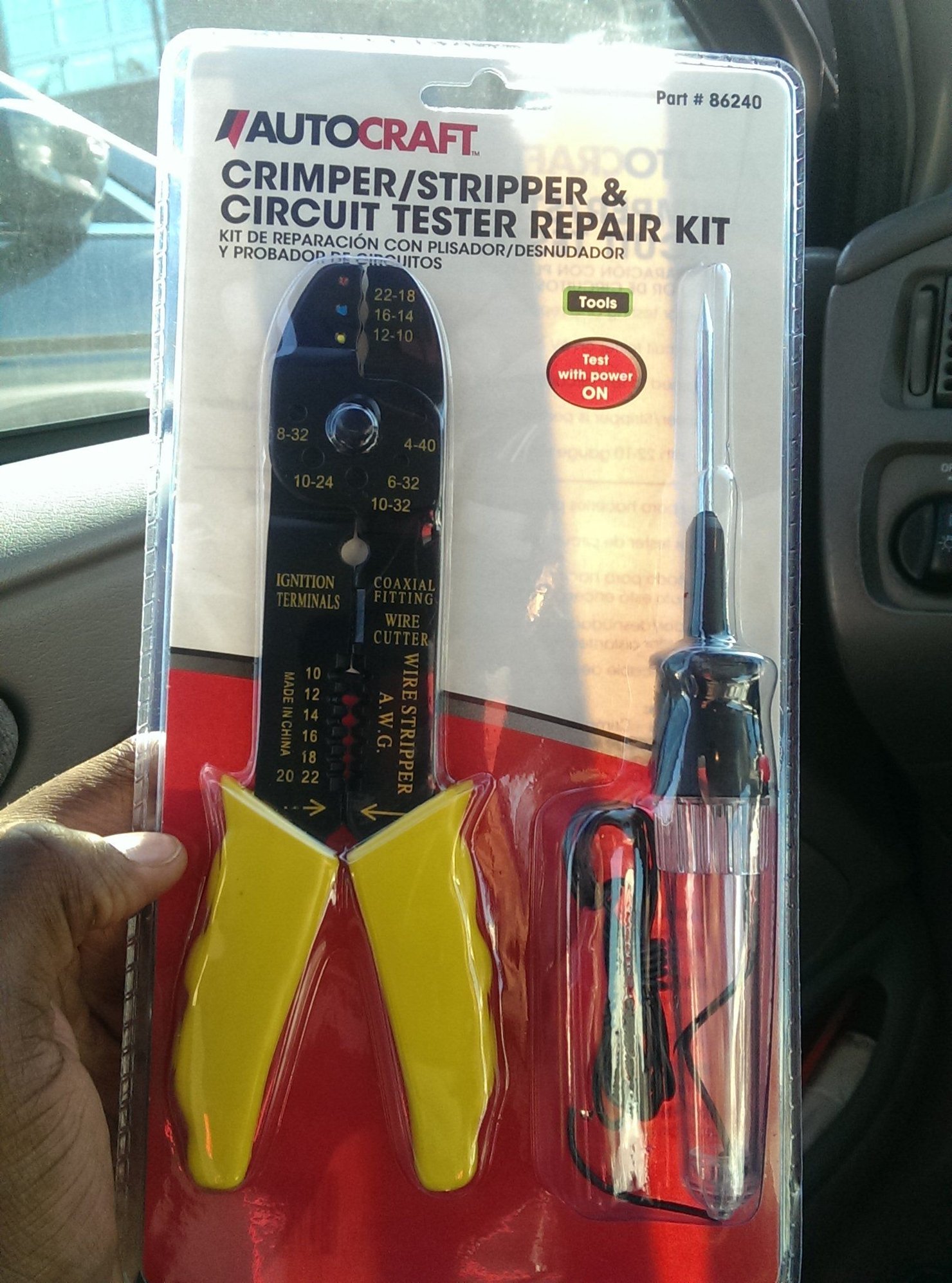

I have her jacked up now. I'm testing the starter and stuff with this.

In the first vid IDK if you "jumped" the right wires Looking at this schematic (top left diagram. Disregard the other three):
...it looks like you should be jumping a Dark Green wire w/a white trace to a Pink wire (wire looks purple in your first vid). Are those the wires that you jumped? I think that you did, which only proved one thing: the relay MAY not be bad. Probably isn't bad, but we still don't know where you have power to.
In the second vid, you want to put your test light probe on the small wire on the solenoid while the key is in the crank position. It would be the smaller silver threaded posts on the left or on the right, in this pic:
Is the dash still apart? In wiring diagram above, you can see the flow of electrical power to the starter;
Battery > fuse box > ignition switch > Park/Neutral safety switch (in center console by shifter) > start interrupt relay (in the dash) > small post on starter solenoid.
SO, The easiest place to start is by going back to the relay in the dash and check for power there, at the Dar Green/White wire using your test light, with the key in the crank position.
If you have power, the problem is after or including the relay and we can test for that. If you don't have power, then we need to move "backward" in the circuit toward the battery....either testing for part at the P/N safety switch (easy to get to) or at the ignition switch (a little harder to get to).
Test for power at the start relay in the dash, key in crank position.

My only concern in the video is the ground connection on that tester. Are you sure your getting a good connection? Make sure that alligator clip is touching bare metal.
When connected to that ground put your probe on a known working 12v something to make sure the light turns on.
Once you verified your ground connection, place that probe on the large red wire at the starter and hold that probe there. I'm sure your already aware not to let that probe to come in contact with both a positive and negative... just putting it out there. safety first.
