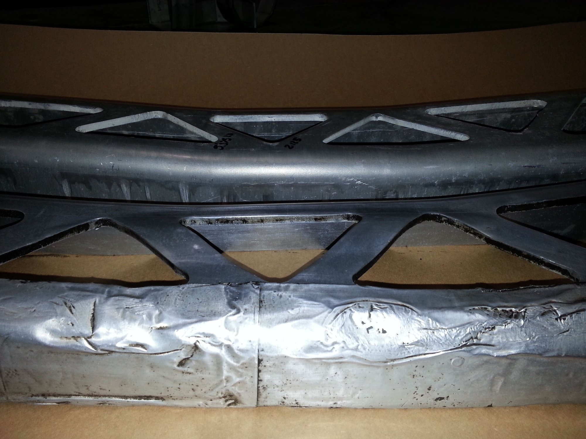

The c beam I took out of my car looks bent. This is off a zf6 car. The other beam is longer and I believe it's from an auto. Can you see the bends in the zf6 beam? Is it normal? There appears to be machine marks but the bends look weird. Hopefully these pics work.
Zf6 on the bottom

For a factual answer, you should contact Bill, and send photos:
E-mail billb@zfdoc.com or call Bill Boudreau at (602) 319-6575.

My 92 6spd is the same way.
Will

The beam is NOT straight. I measured a D36 beam one time a very long while ago and I believe there was an arch maybe something 3/4"+ at the widest point of the arch. Something near mid-length of the beam. I don't have one close but it should be very easy I'd think to compare side by side if you have both.
Drop a pair of the rear beam bolts through the front bores to establish a fixed location and confirm from that.
The deformity you "think" is present on the D44 is also just the way it should be. The D36 beam does NOT have the depressions at mid-length.

The depressions is what was freaking me out. The only reason I really noticed it is because the other beam I have doesn't look the same.
Thanks guys. Back under the car I go.

If you are talking about the X beams, they are rounded to fit the drive shaft.

Will, yours started out straight and now is way bent.

Yes, the X beams. The reason I got nervous is because the other C beam from an auto doesn't have them. Next time I'm under the car I will look at the clearance.

X2, and I just had mine out (also a '92/6 spd). It's fine.
