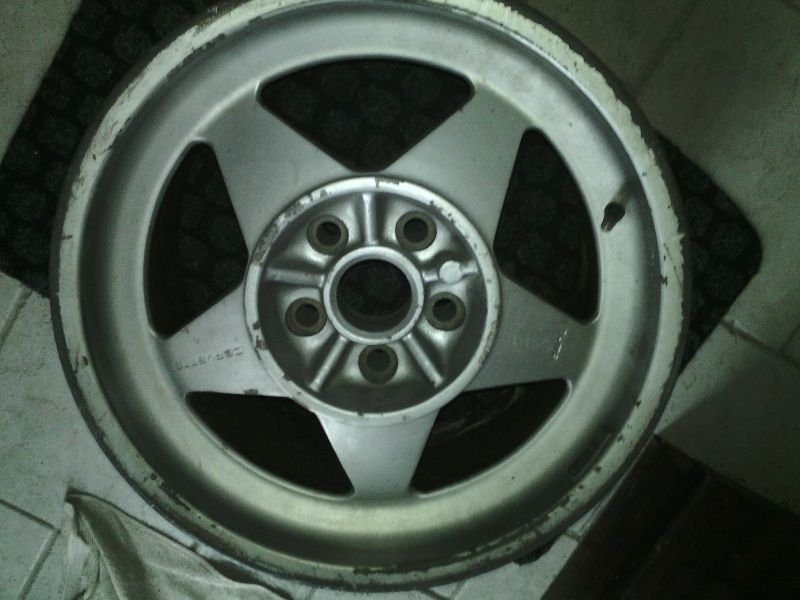

Hi everyone,
I just bought a set of dymag but the backspace is not the same as my oem rims. It is 5.5" while the original wheels are 7.4".
I allways read that the 17" gen1 dymag were 7" backspace so i don't know why mine are different.
it seems that they are made for 84-87 C4.
http://i59.servimg.com/u/f59/18/50/80/46/img_2010.jpg
http://i59.servimg.com/u/f59/18/50/80/46/img_2011.jpg
http://i59.servimg.com/u/f59/18/50/80/46/img_2012.jpg
http://i59.servimg.com/u/f59/18/50/80/46/img_2013.jpg
Does someone knows why these are diferent ?

I just check the wheels and found there is the inscription G33GP4 on a spoke inside each rim.

I just checked the all 6 rims, they are 18.5" external diameter and around 10.35" wide.

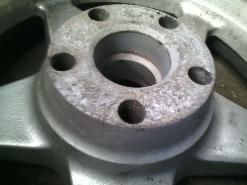

they are all 5.5" backspace. The hub of the rim is impressively thick and the holes for the stud are very large compare to the original wheels.
Here is a picture of the outside of the rim :
here is are two pics of the inside of the wheel :
as you can see, it is very thick
The mounting hub thickness could be a tremendous "plus" for you as you could likely have the wheel machined to accommodate a very special fit to a particular car. If they're true that shouldn't be an issue, they need refinished anyway so you can spiff them right up for a very good fit. The center-bore could be important, for a C4 you want a 70.3 for the rear of the wheel and while you're doing the machine operation you could also tailor the outer center bore for a center cap of your choice.
You only need someone that understands what they're doing.
The current center bore is around 70.3mm that tends to confirm that they have been made for a C4. I checked the weight of the wheel, i know it is not a proof that they are true dymag but if they are heavy, they are not dymag.
The weight is 20.4 lbs.
I totaly agree with you, i think i will get it machined at the backspace to fit just right with the fender.

I hadn't mentioned earlier and maybe I actually overlooked it but you mentioned larger wheel stud bores than stock. I'm also assuming you've done nothing about refinishing/restoring them either.
I'd do this maybe, measure the bore of the wheel stud holes OR maybe gather a 14mm wheel stud, a 1/2" wheel stud and a 9/16" wheel stud and determine which the wheel was meant to be used with. That could have an impact on the value of the wheel set. If you intended on using these on a car you would need corresponding sized wheel studs to use them effectively.
Using your dimensions a 9 1/2" wheel with the back-spacing you've measured would be right at the lip of the quarter or hood edge on an '87 or earlier car, maybe a little out-board.
Would or could these be maybe "meant for competition" builds? Quite likely.
If these wheels were mounted on an '88+ car then the wheel would be something very close to 1 3/4" more out-board than that of an 11" wheel with a 50mm offset ('96 GS and similar). Well outside of the hood edge/quarter lip.
Wheel stud size and the "bulge/taper" required of the appropriate nut would determine I guess the ultimate value of the wheel. The nut needs to match the taper of the wheel.
I will measure it next week-end cause i'm not at home but from memory i would say it is a bit larger than 9/16". So, a 9/16" stud would be good. I'll confirm that asap.
It seems it has been made for early C4 so it would fit as you told on a 84-87 car.
It is exactly the way it stand if i install it on my 1990 (base).

Well, it seems that i should use flange nut type because the set i have do not have the conic nut seat.
See the attached image.
I do not got it refinished yet.
I do not remember ; what is the original stud size on the C4 ?
I would have thought bulge/rounded BUT if they were originally done like you mention then yes a flange nut.
Original C4 wheel studs are 12mm
