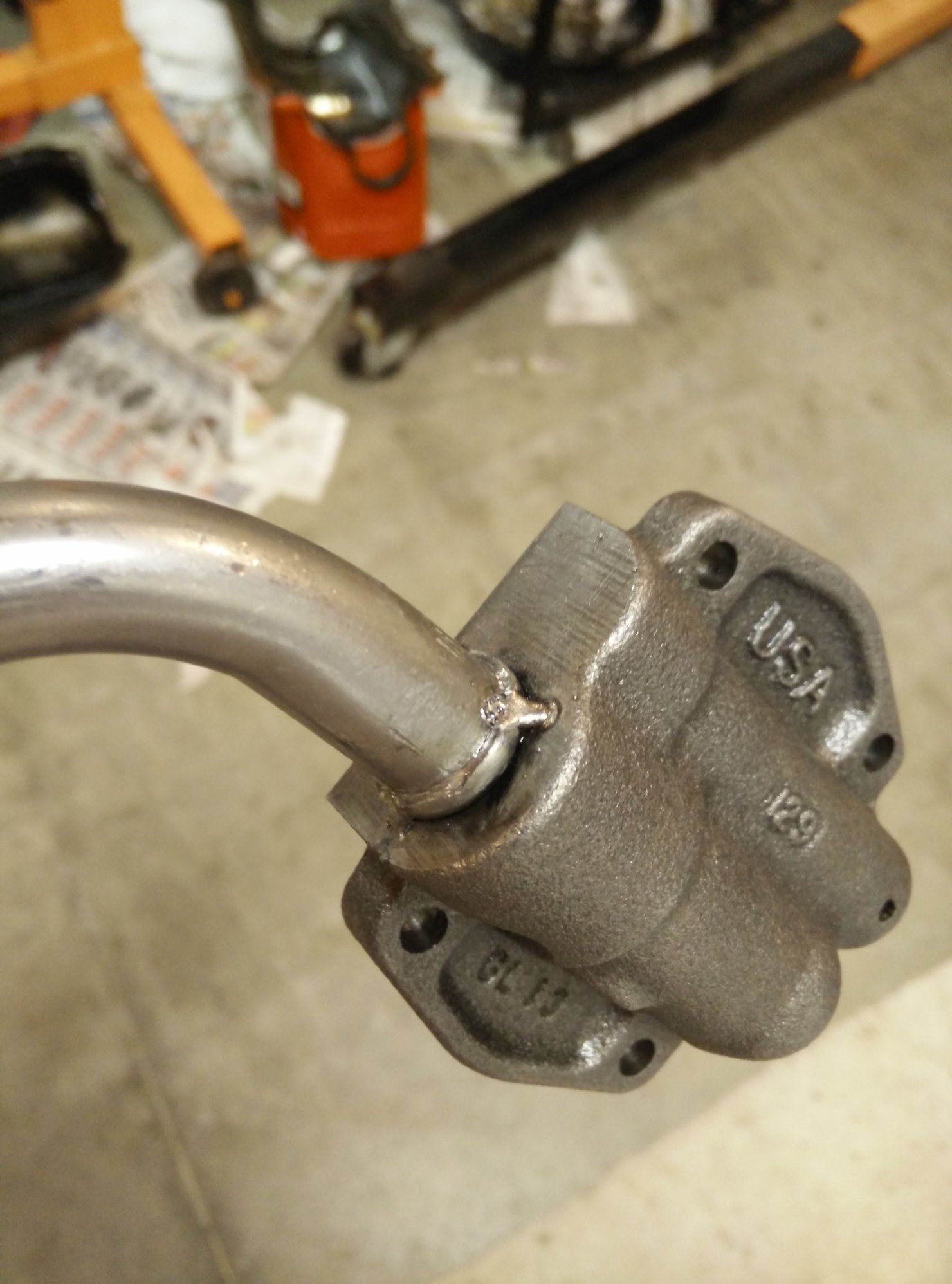

My pickup height setting method using a stock pickup:
With a straight edge across the oil pan rails measure the sump depth, add 1/8" to that measurement for gasket thickness.
Straight edge across the oil pickup metal baffle measure down to the block pan rail.
1/4" clearance = good to go.
That sounds like a good way to do it. Thanks.

Mig should work test & set the welder using your old pump.
I use tig & stainless rod.
Remove the pressure spring & by-pass valve, clean/dry the pump = no oil residue.

I've brazed in pickups, and it works very well but it does transfer a lot of heat into the pump housing requiring the spring to be removed...easy on a big block oil pump, not so easy on a small block oil pump....so I tack weld with the good old stick welder, very small 7018 rod, D.C reverse polarity, low amperage, a couple of tacks, viola, the pickups secure and there's very little transfer of heat into the pump body = no need to remove and replace spring

Ah, testing on the old pump is a great idea. Thanks!
Sadly I don't have access to a TIG welder, and even if I did I couldn't use it.
I'll probably run by my friend's house and weld it today. I'm thinking two or three 1/4" to 1/8" tacks should do?

If you have pressed in the pickup tube into the pump, a single tack should do it. The less heat you generate the better.

Just got back from welding it. I pulled the pin, spring, and piston beforehand just to be safe. I did three tacks (didn't read your post until just now) but the housing did not warm up appreciably. Maybe 5 seconds of welding total. Oh, if anyone is curious, I used a voltage setting of 4 (don't know what that corresponds to in volts, sorry, but I'm hoping this is a standardized scale for MIG welders) and a wire feed rate of 50 (sorry, again I don't know what that is in real-world measurements).
Time to add "master welder" to my resume!
Okay, so maybe not, but it'll work. Plus it'll be cool to have an oil pickup in my car that I welded on myself

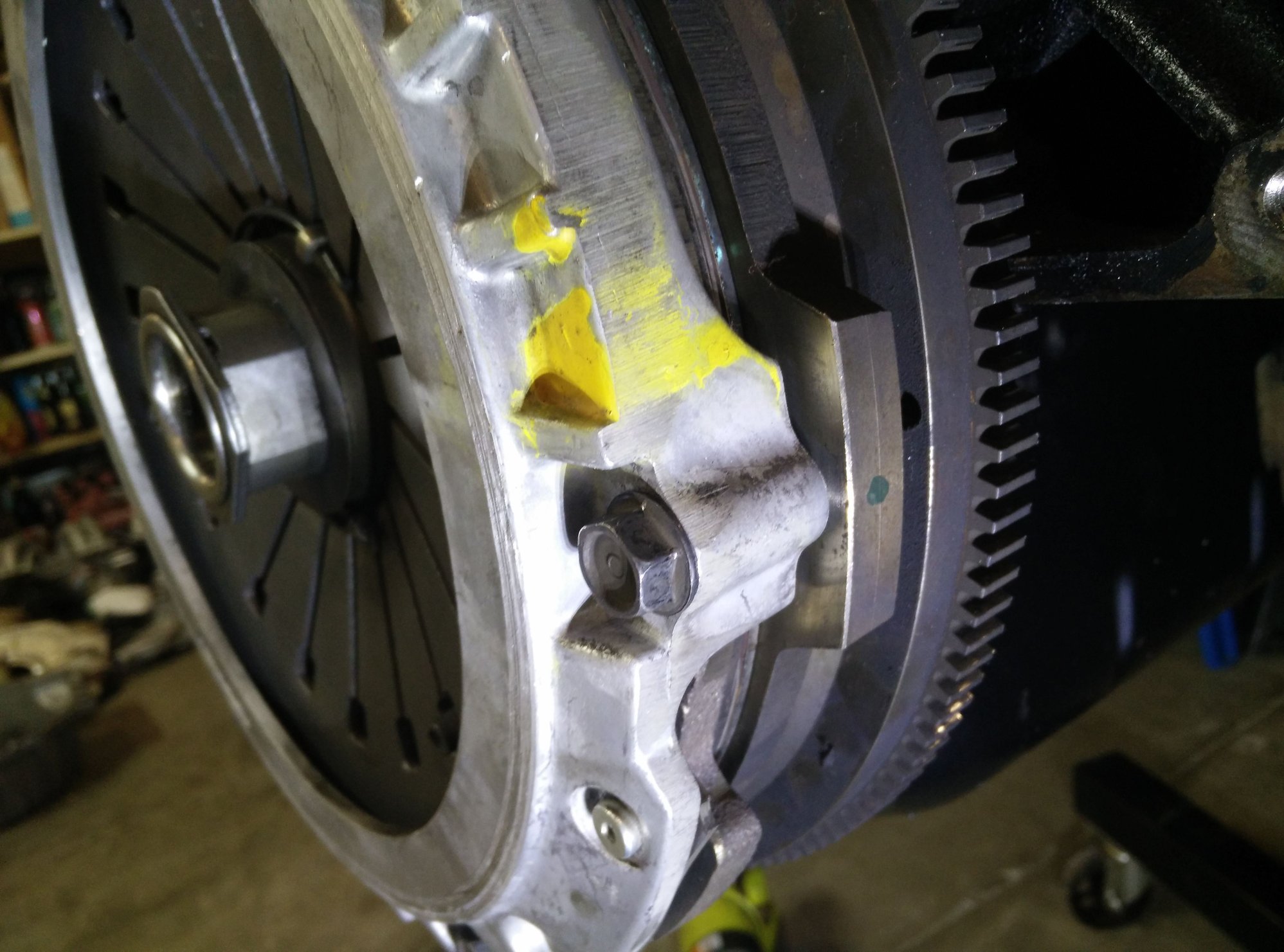

Made some more progress tonight. Got the engine on the hoist, installed the pilot bushing and flywheel, and was going to install the clutch as well but O'Reillys sold my dad the wrong alignment tool. I also pulled the plug on my ZF6 to drain the oil (I took out the fill plug first). I'll let it drip overnight then probably refill it (with AMSOIL) tomorrow evening.
Oh, and I put a light coat of moly graphite lube in the groove on the throwout bearing. Sounds like that's recommended?
Edit:
The FSM says, "Make sure that the reference marks on the clutch cover assembly and flywheel are aligned so as to maintain proper balance." I see a dot of green paint on the edge of the flywheel and a splotch of yellow paint on the clutch cover assembly, each near one particular bolt hole. I'm assuming those are the reference marks? Here's a picture:
Sorry for the endless questions. I just don't want to have to drop the transmission or pull the engine again to fix a mistake I make now.
