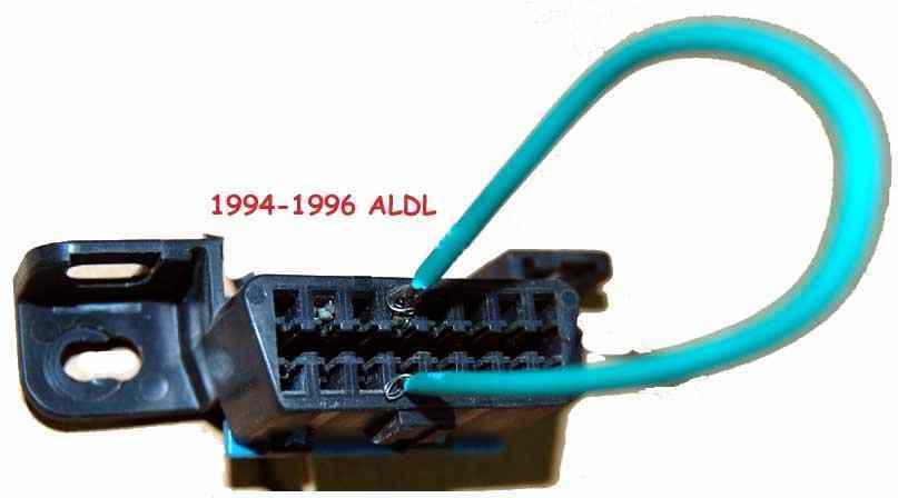

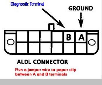

Both good choices. Your dash will display codes. When shorted

The A-B shorting method doesn't work on 1994-1995. I'm not 100% certain, but it looks like the two scanners you mention are OBD2, which don't work on 1995 and older. Actron makes a high end scanner that does GM-OBD1 and OBD2. The most popular options for 1995 and older are the USB cables to laptops or the new ALDL Bluetooth adapters.
yes, thank you, I do know this.. i thought the OP had 92 -93
94 -95
You can short like this.
Yes All 3 scan tools listed are OBD2 Only
