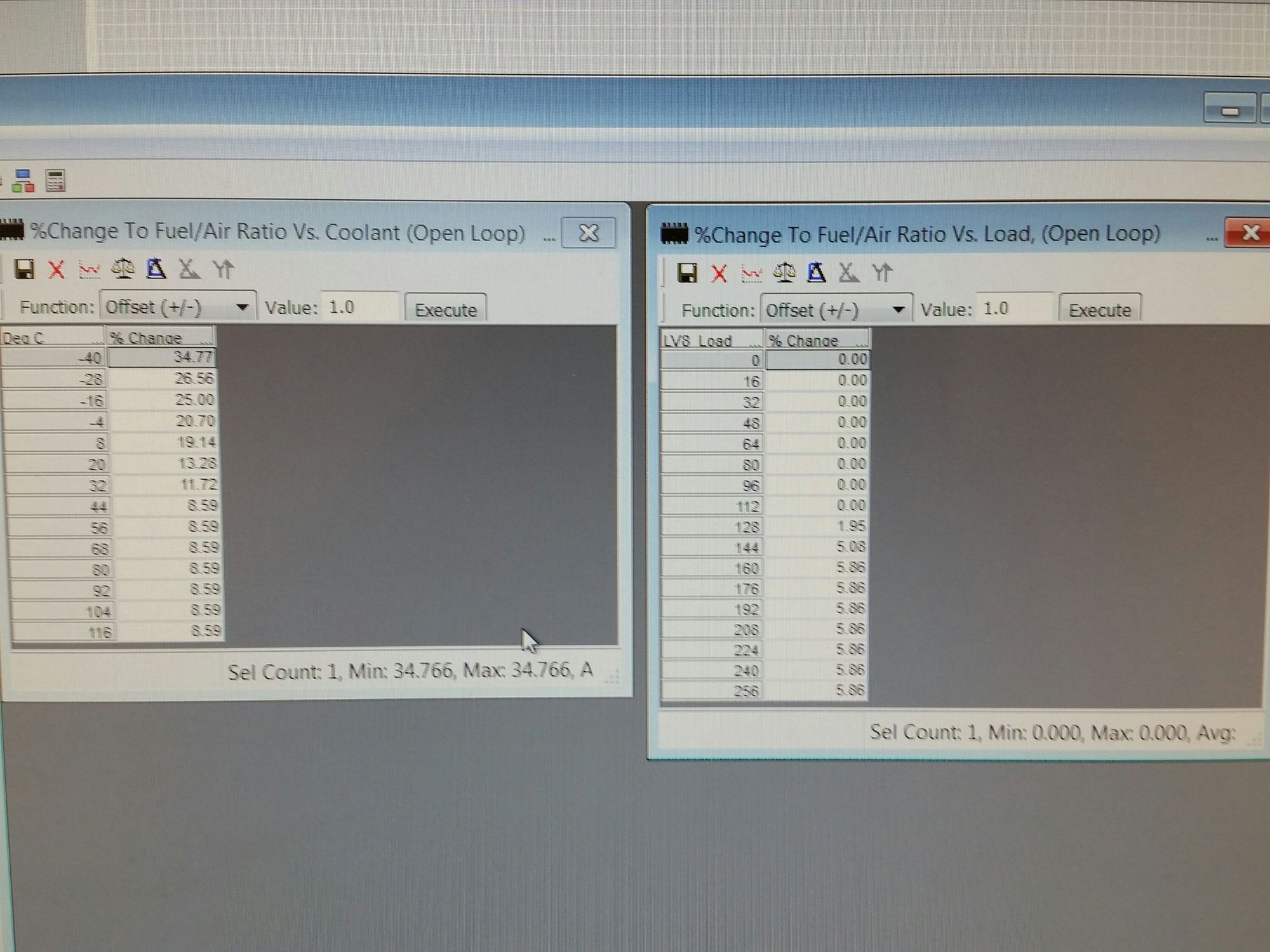

Take a look at the two tables I attached, one adjusts the amount of extra fuel added in open look based on temperature only and the other adjusts it by load. Find out what your temperature and load are in the problem area and tweak those areas.

How do I find out what my load is?

Use a scanner, it will give the load number. Assume decel is 16 to 32 load, idle could be 32 to 80 but your best way to know is use the scanner.

And on Tuner Pro RT, there is a thing called "Load Variable". This is what I assume I need to look a for this situation? Problem is, it's fixed at 59 no matter if the MAF, Engine Speed, Vehicle speed, or TPS changes. It's always at 59.

Use a different scanner to get load values. I believe my Autoxray shows them or the scanner in tunerpro.
I have attached the tunerpro tables, thay are named the same as in cats.
