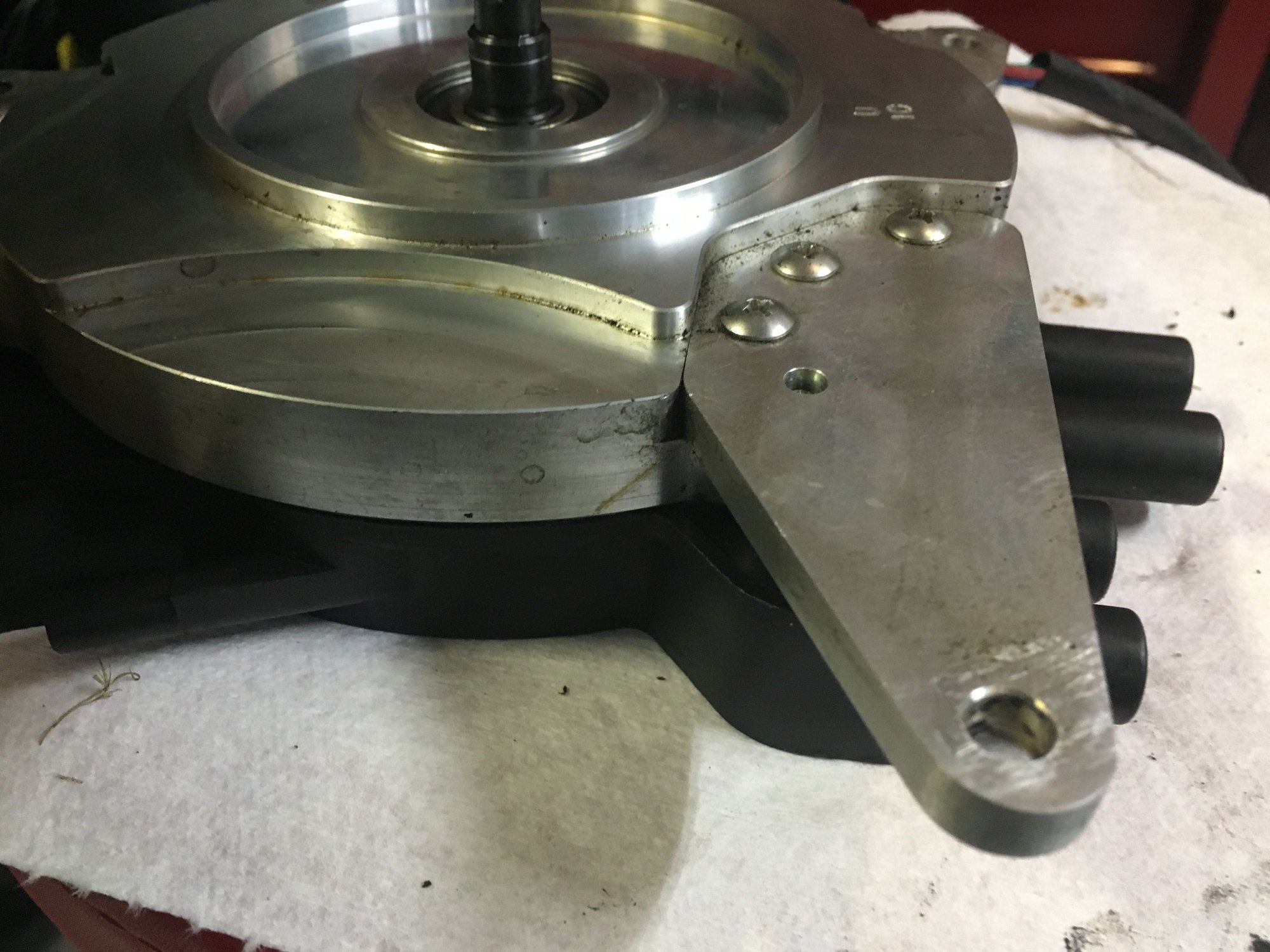

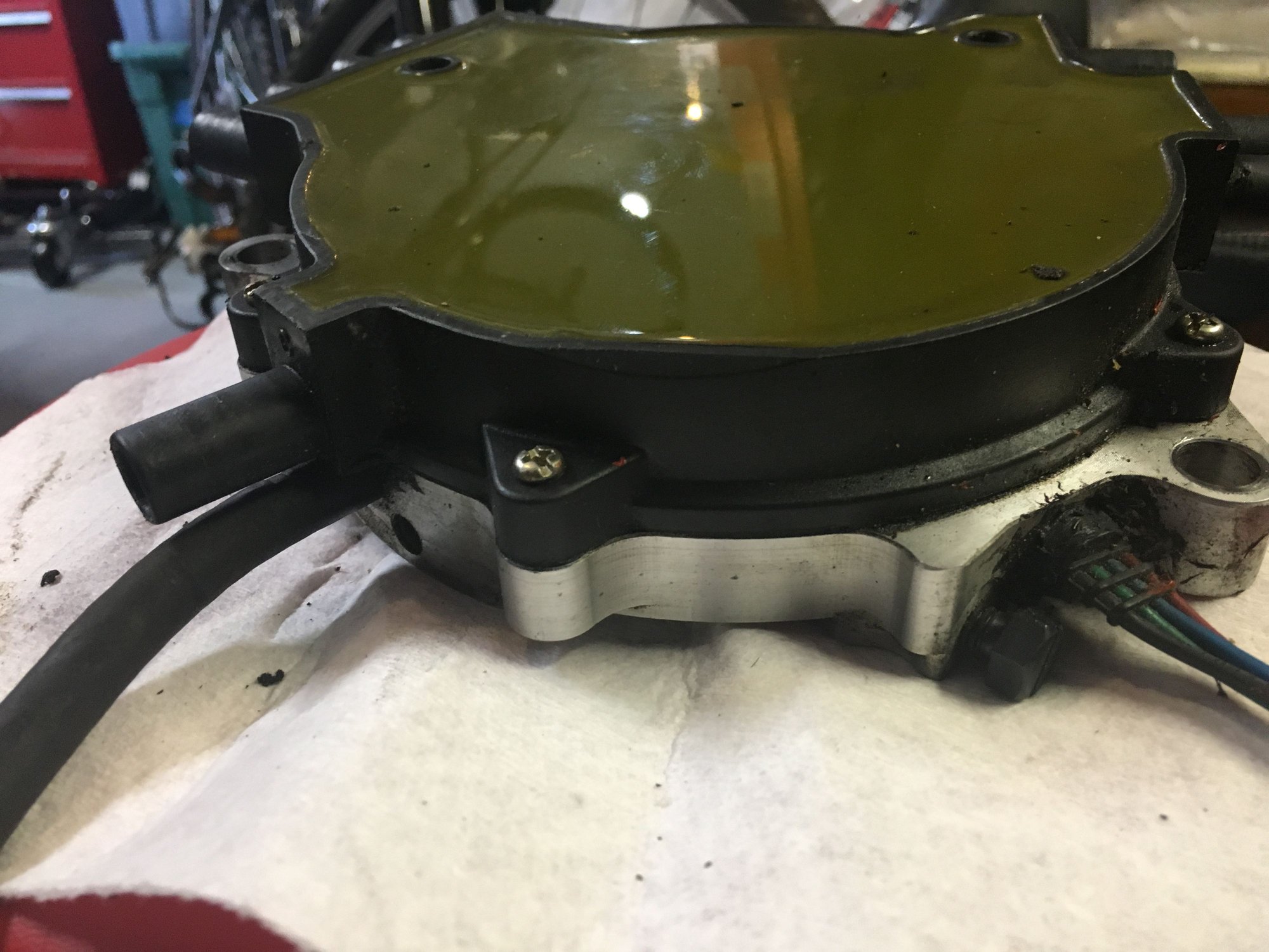

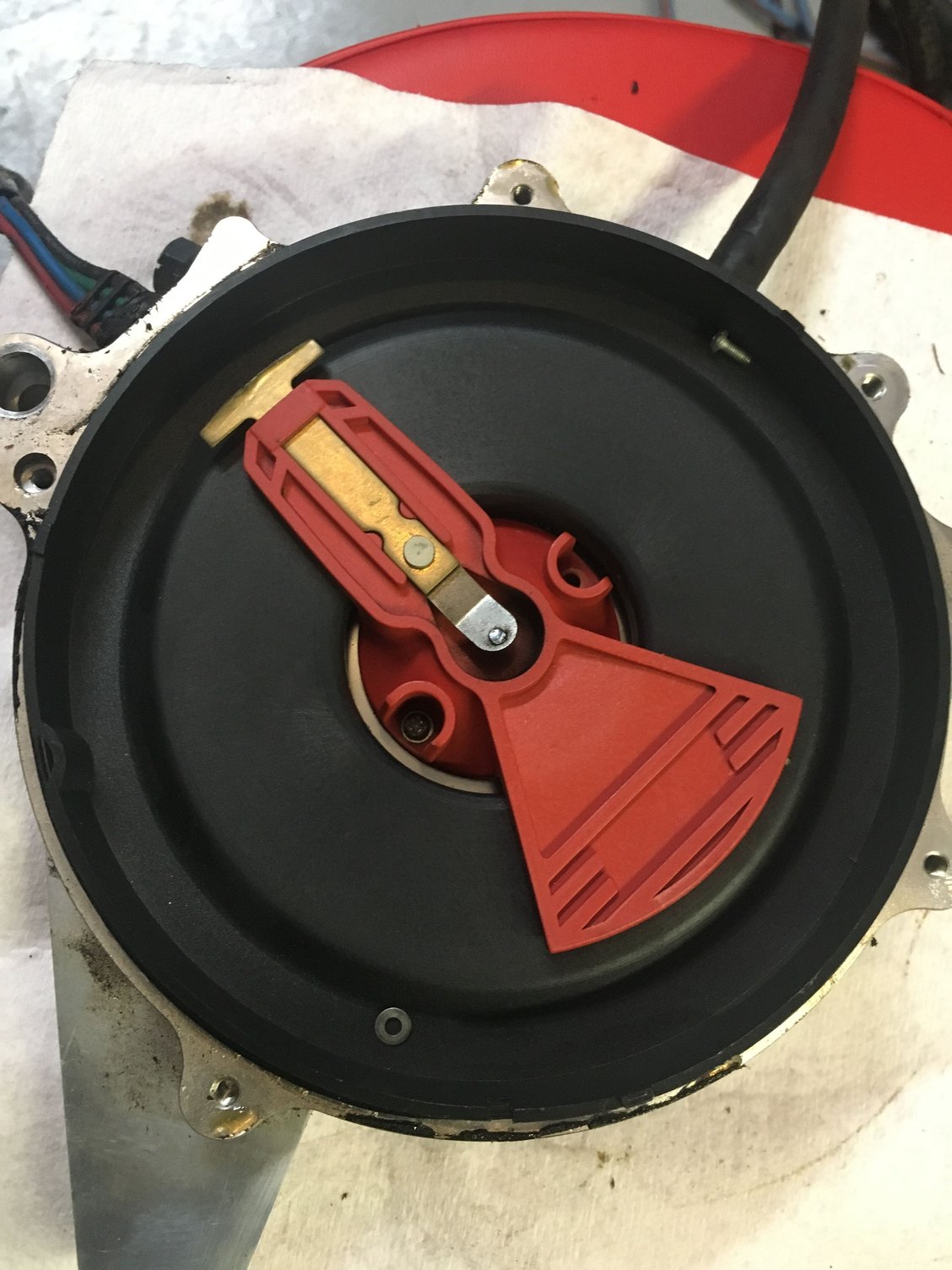

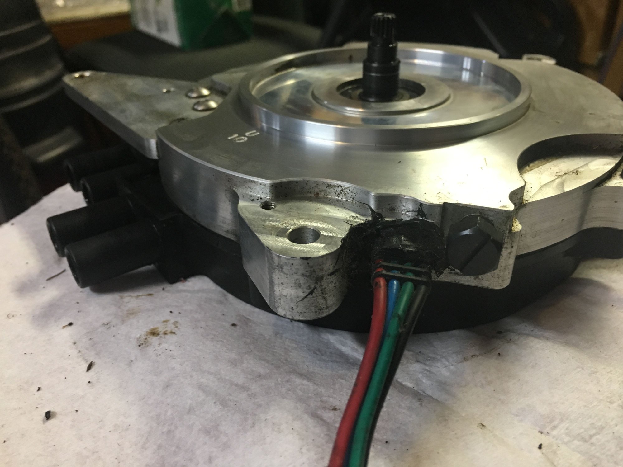

For quite a while I though the opti looked weird. There was a vacuum line coming out of the top and the metal base looked way to thick. The vacuum line went to nowhere, just wrapped around the drivers side valve cover and ended. When I pulled the old Opti out and compared it to the new one...well, it is weird. I would appreciate if someone could tell me what I have. I did find some problems inside the Opti, one of the rotor bolts was out and it and its washer were rattling around, noticed that as I pulled it out. The second rotor bold was only in by one or two threads. Under the cover, there was oil in the pickup area and on the disk. Not much, and not dirty, and I am not sure where it came from. It does not look like it came from the shaft or anywhere else. It almost looks like it came in through the vent line. Here are some pictures, I would appreciate if someone could tell me more about this old Opti.
Outside shows the thickness and the vent line...as well as the shoddy wiring gromet.
Wiring and thickness

Vent and wiring
Loose screw and washer, other screw was almost out
Oil in disk area

Doing some additional research, this is definitely an MDS Opti...even that mess of wiring is OEM for that one. It does have an aftermarket cap and rotor...which was the source of my problems. I am replacing it with Petris vented, I hope it lasts a long time!
