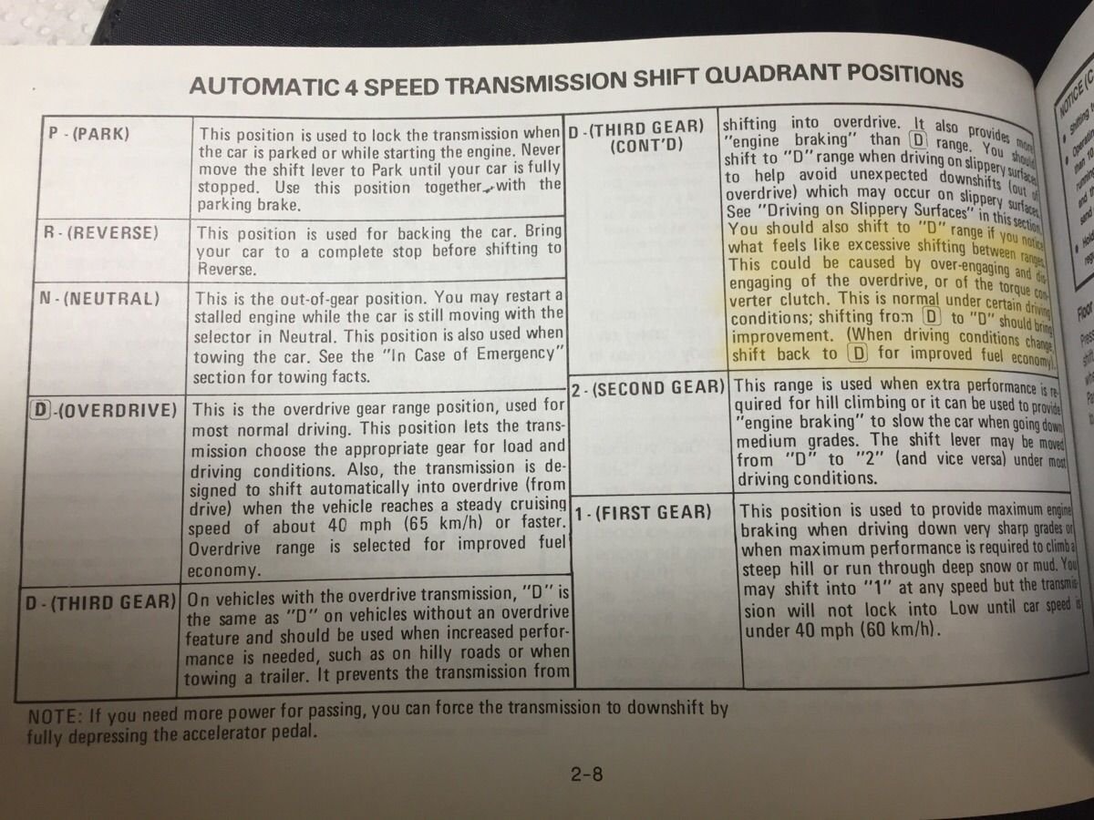

Are you trying to drive around town in overdrive?
Why wouldn't he? Millions of people do it every day.

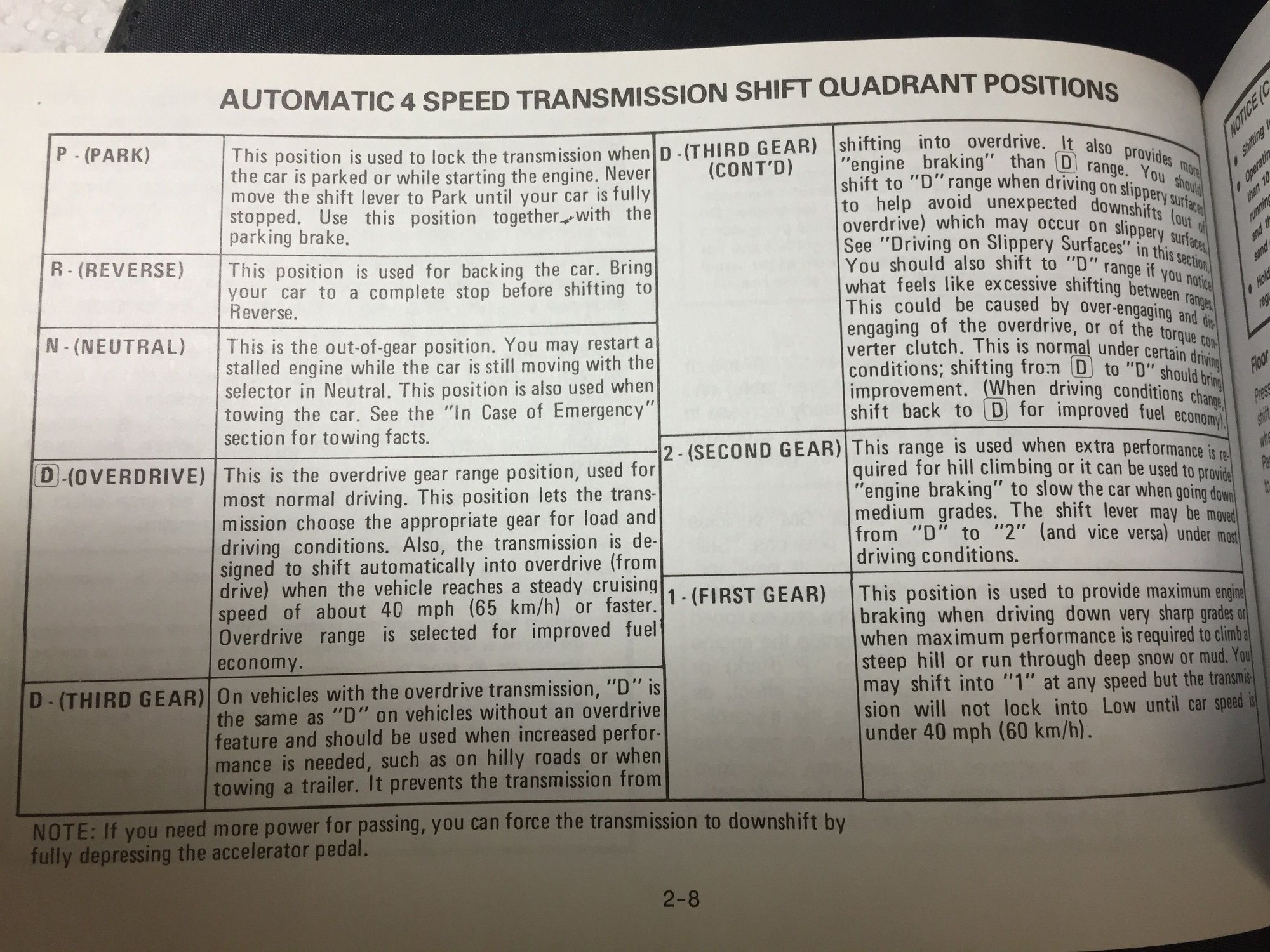

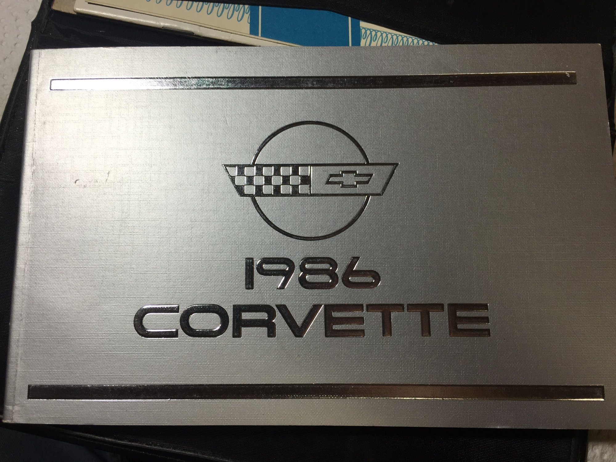

But millions of people don't do it in 1986 corvettes.
Oooooh! Now I understand the difference. It's an 86 Corvette. Sorry.
Its in the manual.
Its in the manual.
That says nothing about what the OP is experiencing. Your first post eluded to the fact that if you are "driving around town" you should be, by default, in the D range. Your manual clearly states "under certain driving conditions". Not the same.
what gear do you use, LOL

Dt86's Avatar
Dt86
Joined: Jan 2014
Posts: 4,017
Likes: 492
From: Poughkeepsie New York
Actualy yes. But whatever. Have a nice day.
