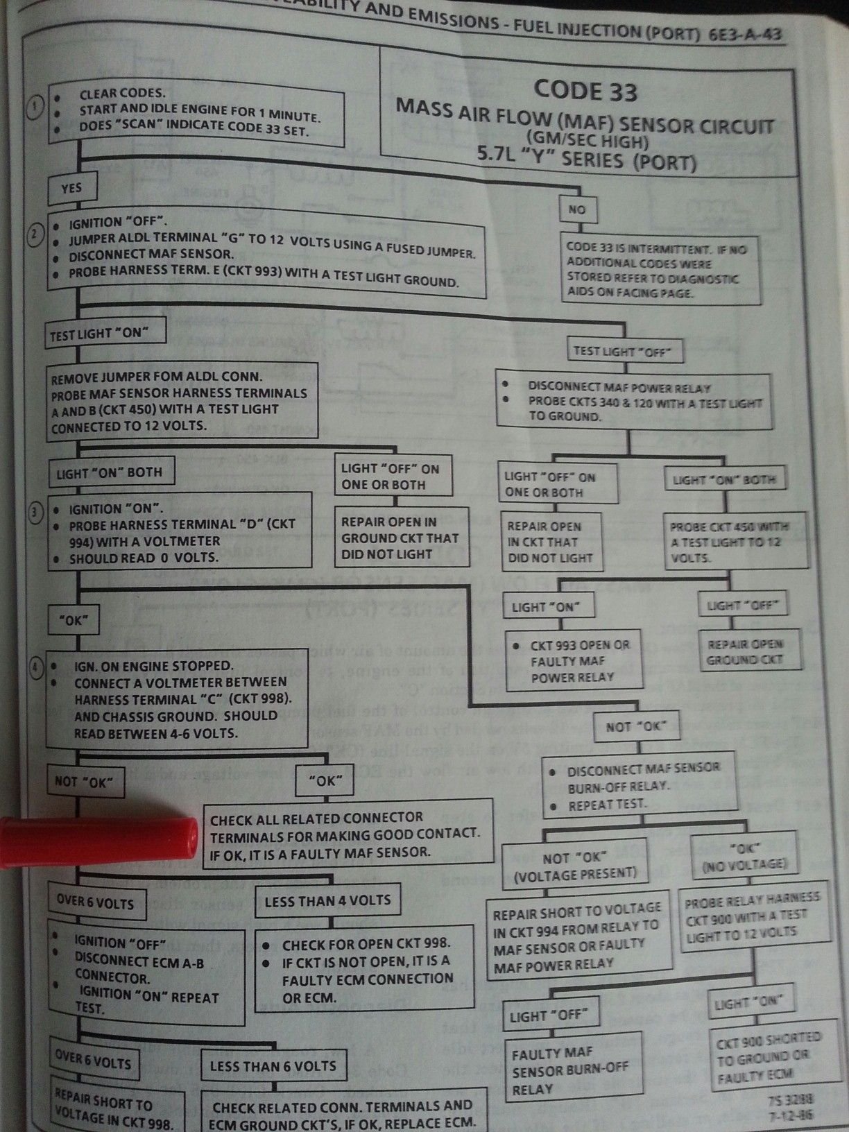

I went through the FSM procedure line by line and it points to a bad MAF sensor (see red pen in picture). All of the steps leading up to that point went as indicated in the chart. I had to order a MAF (Duralast) - my question is this: Has anyone simply replaced the MAF and have it solve your problem? After reviewing many posts with similar issues, most include 'replaced the MAF' and the problems still return.
The part will be in on Tuesday - I'll update with the result. I'm not 100% convinced, but maybe the combination of new relays, clean grounds and finally a new MAF will do the trick.

On my 87 I have had MAF codes 2 times. Both times, I replaced both relays and fixed it. Never replaced the MAF sensor.

You are much more likely to have a bad connection (loose or corroded connector pins) or wiring problem than a bad MAF.
An ALDL cable and appropriate software are the only way to find out what is truly going on.

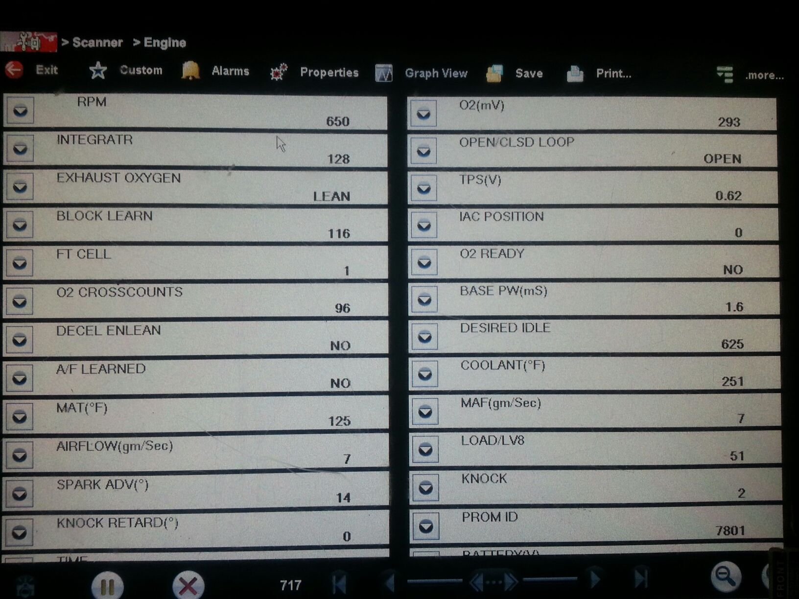

I was able to borrow a Snap On Verus scanner tonight and I captured the following information. This is at idle (the idle varies from 1300 down to 600 - it happened to catch it at 1000. One thing I noticed is the temperature per the scanner is much higher than the dash digital gauge. Dash read 220 - scanner read 251.
I'm going to investigate these scanner numbers, but if anything jumps out to anyone please let me know

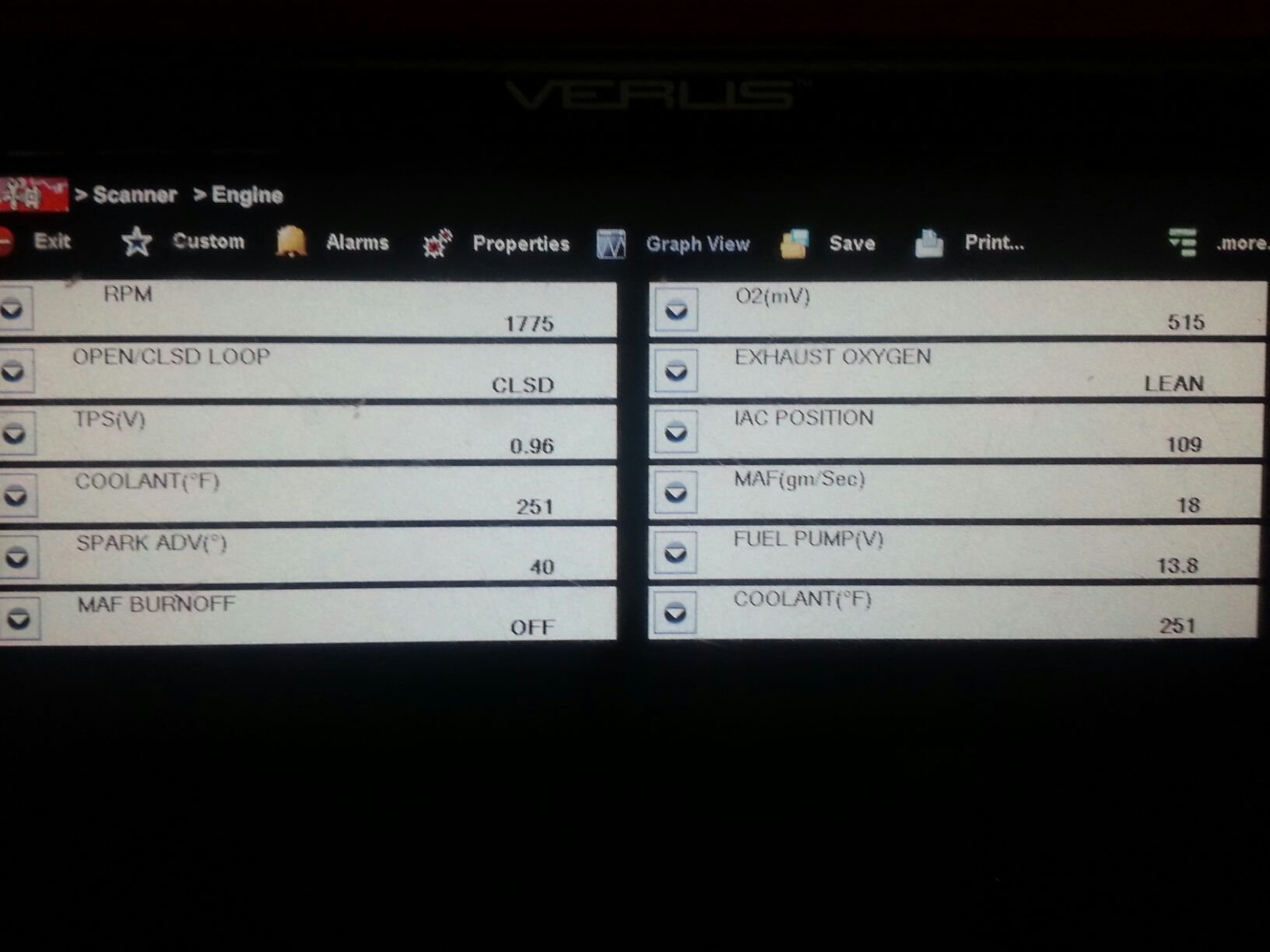

I held the gas to get the idle up around 1800 for this scan:
My Code 33 did not pop. I couldn't drive the car with the scanner connected - it kept losing the signal for some reason.
Could the coolant temp sensor be sending bad signals perhaps?
Not sure this shed any new light. I only had access to the scanner briefly.

It looks like the coolant temperature input has a problem. The IAC counts seem high. Have you done a minimum idle adjustment:

Another good call - Thanks
I went through the minimum idle steps and here are some new scans. The idle now sits nicely around 650-700 and the exhaust smells much better. I took the car for a ride (this was all done at 1am last night) and when my dash temp gauge hit 180 it went to limp mode and code 33 came back. The scanner is reading 250+ degrees. The car is not overheating.
Here's the scan with the newly adjusted base idle:
Here's a steady rev scan after base idle:
The scanner led me to fix one problem and I will do some digging on the coolant temp sensor today.
