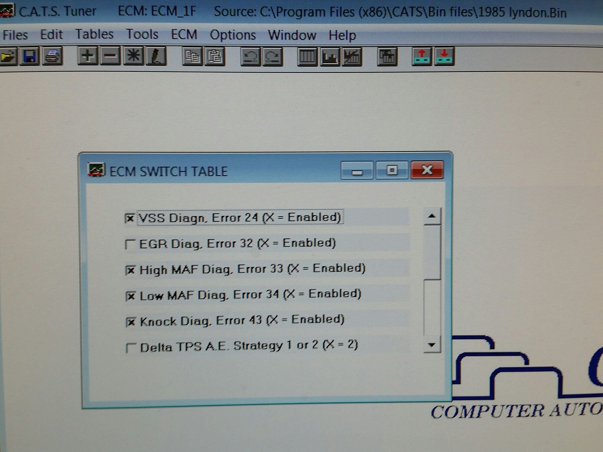

I guess my next upgrade is sending my ecm out. I'll probably wait till winter comes and i'm not gonna drive it anymore and maybe run 87 octane and see if it has no code.
Old Aug 10, 2015 | 11:37 PM
Morpheus53's Avatar
Morpheus53
Cruising
Posts: 10
Default 87 octane
Originally Posted by bjankuski
Don't run low octane just to do it, first check to make sure your base timing is set at 6 degrees and then see what happens. My 1986 all stock vette with cast iron heads pinged with 87 octane fuel in it at WOT, the 1985 should be very similar. When I ran 93 octane fuel the pinging would stop but I could still see retard with my scanner.
lol now I gotta drain the fuel tank. ran 87 and got a good test drive on it. ran so so so bad. sputtering. the check engine light also came on at 1000 rpm on WOT. so I think it's sensing knock. think i'm just gonna run high octane and try to get my computer worked on this winter. think it's gonna need new cam because I had to tighten down my lifters quite a bit when I re adjusted them. that's why the knock is the at high rpm. just might try a new engine. cam and heads for the l98 are more expensive than a built engine.
