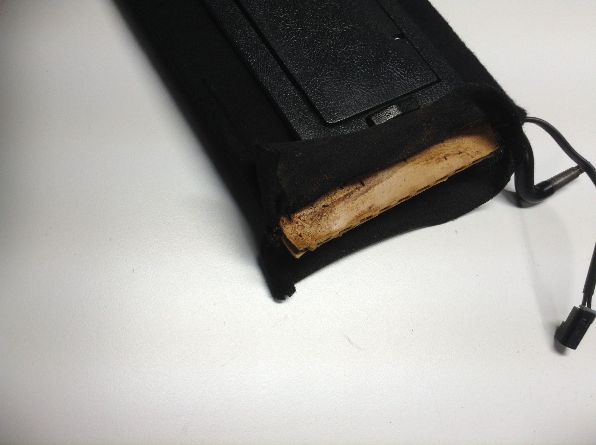

I got sick of the floppy ears on mine, and ordered a set of reproduction visors from one of the major vendors. They were back-ordered, and I had to wait a very long time for them to arrive. After I installed them, I realized just how poor the quality was -- numerous faults -- and returned them for a refund.
In frustration, I decided to see what I could do with the old ones. I cut the stitching off at the end of each one, removed the broken cardboard, cut the cloth covers down to where I had about 3/4-inch extending beyond what was left of the cardboard, tucked the cloth between the cardboard layers, and hand-stitched them back up with black thread.
First incision:

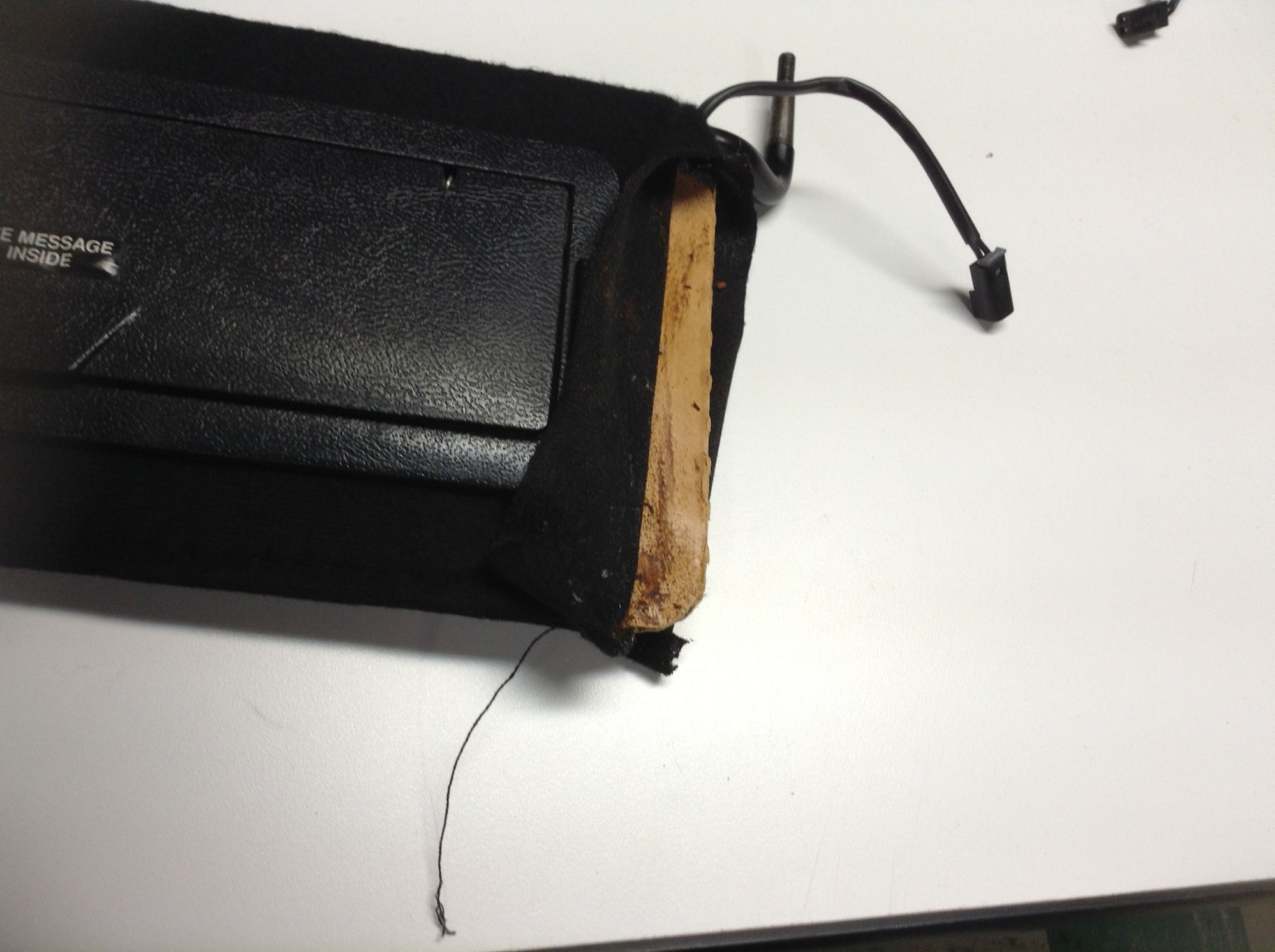

Surgical removal of floppy ear:

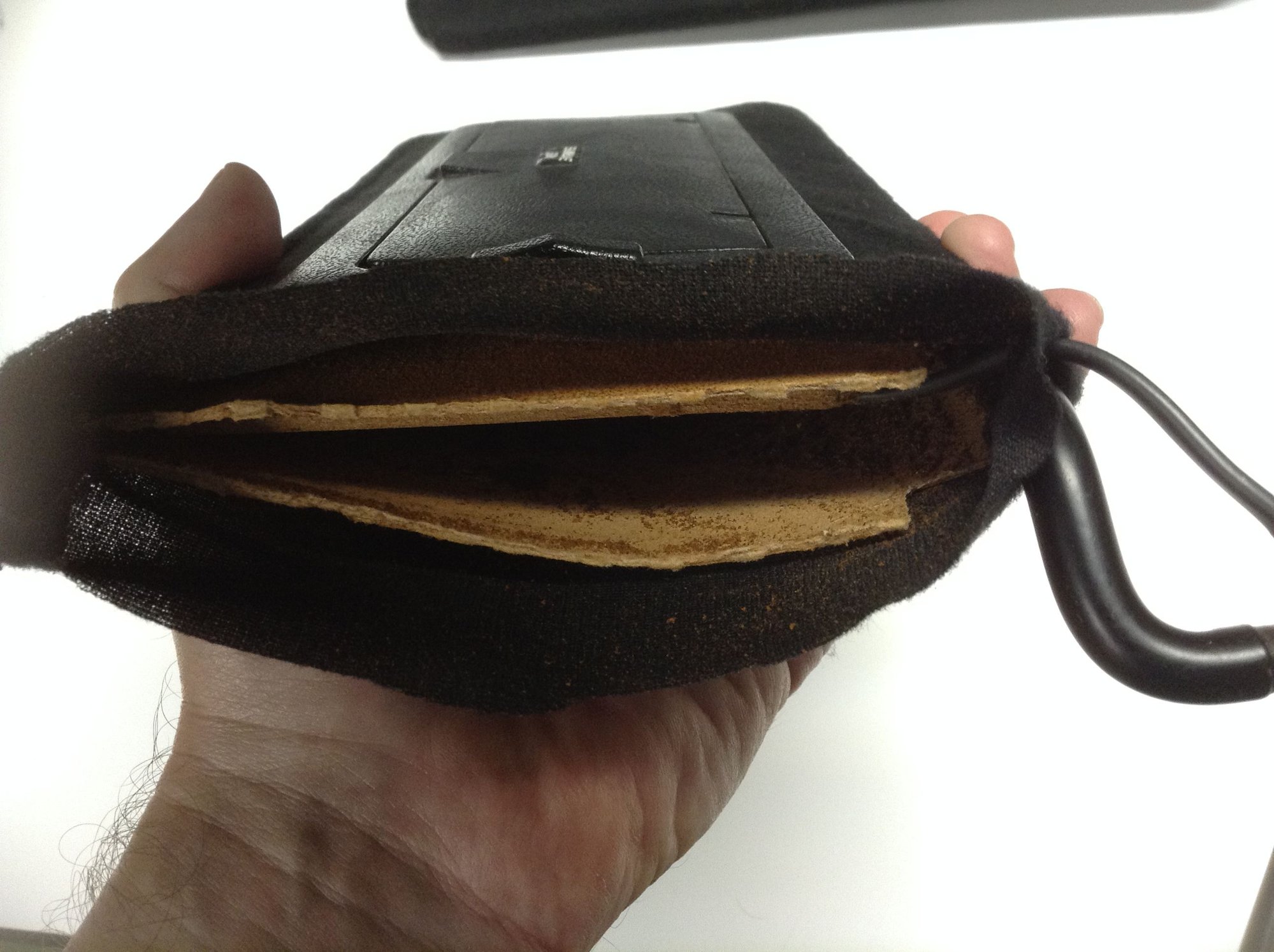

A peek at the inside of what's left:
Squeeze to separate the two layers of cardboard:

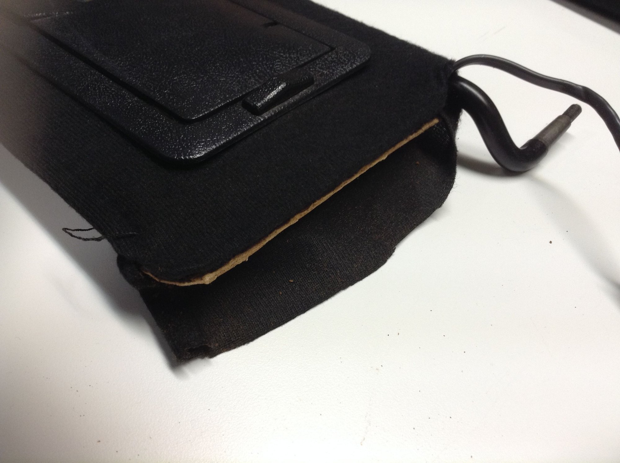

Edge of remaining cardboard:
Scissor-cut new radius at corner (should have cut a larger radius):

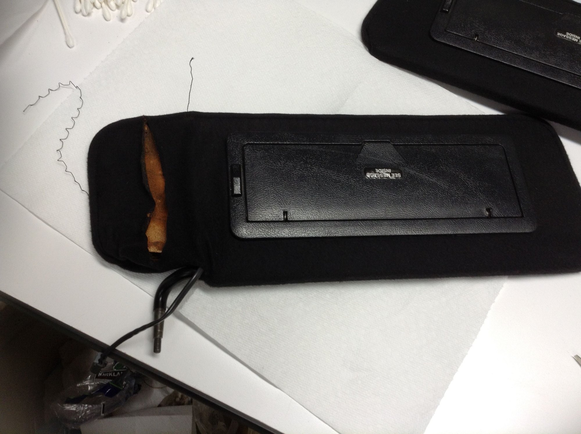

Top layer of cloth tucked in between two layers of cardboard:
Clamps holding things together while I'm stitching it back up:

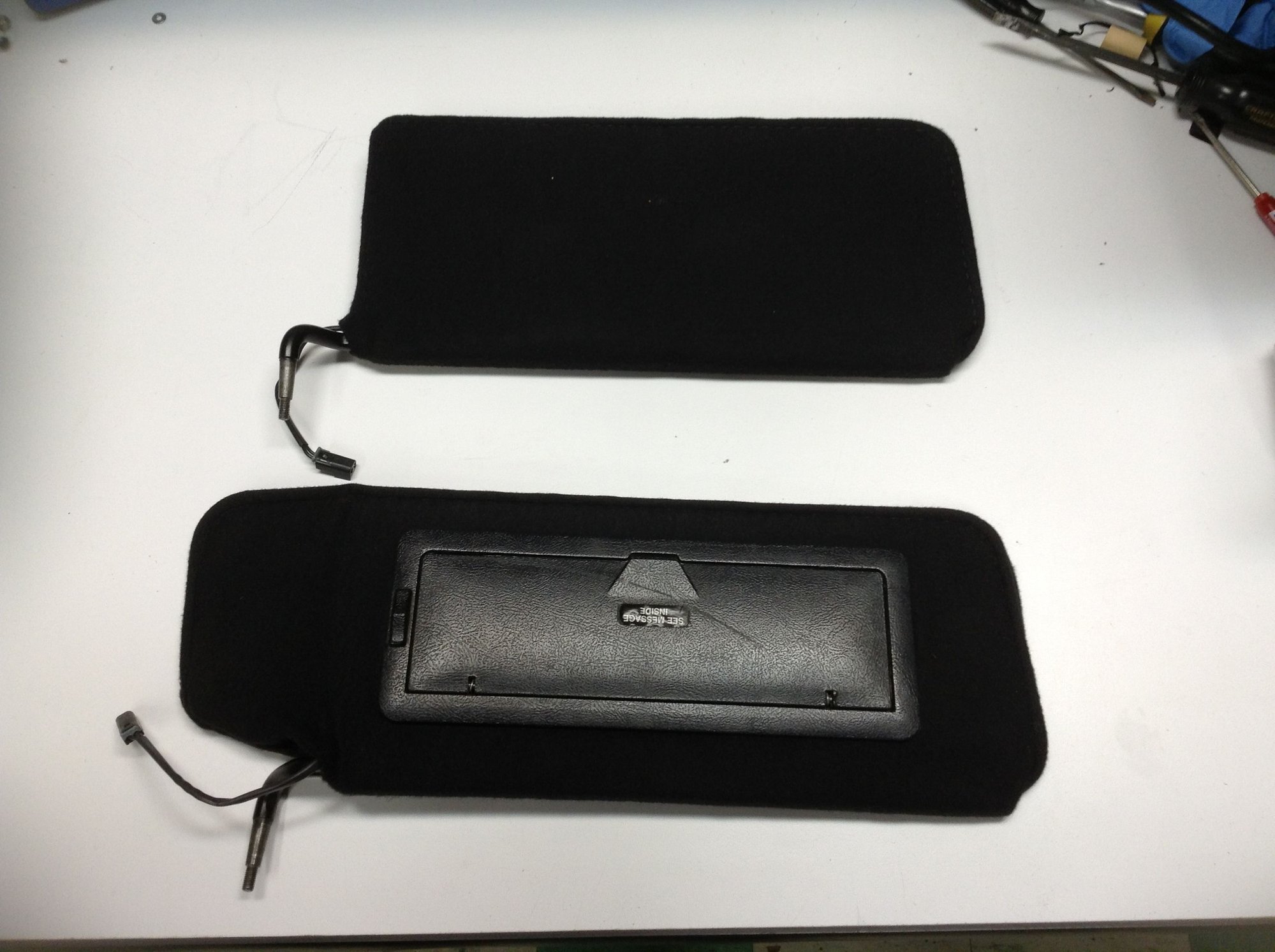

First one finished, second one waiting to be done:
It's not perfect, but it looks SO much better than it did, and I'm okay with it for a while, at least. It wasn't difficult, just required some time and patience.
