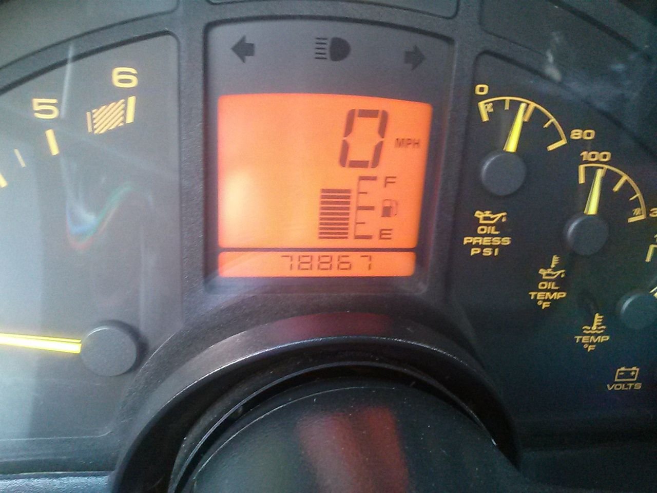

Ok, thanks a lot guys. Mark, I'm in Dallas. But thanks for the offer! My car feels like it's not running on all 8. Ran perfect yesterday. Starts up weak on cold starts, sometimes it would stall. I pulled two plugs on driver side, one was oil fouled. Think it's due to bad valve stem seals. Very little amount of blue smoke on start up, I'm talking very little. Sometimes I hate this car And no, there is no SEL light
Gotta ask the question, how many miles on the LT-1?
To No code C12
