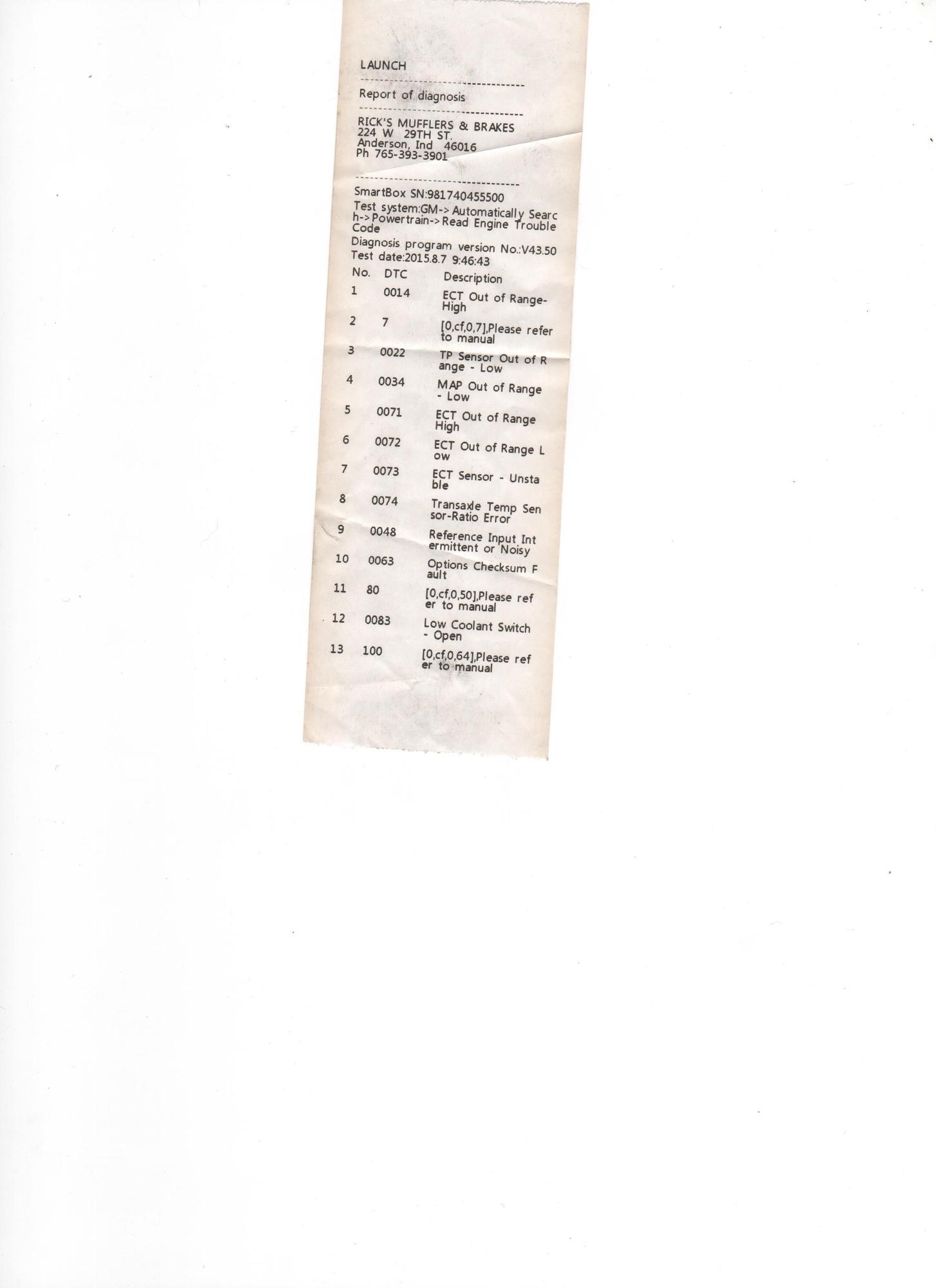

have a 1995 lt1 rough idle.had a shop read computer got this.
thanks for any help

Check the wiring. All that stuff didn't die at once. Those checksum errors are strange. Maybe a failing PCM?
You should always check the power and grounds to a PCM before declaring it bad.
