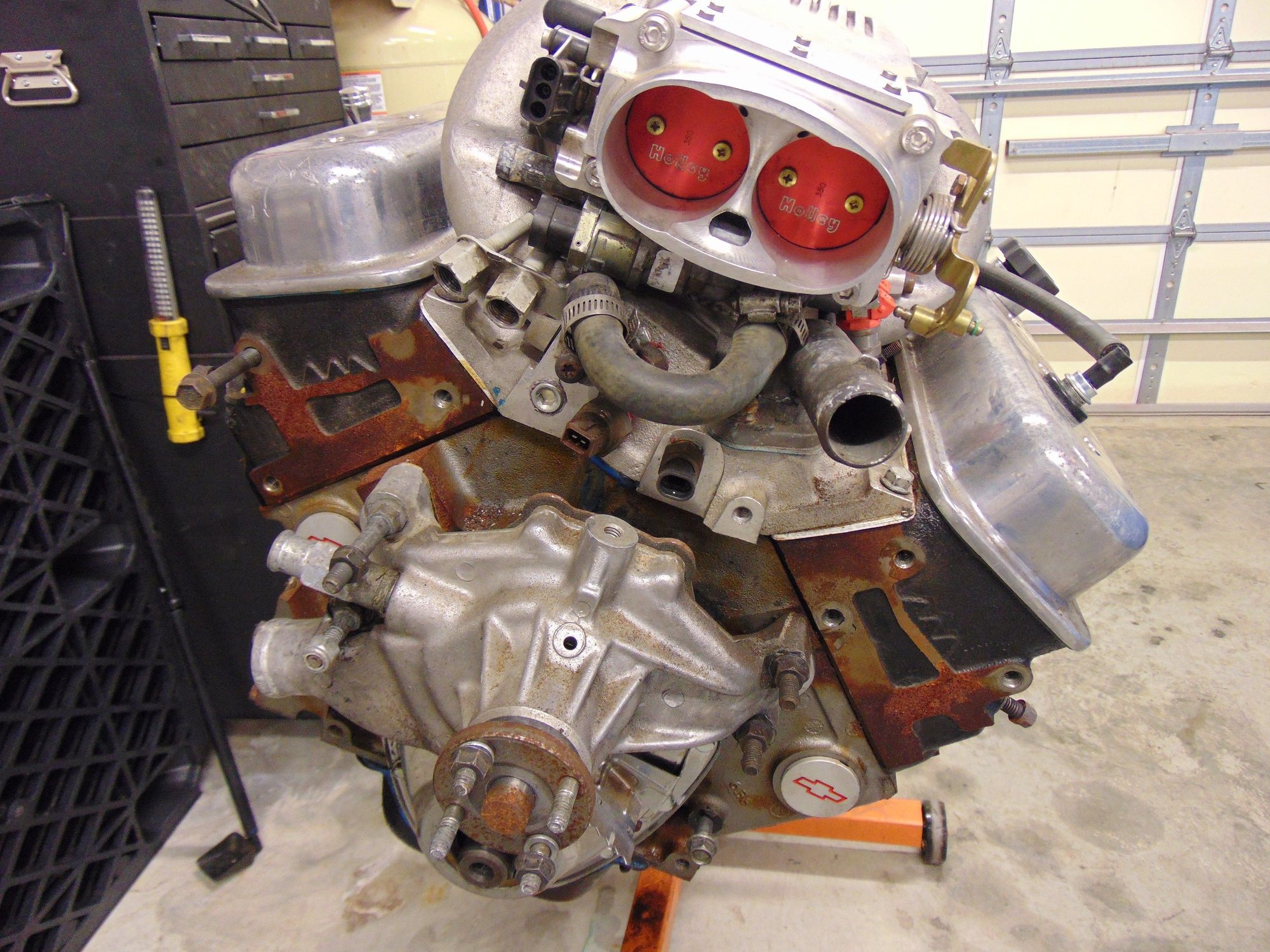

I bought an 88 vert with a crate motor that was poorly installed. They couldn't get it running right. I have pulled the engine and tranny. I have noticed a double gasket on the intake. Intake is an eldebrock and the heads are supposed to be vortec mounted on a 355 roller crate engine. Any idea why the double intake gasket?

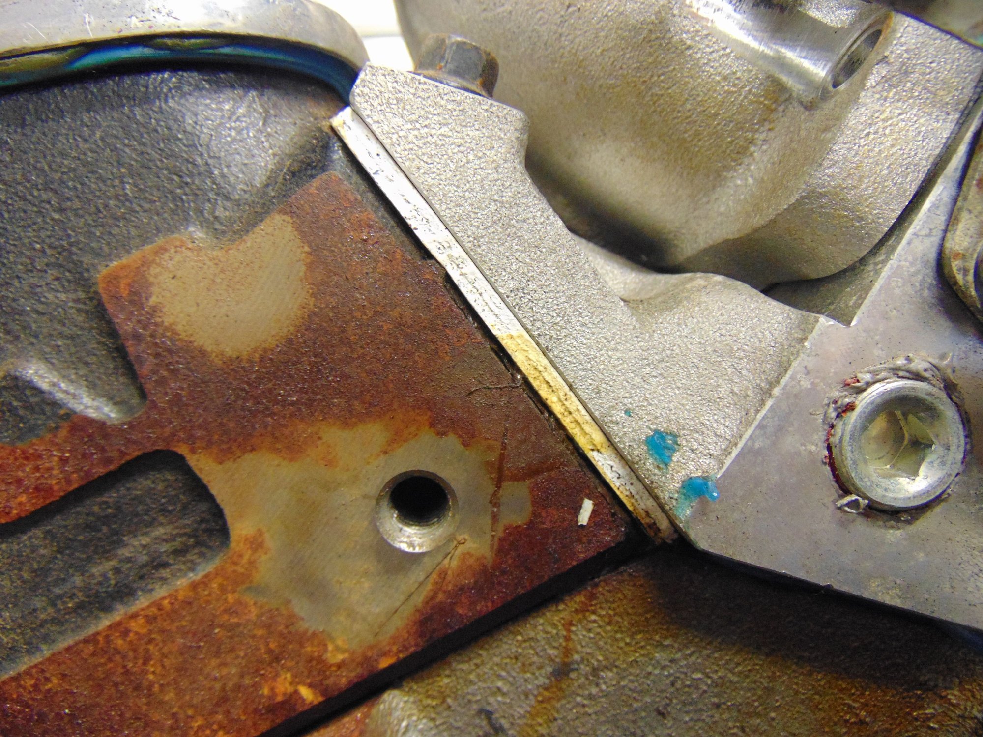

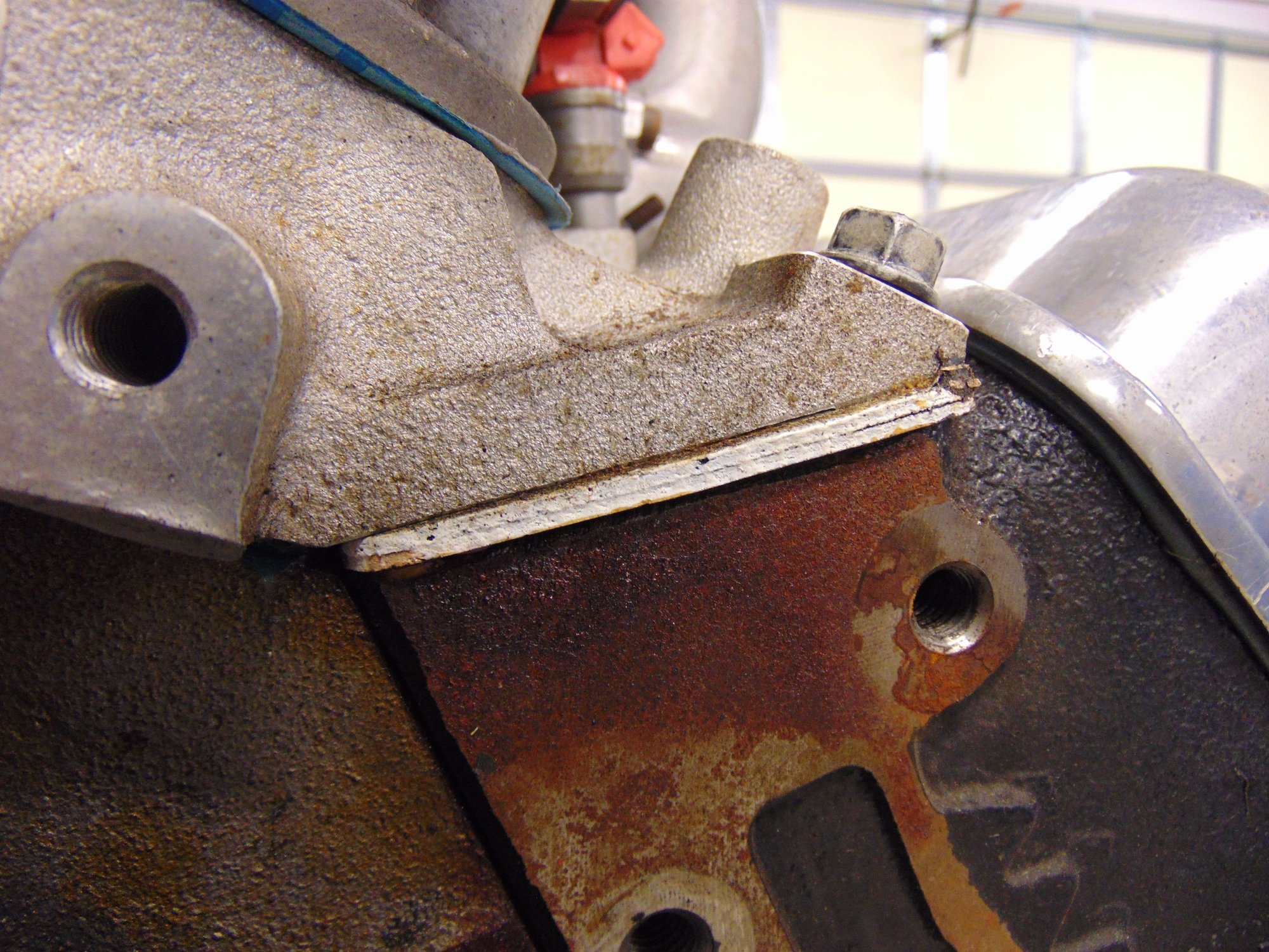

I'm guessing that base is a non-Vortec base. Since the Vortec intake ports are slightly higher than the non-vortec ports, you need to stack gaskets to raise the intake a bit, and get a seal. I've done it before when putting a CFI intake on a Vortec long block. Seems like hackery, but it worked just fine, in my case.

If the heads, block, or manifold were milled excessively in the past this will cause intake to sit too low and you need thicker gaskets. Usually the gasket thickness is .060 but they make .120 thick gaskets to help wit this problem.

I am not sure why the higher vortec ports are the problem, that is a vortec intake manifold (You can tell by the flat machined bolt mounting pads on the end and the straight up bolts) and it was designed for the vortec heads. I would be leaning towards either the intake mounting surfaces on the intake have been milled too much or the end rails above the china wall on the intake have not been milled at all.(And you have a milled block or heads) If the end rails have not been milled the intake will bottom out on the china wall (I cannot tell from the picture) and be held up away from the head, requiring a thicker gasket. If this happens the ports and bolt holes for the intake will not line up very well.

Ok so it was the intake then as added gaskets should only move the intake ports and bolt holes higher. Well isnt that the same thing as adding gaskets for aligning the intake ports? Well i guess not if your expecting to align just for an un-milled intake base. And an un-milled base should fit up to a un-milled block & heads. Well maybe for a vortec design base but not a standard GEN 0 base. In that case u need the gaskets to move the base ports (and maybe bolt holes) higher.
Something i think i can see from the pix is the heads - which look like vortecs - have a thick gasket rather than the usual thin (0.24"?) steel shim head gasket. Now this starts to make sense - at least to me. That motor could have vortec heads using a thicker composite gasket (over 0.040") raising the heads - which already have "raised" vortec ports. Now installing a GEN 0 TPI base with lower port locations means u need someway to raise the lower base ports. Ta Da extra intake gaskets! Well i bet the bolt holes on that intake are ground out and elongated too.

Just beware of the oil pressure slot in the distributor can be miss aligned when the intake has stacked gaskets.
