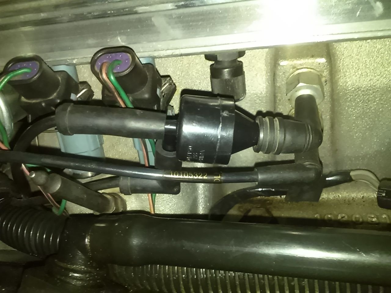

Coupling fixed, or 2 way check valve. Haven't seen what BLM's are now since fixing that. I have a weird thought. If the injectors are indeed to big, why is it only lean on the left bank?
