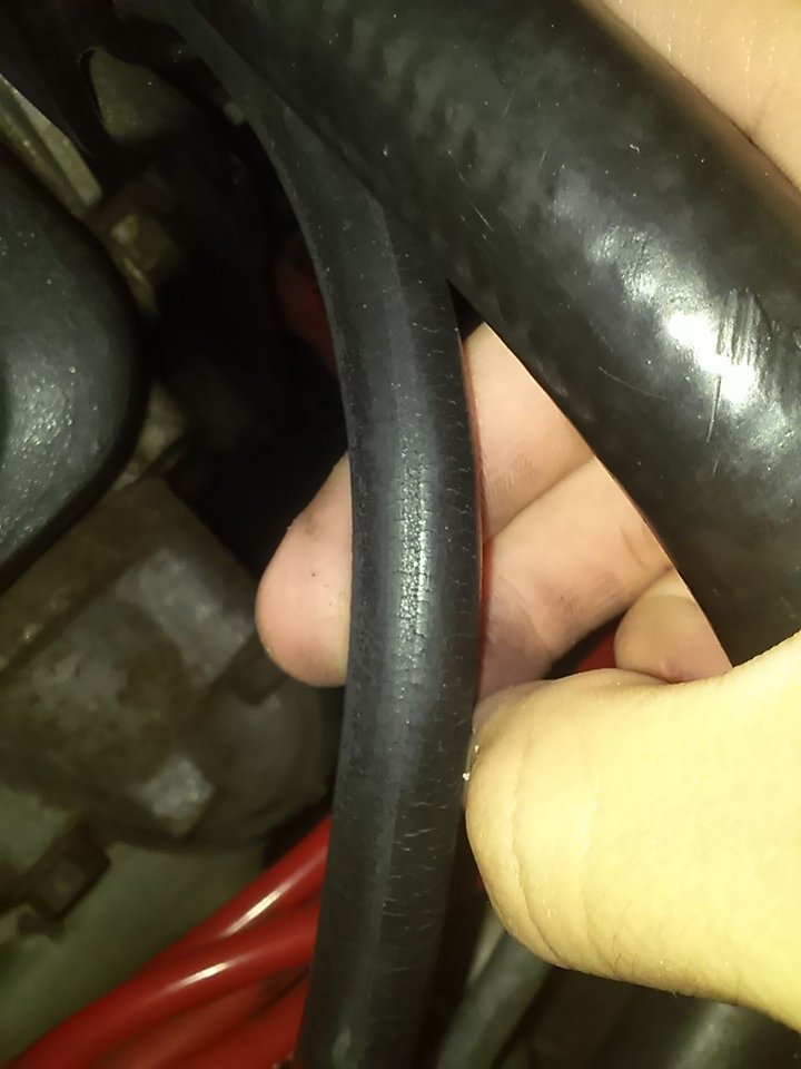

Would this vacuum line from the EVAP cause it to run lean? I wanted to double check for vacuum leaks, so I started the car. Engine cold. Starts up great, but bad idle. Like the video I posted, "LT1 running bad". This time, the car died on me. Scanned codes and none. Code C12, but that's normal.
Last pic is from the air filter. Would that cause un-metered air to come in?
Thing is, it's a 50/50 shot if the car will run fine when cold.

Honestly, it's hard to follow the thread since there are so many issues.
If it is running so lean from a vacuum leak somewhere that it stalls you would be getting a lean bank code.
Recently I went through a similar saga with my 93 running lean. You can read the details in the link below but it ended up being a combination of leaky header gaskets and a small vacuum leak which was only found by a smoke machine at a local shop. The tell tale sign of a vacuum leak is 0 IAC counts at idle. I'd suggest looking at those.
https://www.corvetteforum.com/forums...-attached.html
I also started getting an intermittent H41 during this time along with some other random serial data codes, until one day it turned into C41 and would barley run.
After tearing the dash apart and checking all the wiring between the ECM/CCM/EBTCM, it could only be the ECU. I broke down sent it to SIA electronics and they found solder issues on the circuit board. That ended up being the the problem.
What i'm saying here is it could be the beginning stages of a failing ECM, but you should investigate it in efficient, detailed manner. If not your going to drive yourself nuts and keep going in circles. READ that FSM it's full of valuable information you just have to find it.

IAC counts were at 0, replaced the 2 way check valve, and it's no longer at 0 Glad you found the problem! You are correct about finding the info in the FSM.

get a cheap cigar and blow smoke in the hose to the brake booster into the engine to find the leak. then put a cold pack on the ECM and try it.
