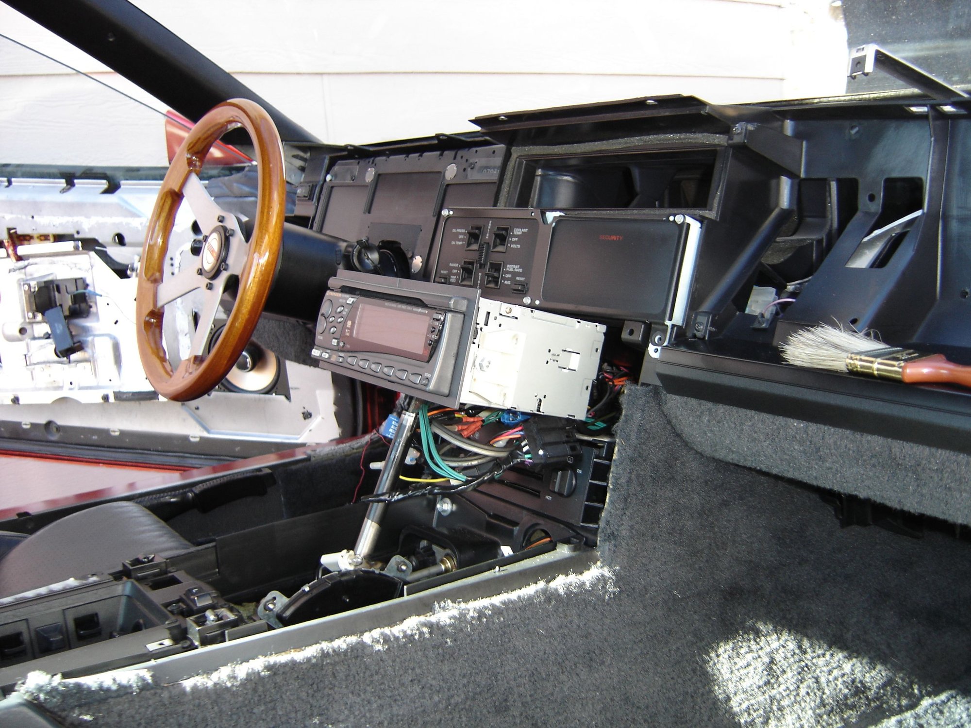

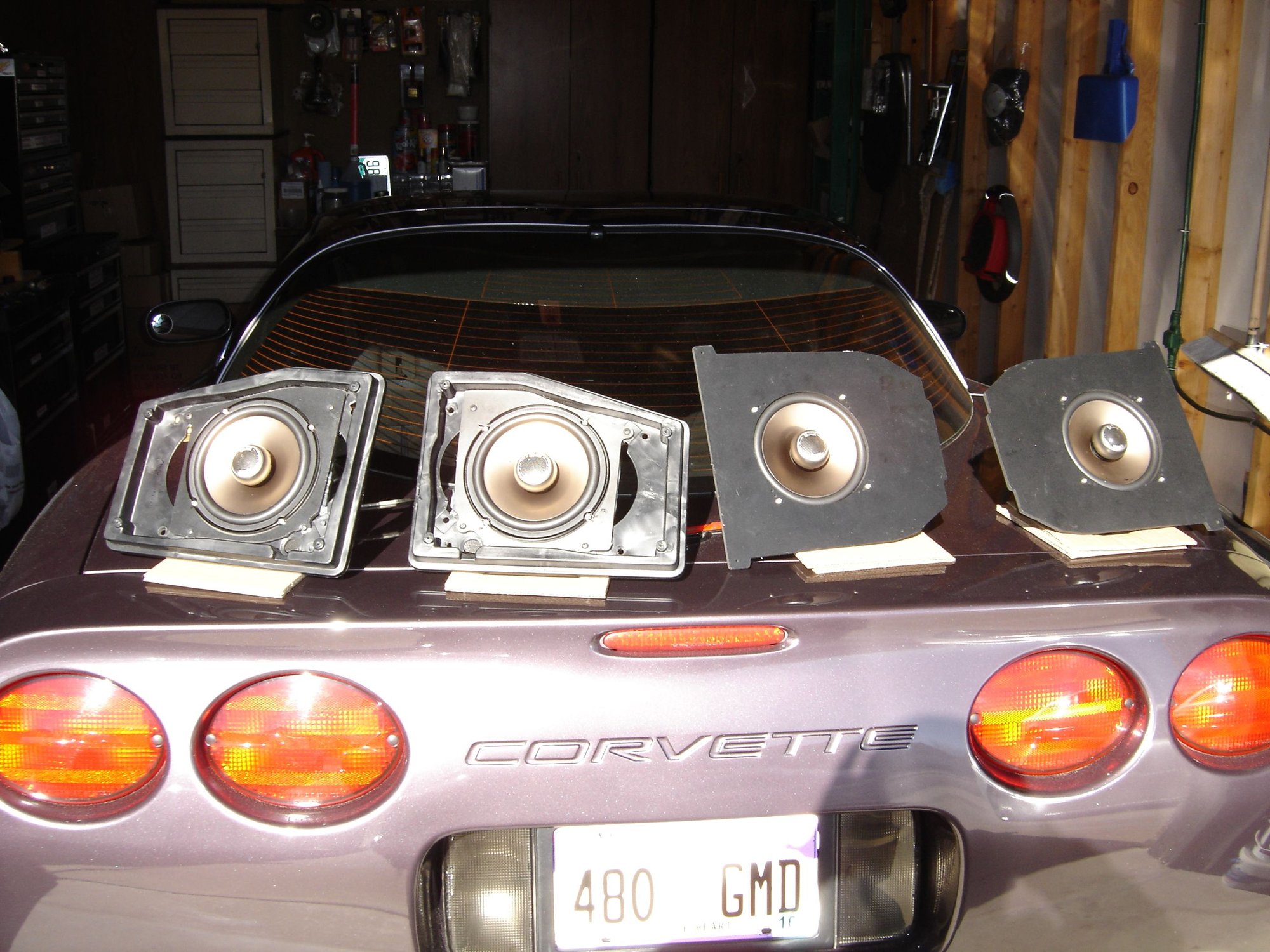

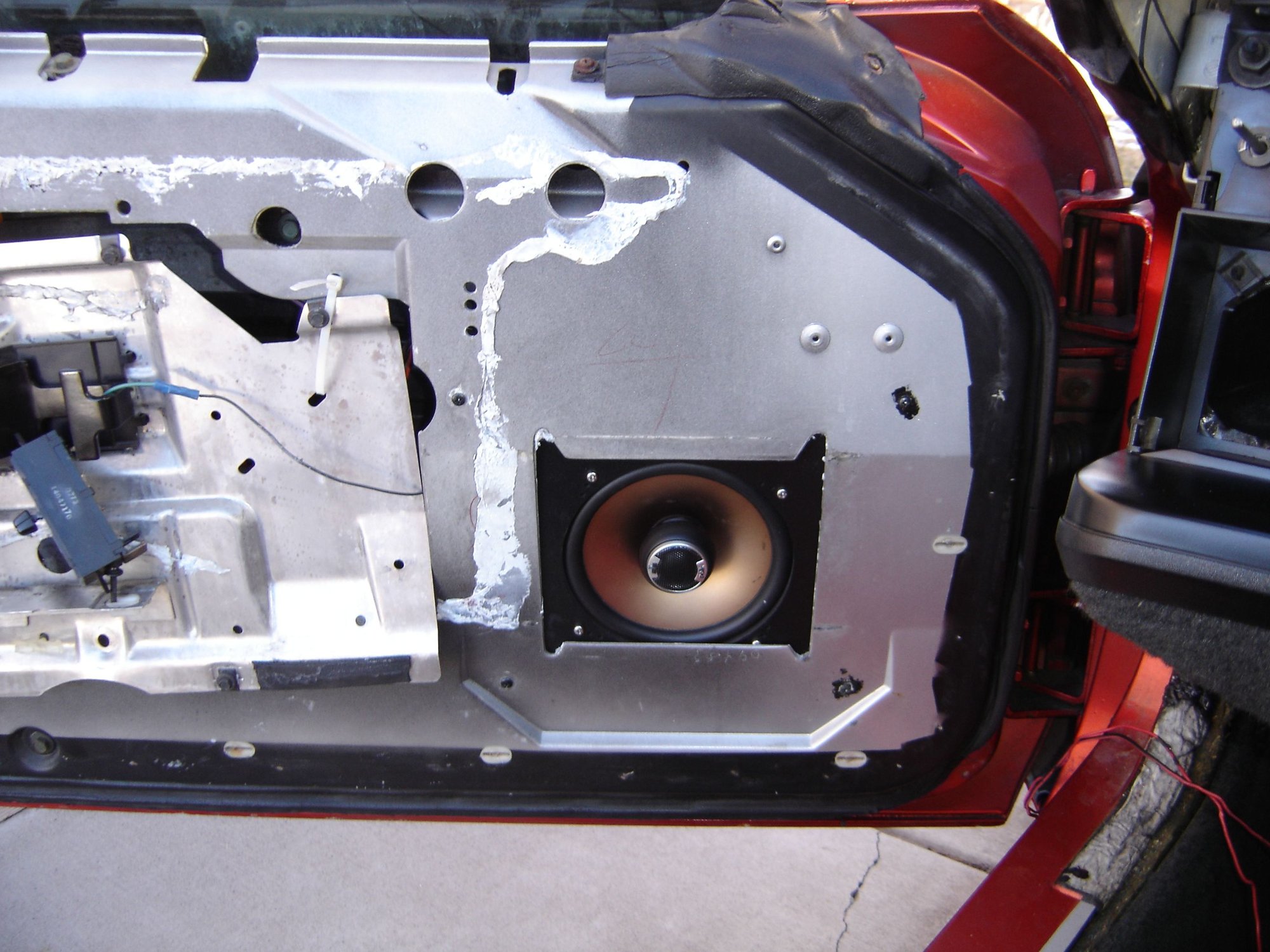

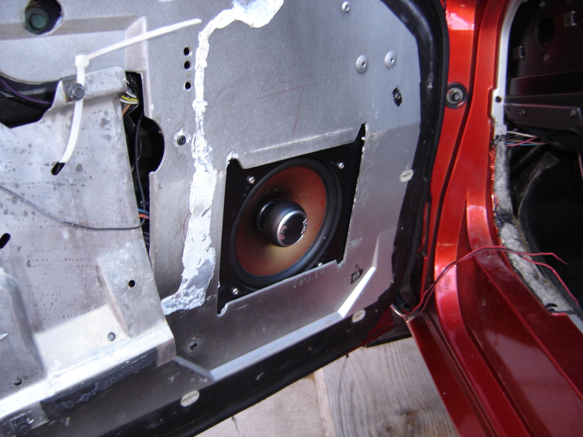

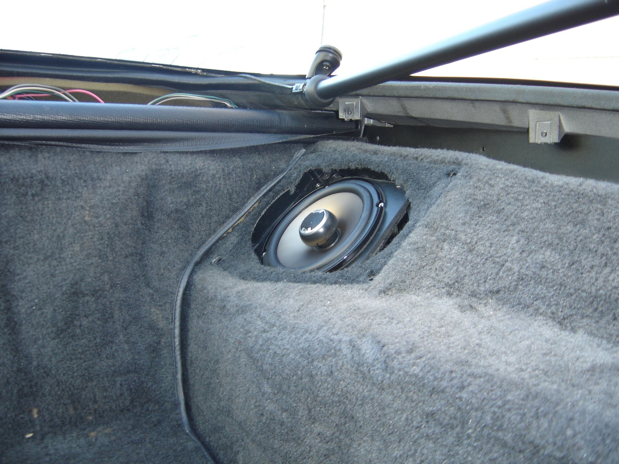

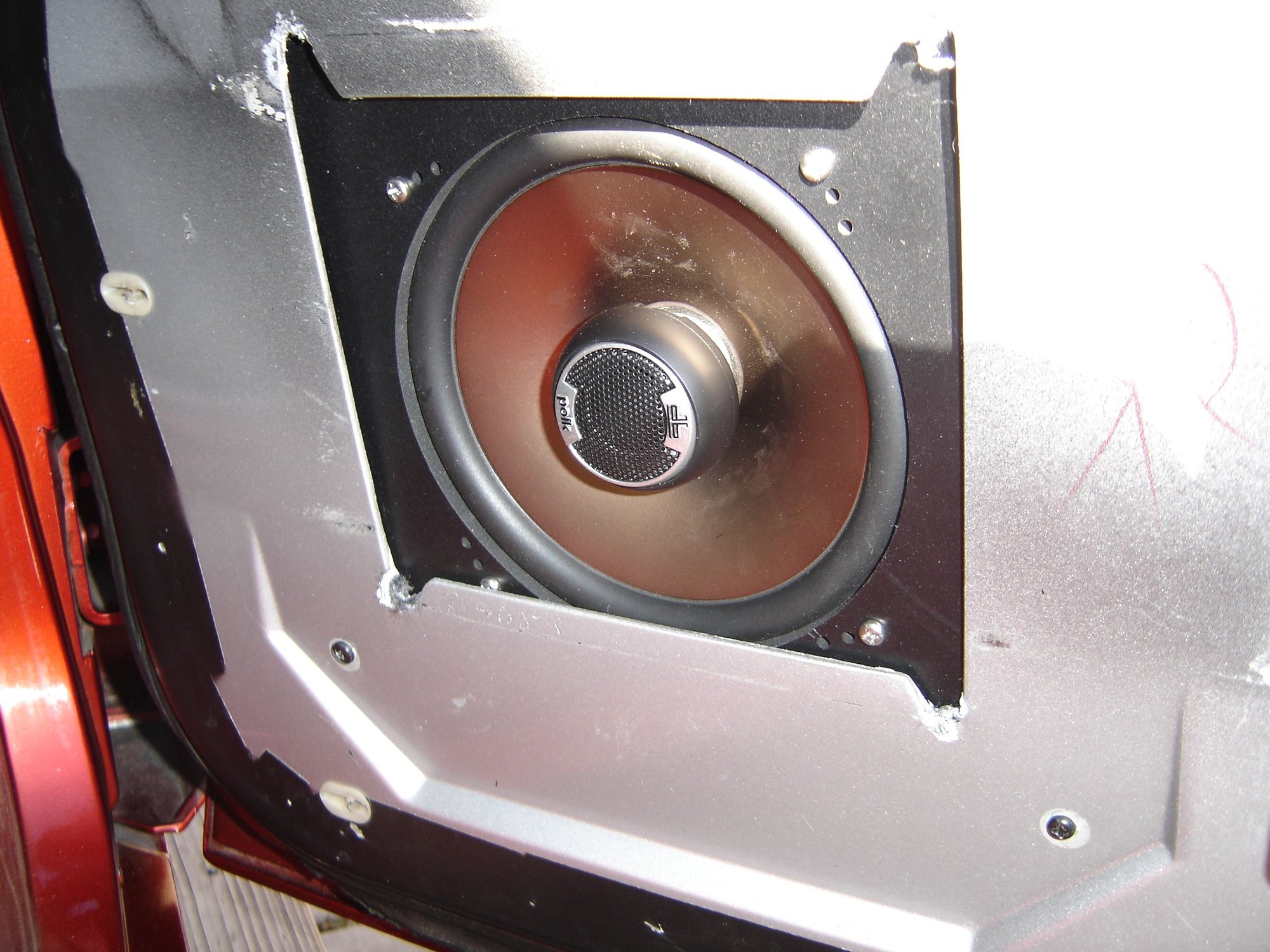

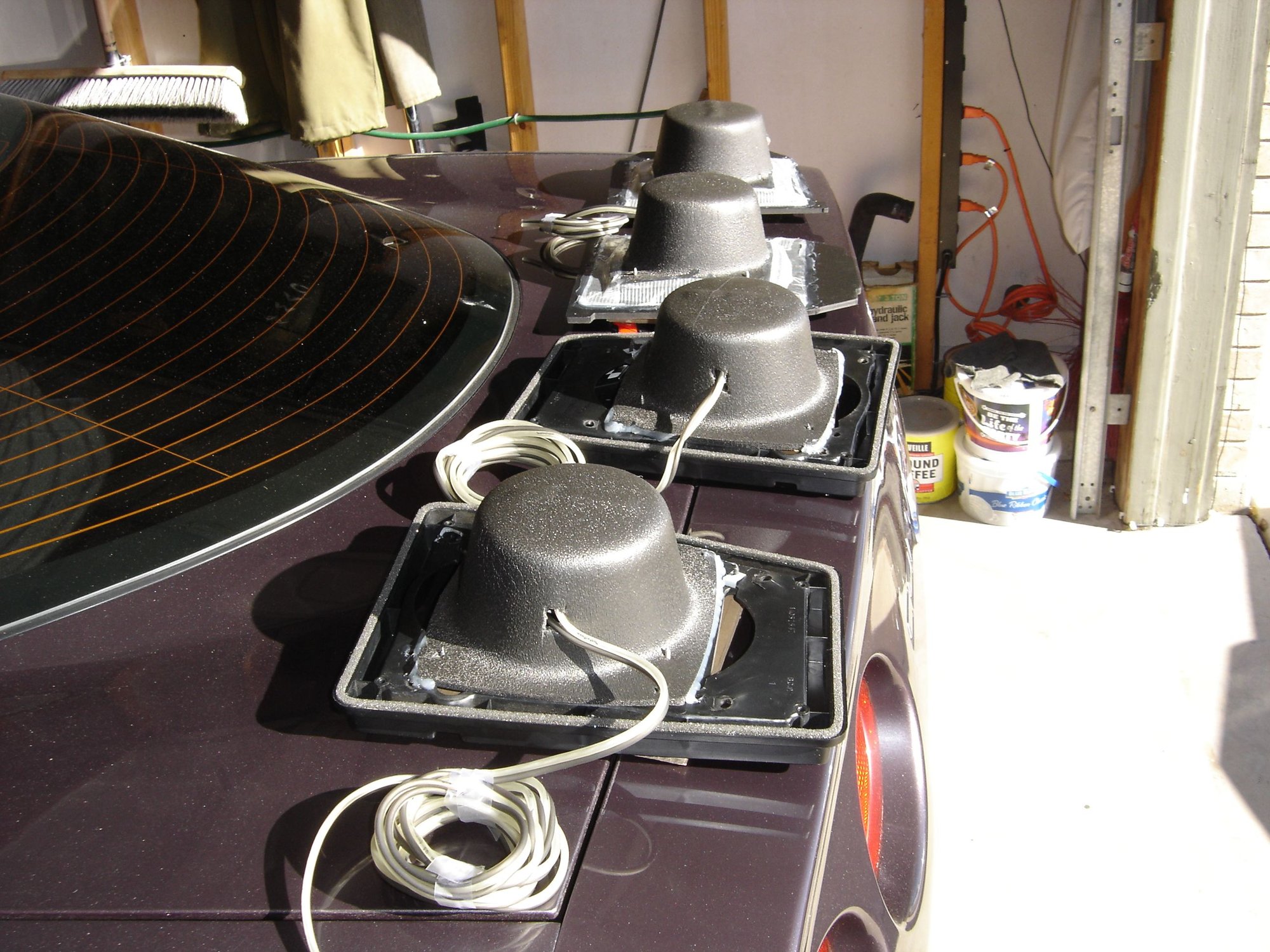

I thought I had posted a narrative of what I have done so far along with the pictures, well anyway I just completed the installation of the new speakers on the Vette. I usewd the black harness connector to power the headunit and the antenna, the other two connectors not used, new speaker wiring and attached a remote turn on and rca cable for the amp and subwoofer to be installed later, right now the sound is great, no more popping and scratchy noise
