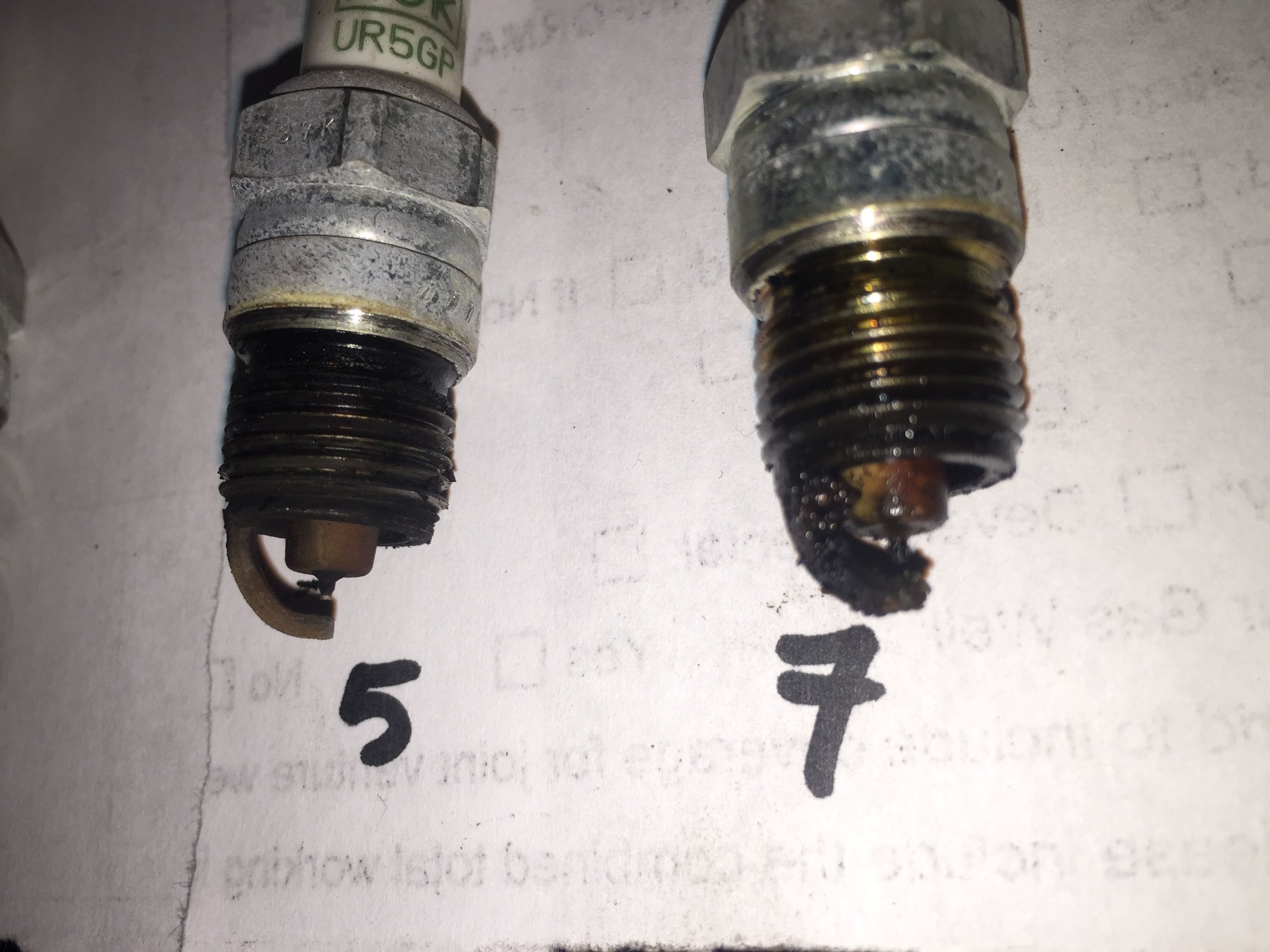

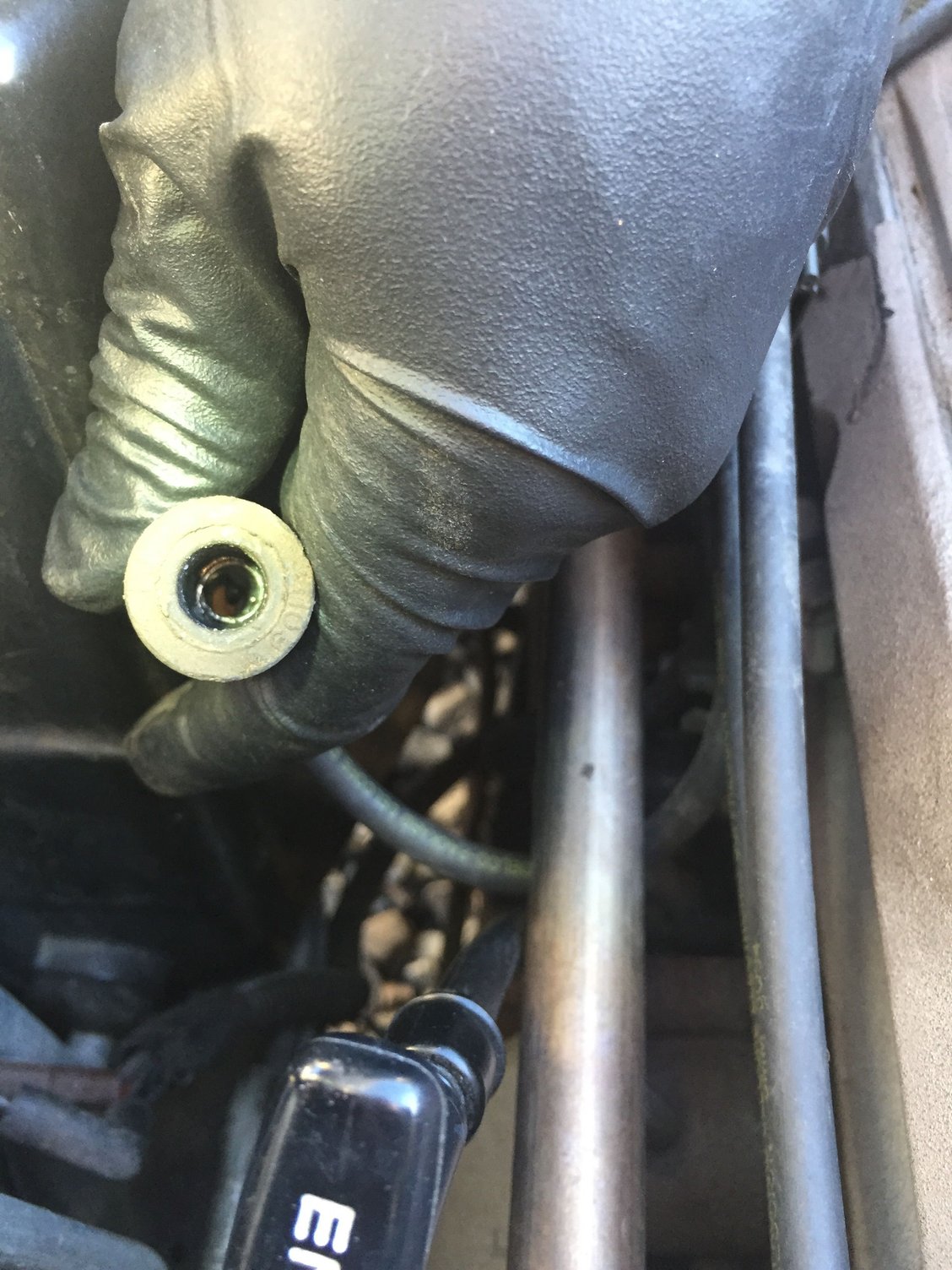

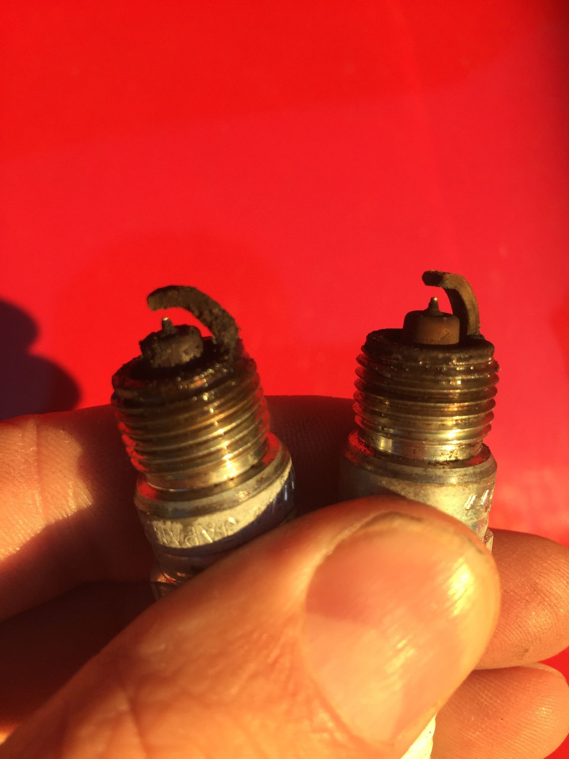

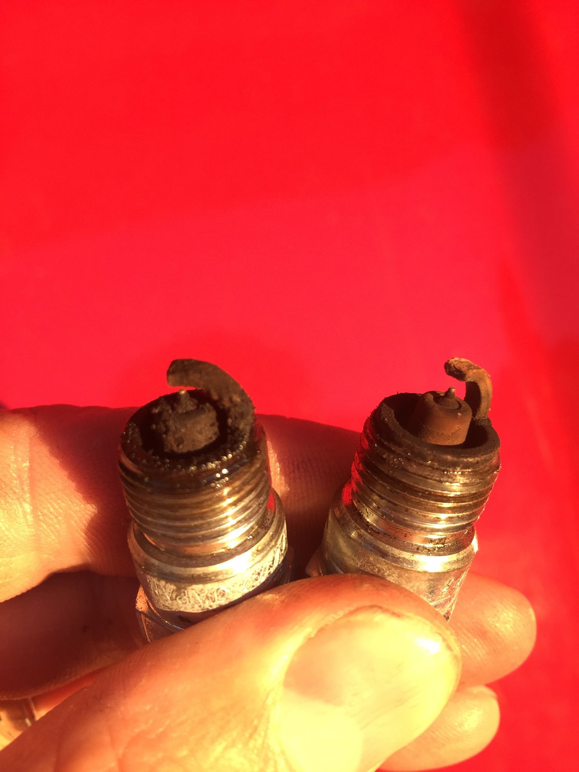

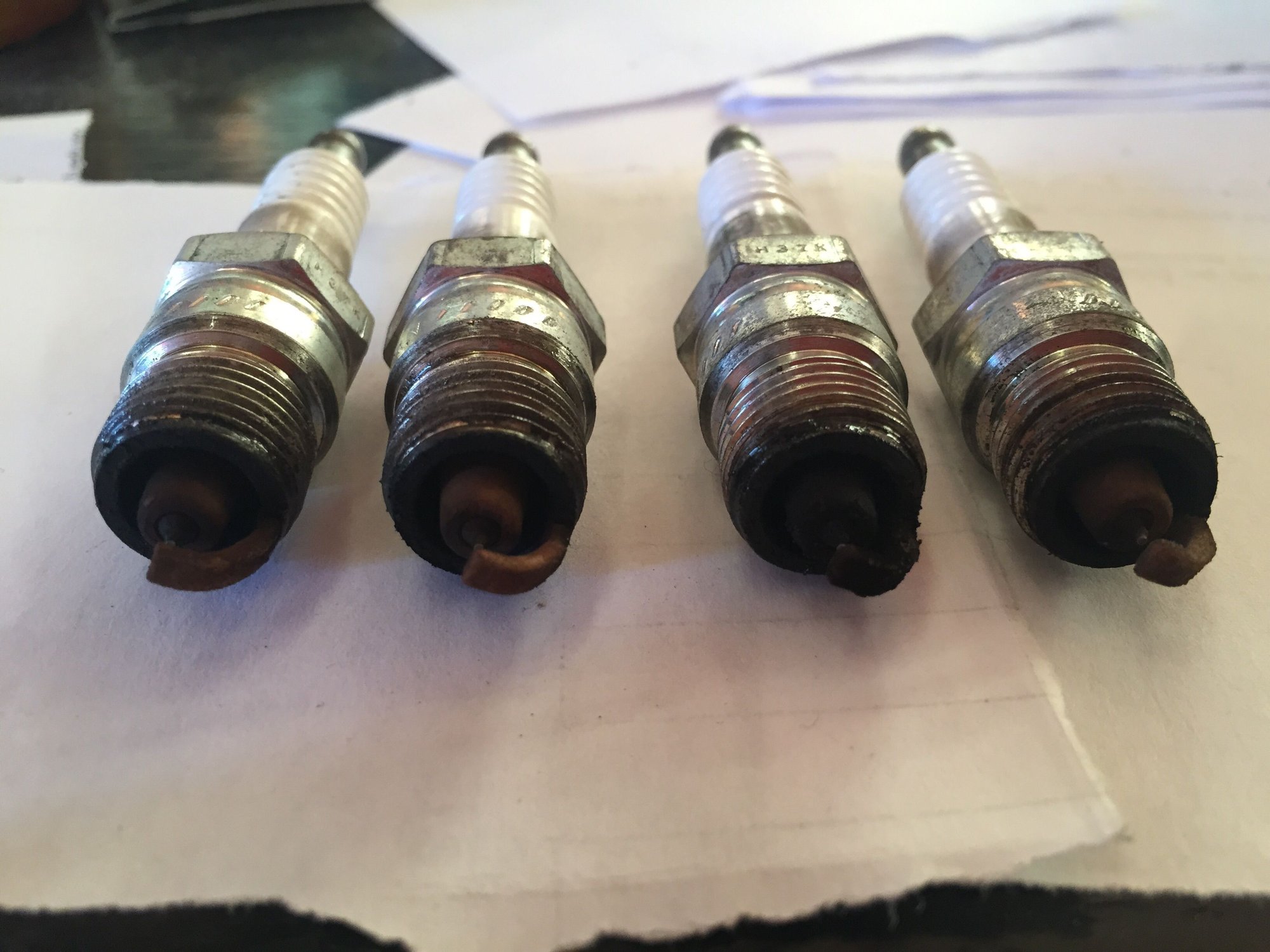

Default pulled plugs. check what i found.
only got as far as the right/passenger bank and when i was checking plug routing i noticed that cyl 6 had a different style of rubber cap, like not bent, straight, so i went there first, because it looked like it had been mashed onto the plugs so hard it was a bit ripped at the end.
the other thing is that one of the contacts on the underside of the cap had a visible groove in it. the other 7 had white powder on them but this one had a groove.
The other thing is that whenever ive been trying switching between field testing mode or aldl mode or normal mode and i start the car the next time i get a knock from the passenger side. im guessing its cylender 6!
its reversed of what it shojld be in the pic sry.
so left to right, 2,4,6,8.

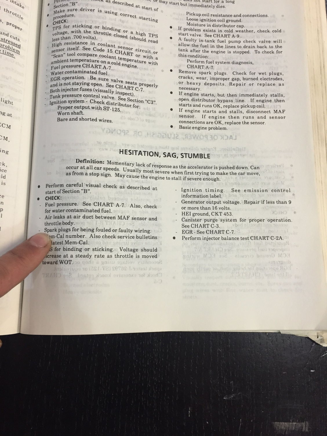

so my next question, would this cause the stutter/hesitation at idle? according to my shop manual yes, but it doesnt say if allll the plugs need to be fouled or just one.
this car hauls *** once its moving, no power loss other than the hesitation when i stab / smash the pedal.
hard to see but it looks like the plugs bent the metal inside the cap from being pushed too hard. its a straight rubber boot. supposed to be straight?
2,4,6,8

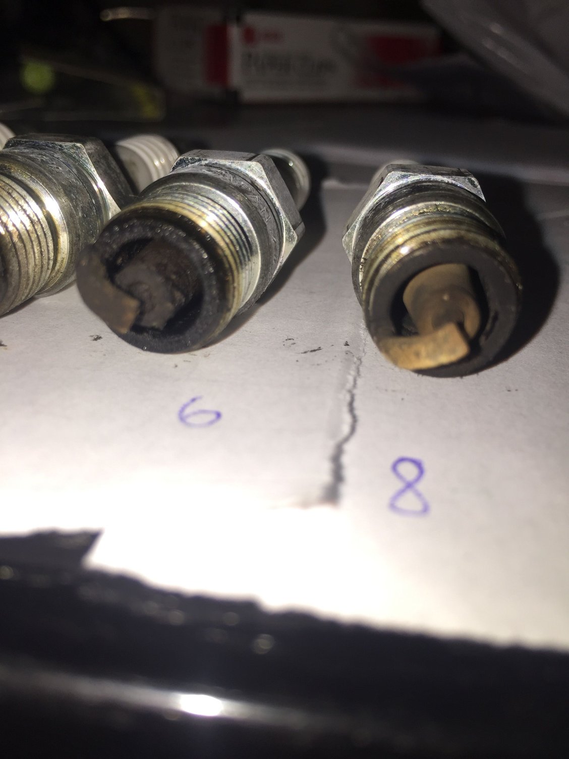

very little build up on any of the other ones. except for 6 where its chunky and black. it does not smell like gas. i assume its oil.
6,8

OK. Before we go anywhere or any further, lets do a compression test and a leakdown test. If your rings are leaking, NFW we can do anything else for you. I've done a lot of things crazy and/or stupid things in my time but none of it involves growing metal back on an engine. For that, you call Obama.
IF your oil leak is from the valve stem seals, you lucked out. That's an easy fix. Change the seals and you are good to go. After which, change plugs and get a good wire set. Tempting as it might be, if you do one, I'd do all the seals.

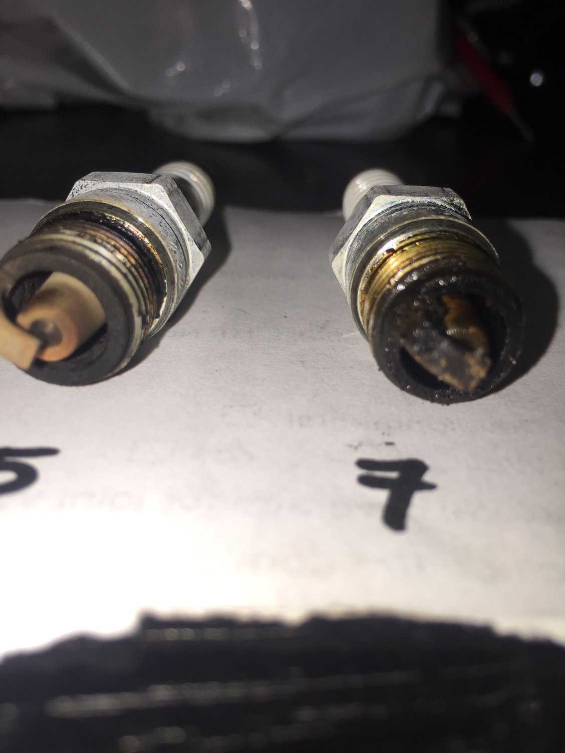

Hi again. Ok seeing as i am going to do my compression test over the lunch hour tomorrow, i thought id pull the left bak plugs and get the pictures up for you all to see.
i think i can see why the car is running rich and the blms are pulling back. im thinking the plugs in cyl 7 and 6 are not doing a great job of combusting the fuel.
The bog i have while at idle, shown in my video, i am thinking that maybe the computer is pulling so much fuel back at idle its actualy a lean bog. meaning i instantly jam the throttle wide open and the computer is busy trying to pull back the fuel because the o2 sensor is reading unburned fuel so then there isnt enough fuel for that split second, until the comp thinks "oh, ok i thought i was running rich but now i see im running really lean so i have to swing the other direction".
again, im nooballs so no idea but anyway. we will see what happens on the compression, wet and dry, to help narrow down valves vs rings.
any hi ts as to how u guys are squirting oil in for the wet test? would squirting some penetrating oil in there do it? just thinking something under pressure with a delivery straw to aim in the hole.
pics:
showed 6 in the prior post, but here is a shot up the bottom. its by far the worst and other than 7 looking like its befinning to foul, the rest look consistent
