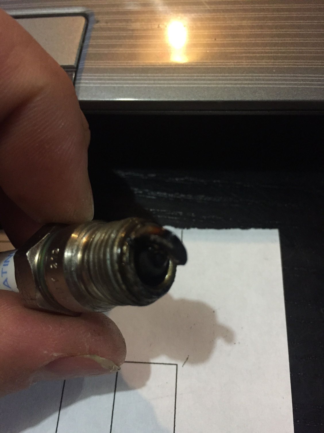

so, as you know i put brand new plugs and wires in this car 2 days ago. ive started it 5 times for a couple minutes each time to video the flywheel (different issue, dont ask).
saw the oil slick in the above post with the condensation rust spots, and thought hey, why not pull the plugs. i pulled 4 and 6 and they have oil on them.
so, if compression was good, which it was, then, do i have toasted valve stem seals? i do get a nasty puff of oil smoke on startup. if valve stem seals are bad, would that have any impact on runability? like would that impact rough idle?

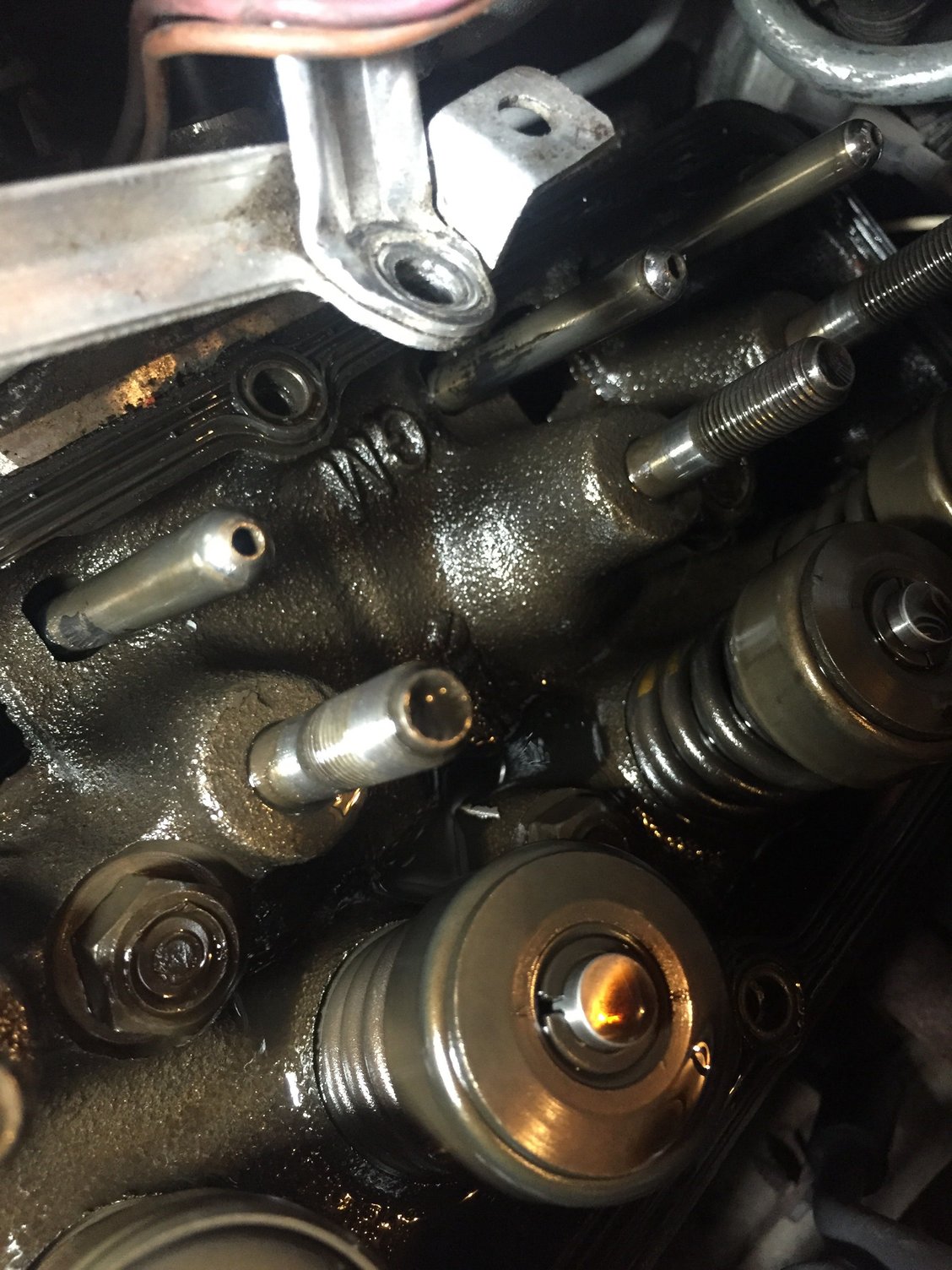

well, it was pretty clear from the oil on the plugs, the oil residue in my exhaust, and the puff of smoke when i first startup, that my valve seals are toasted. (checked pcv and valve was working fine)
So, i took a slight detour from diagnosing my crappy idle to replace the valve seals because afterall i did just get a brand new set of plugs and i dont want to foul them too!
question:
what condition causes the pushrods to have black carbon buildup on them? it rubs off with my finger.
pic:
one side had this gasket. the other side had red rtv. im going with felpro. <br/><br/>check out the black carbon on the pushrods.

this is my first time working on a car and ive come along way in a short time with the help of people here!
should take me a couple weeks to get it done.
the irony about all of this, is that ive had all the accessories off the front. had the intake off. this was all before i knew enough to start evaluations at the base of the foundation, meaning compression and internal engine cooling. ive even had the cooling system drained and flushed! ive done all the work leading right up to undoing the head bolts!
hopefully if another noob comes along this thread can help them out:
before you do a single diagnostic repair, even something as easy and benign as an iac, and even if your symptom is a "crap idle" as i so eloquently out it, ESTABLISH THAT YOUR ENGINE GASKETS ARE NOT COMPRIMISED ON THE OIL AND COOLING SIDE.
as long as that is good, then u can fix and replace the smaller insignificant items.
course, i probably read that somewhere a year ago, and just glazed over it as a noob didnt pay any attention to it. ive spent hundreds of hours kearning how to diagnose the small (they appear insignificant and easy now) and all for naught if you have a blown head/intake gasket and/or a cracked block!!
ill continue the process and hopefully with help here ill see this through and have the 85 running like it should.
