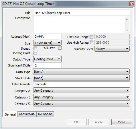

Yes, LC449 and LC44A are the memory addresses that store the warm and hot closed loop timers, the other locations store the temperatures that these loops would be enabled. The hot loop timer lasts for 54 seconds. and the warm loop is 206 seconds. Here's a screenshot for how this looks when I right click on the hot closed loop timer scalar in tunerpro:
To add these to tunerpro, right click in the parameter tree and make a new scalar that looks like that for each address. Replace LC with 0x. So LC449 becomes 0x449 and so on. If it's set up right you should see 54 and 206 seconds for each timer when you double click on the scalar. You will be able to adjust it from there.
This is all assuming you don't have these scalars already. Look through your scalars and make sure they aren't already there.

I'll check it out. Thanks for great info
