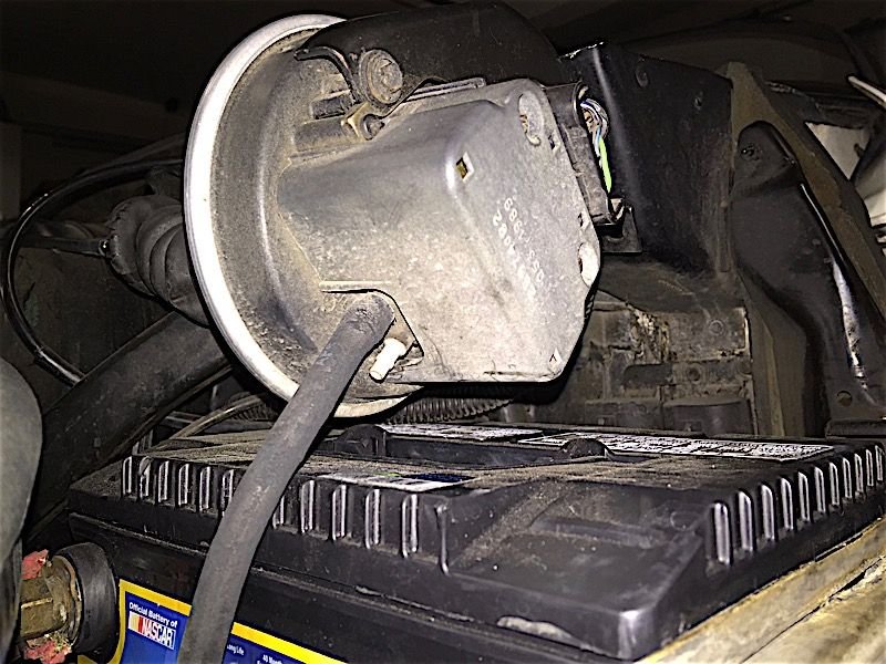

I just went through this last weekend. In my case I had multiple problems. I had my C68 controller display "--.--" at times instead of real values. I tried the clean the edge connector with an erase approach and that worked for awhile. My problem the display would go black even though the I can hear the fan increase or decrease by pushing the up/down arrows. I ended up taking it apart again but this time soldering wire between the connections. I removed the edge connector (there is a great write up on the net, that's where I got my information from)
My 2nd issue was a vacuum leak. I thought maybe there wasn't enough vacuum getting to the under dash programmer module. I found a hose that came from a "T" connector that was supposed to connect to the cruise control module. It has broken off about an inch from the nipple. The connection is underside so unless you know what your looking for it's not that easy to find.
My 3rd issue was the programmer. In a nutshell I had cold and fractured solder joints in the known resistor failure areas. Knowing what I know now it will be a heck of a lot easier the next time I do it. I plan on bi-rating the wattage value of the stock resistors later. One advise is to just remove the drivers seat. I'm about 6' 250 pounds and I barely had enough room stuff my big head under the dash. I'd also remove the PC board without disconnecting the vacuum hoses connected outside the case and disconnect the hoses inside the case. They are much easier to work with and if you have a bad PC board you may have dodged a bullet messing around with the outside hose connections.
I included some photos to give you an idea what it took in getting my heater running. I had the same issue you described. It's not that bad of a project just be patient and keep track of how you took things apart. I took a lot of photos so I could refer back to them later, I'm old so I can't remember much
You're doing some good work there. The 88 is quite different than the 94 and 95. There is a write up on those resistors you talk about for years. Doesn’t seem like you need the post anymore.
