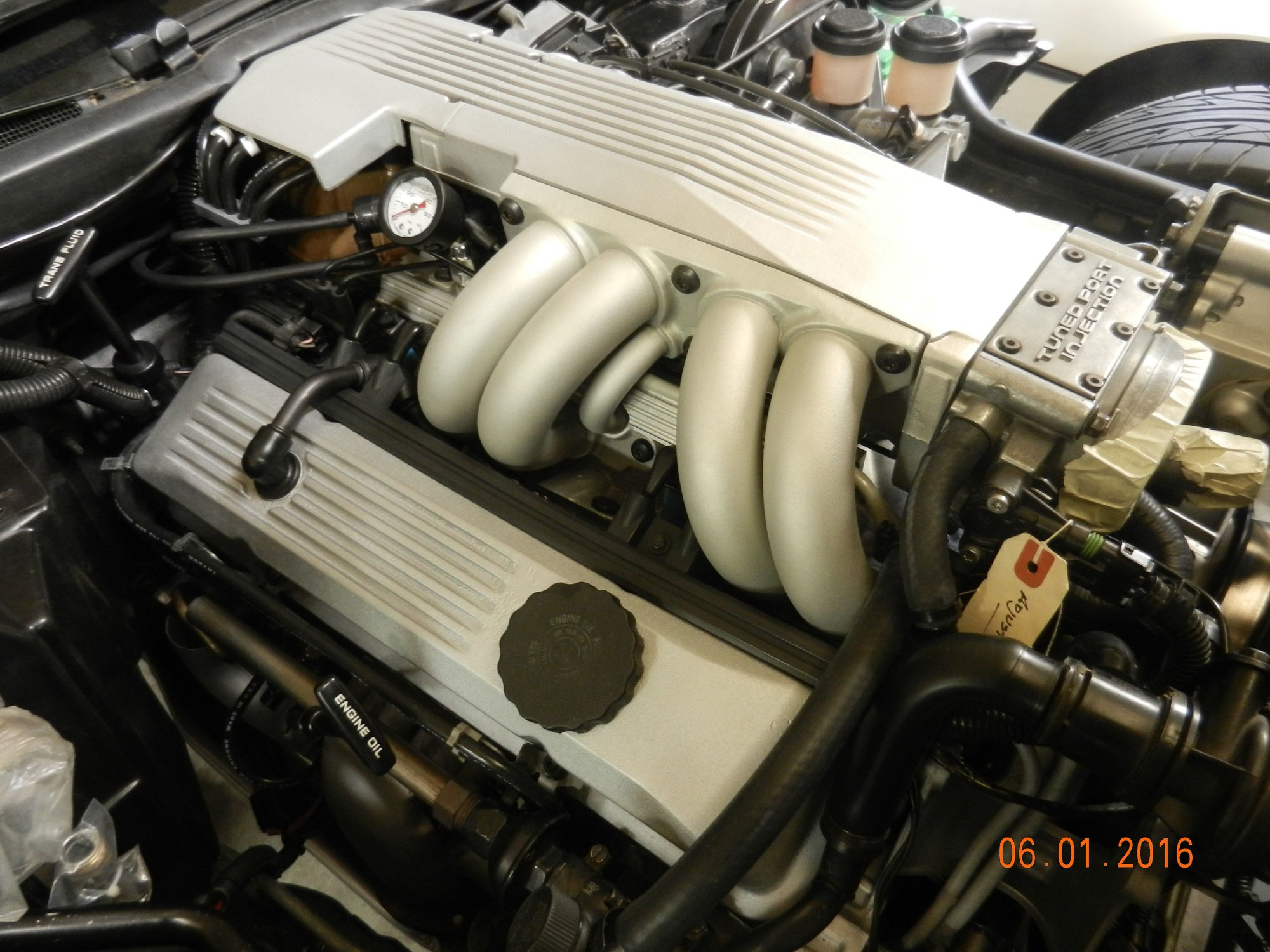

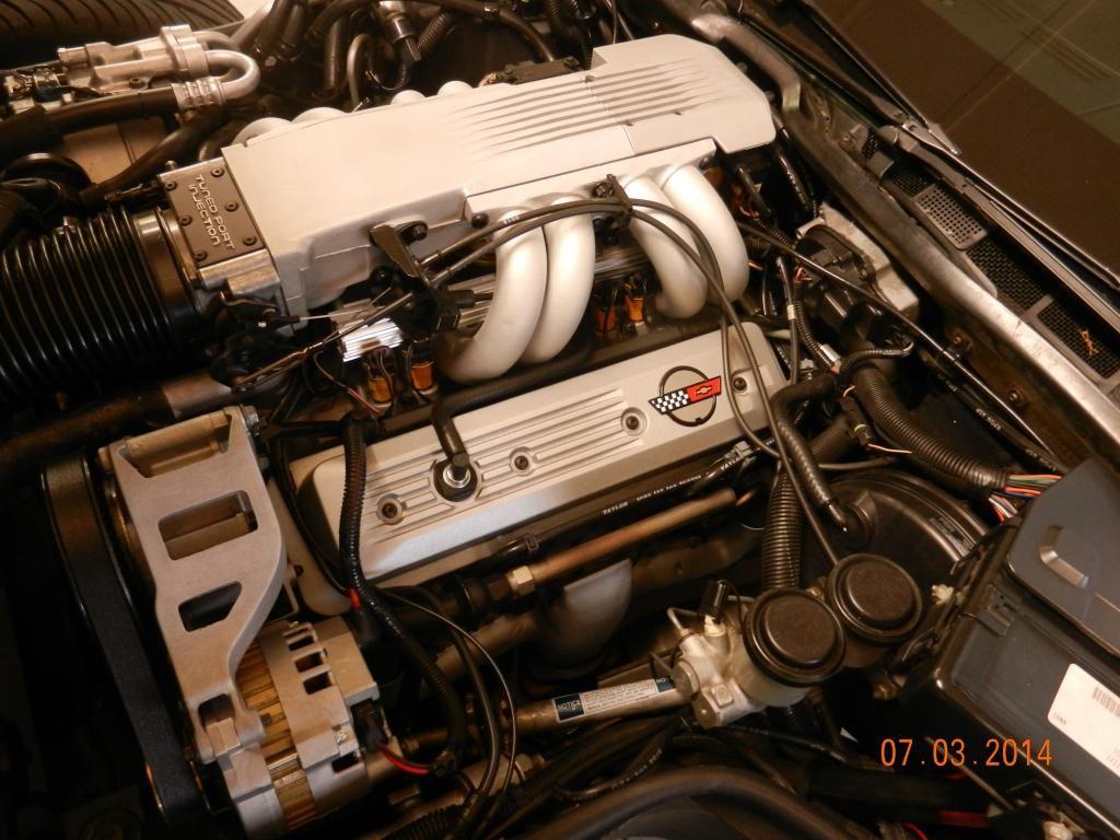

here's a couple pics of me NOT following directions -
side note - the valve covers are not aluminum, but magnesium. they are painted, not chem-film'd. exhaust manifold heat shields - VTH header paint, color, flat aluminum, and fuel rails - just solvent cleaned - natural, factory, OE finish.
my "under-construction" 85 -

Originally Posted by Joe C
well, all I can say is I've (glass) bead blasted ALL my parts before the DX treatment. as I said, been using the stuff for around 20 years. never an issue!

Originally Posted by xrav22
I like the natural look also, I'm getting ready to do mine. Hey Joe C where did you get the valve cover tubing and injector covers for the 85?
original equipment. I'd like to replace the VC grommet and the 90 degree rubber elbow, but haven't found a source for suitable replacements. may have to retrofit later L98 hardware - ???

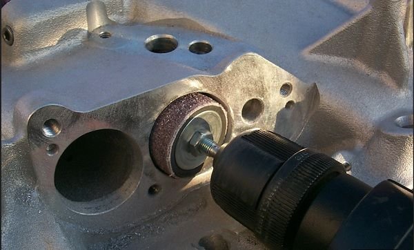

it's a good chance to port that manifold,do you plan to port out some aluminum from those intake ports
