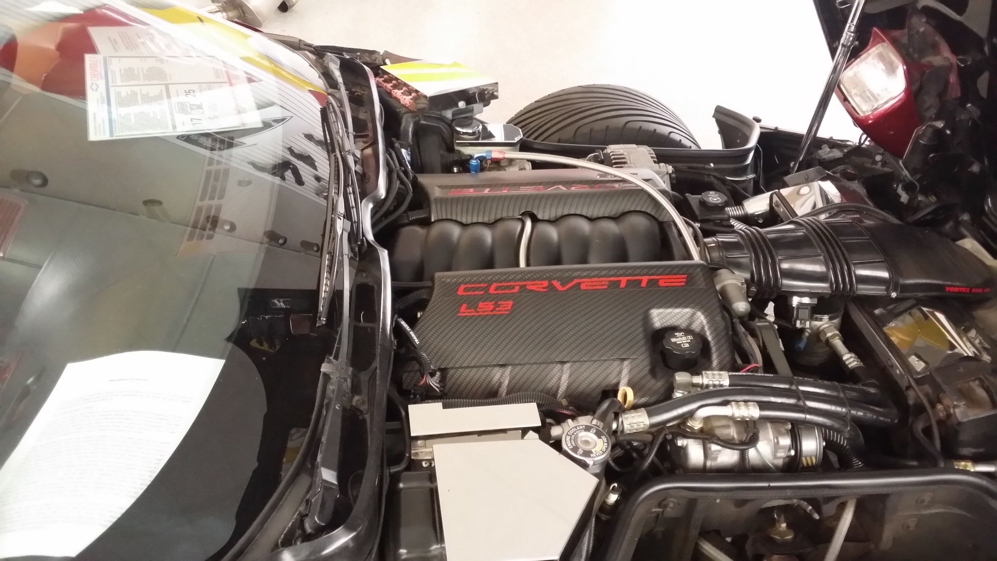

A guy here on the Forum has a LS3 built pushing 500 or more crank horsepower. CForce?
It eliminated my concerns about the Dana 36. Drag racing is another story.
This is an automatic Dana 36 and he said it's rock solid zero issues regarding its ability to handle the additional 200 horsepower.
