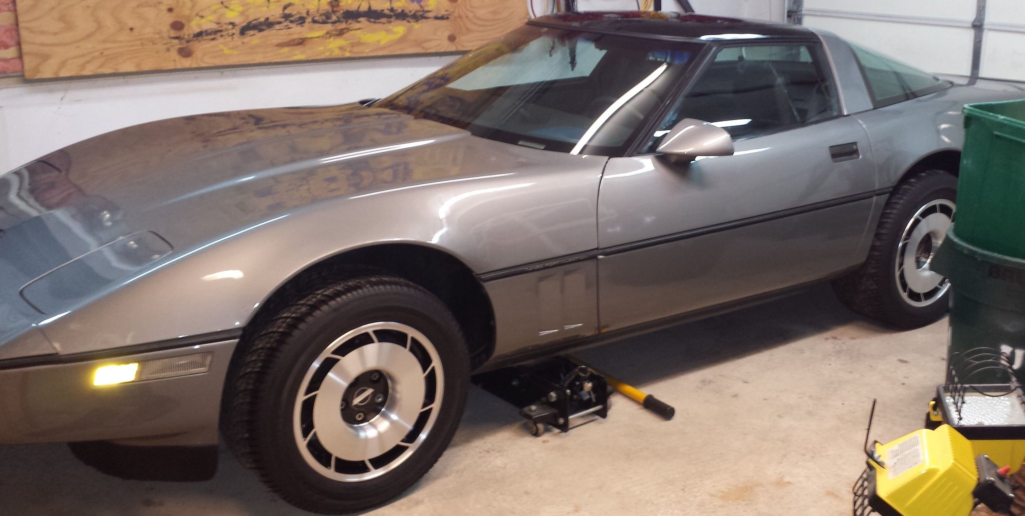

Just purchased this 76000 mile 85 C4 with the Engine and Transmission not installed. I have a 350 engine sitting on a stand ready to install. The 700R4 will be rebuilt completely. I'm looking for suggestions and some tech help thru the build.
Here is my 350 ready to go.
350 2 Bolt Main,
4.00 Bore – 3.480 Stroke
Vortec Heads 12558060 – 64/170
Eagle Crank – 103523480 – 1 Piece 3.480
Crane Cam – 270-100132 – 2500-5800rpm
Speed Pro Pistons - STL-H345NP – 4” bore +5.00cc Hypereutectic
1) What manifold would work with my vortec heads and the original TPI?
2) What type of exhaust would you recommend? Chambered, Dual Exhaust, Original with or w/o cat?
3) Solid Motor Mounts or Polyurethane?
4) Will I have to have the computer reprogrammed To recognize the new motor.
ANYTHIN ELSE YOU ALL HERE AT THE FORUM could think of??

I hope the pictures are NOT showing some important things....like wires. I hope that the wiring harness is tucked out of the way someplace.
You will have to have a new chip made for the change (cam) in your motor.
Have the auto rebuilt with heavy duty clutches and a 2400 stall converter. For daily driving you will not notice any major difference until you get on it. Also a mild shift kit....make the trans last longer.
Thanks John,
Yes the harness is tucked under the firewall. All connectors are there for the tpi and injectors. I might be missing a few items buy ill check along the way. I have a parts & illustration catalog.
Funtoy
