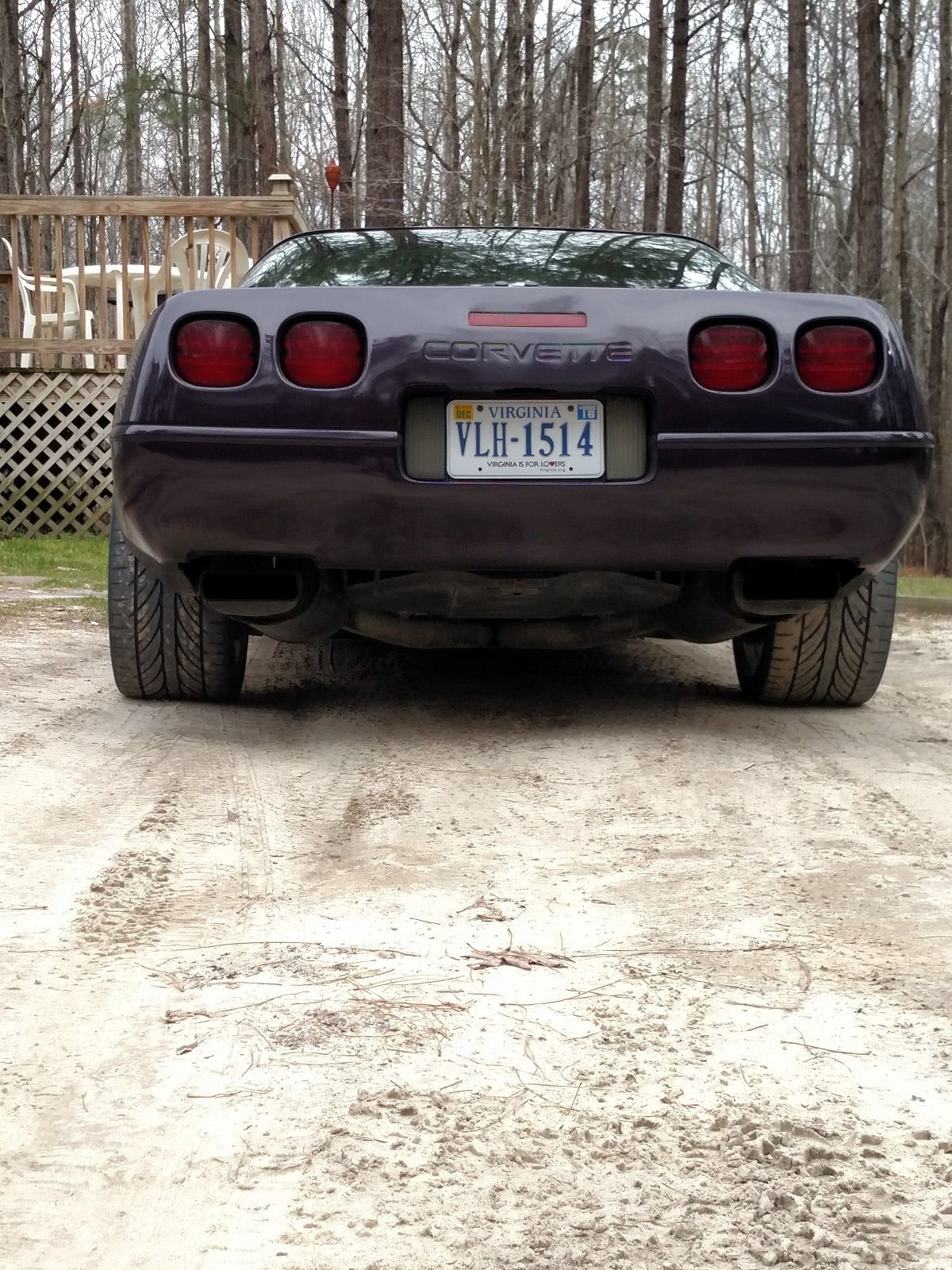

these are 295/35/19 Hankook V12 Ventus EVO mounted on 19*10.5 rims on the back on my '92 coupe
