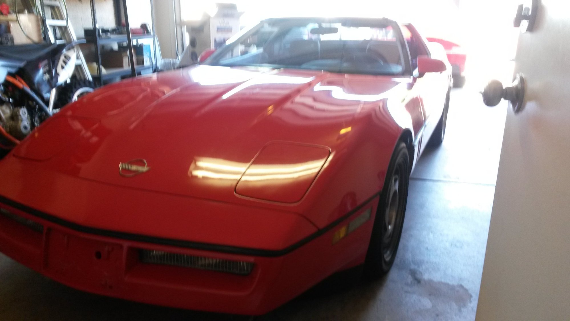

I hope this picture is better

Cool pics! Car looks good...engine look great.
Thanks. Not sure why some pictures came out tiny. I was able to fix the last one. They all came from the same camera so I know they are the same size. It's just weird.
IDK either....I've never attached pics in this site; I always DL them to photobucket, the link them here. Intake looks good.
