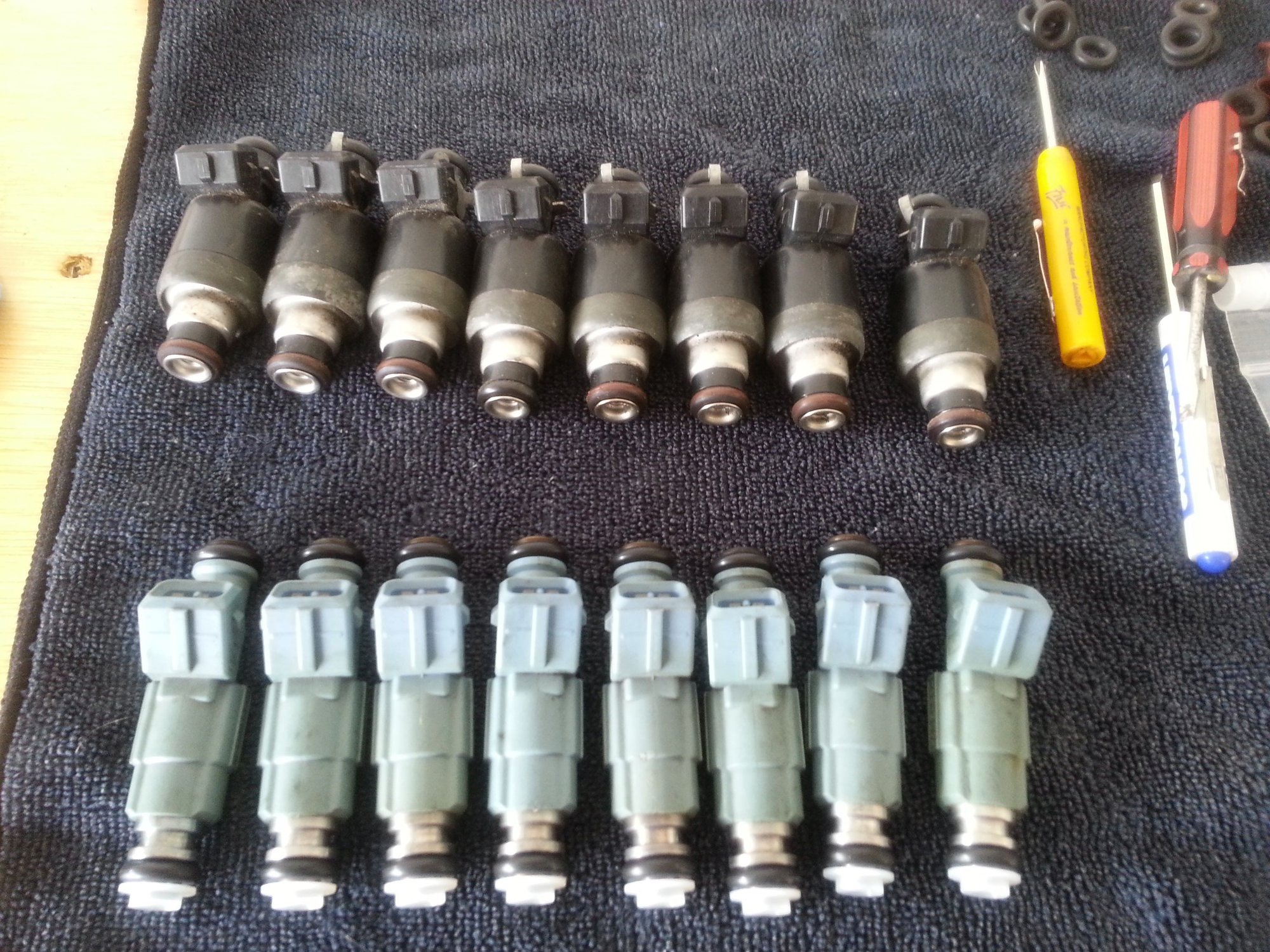

My FIC injectors are gray.

from the price you paid, it almost sounds like you actually got "new" bosch4's - ???

What ever, the FIC injectors work very well.

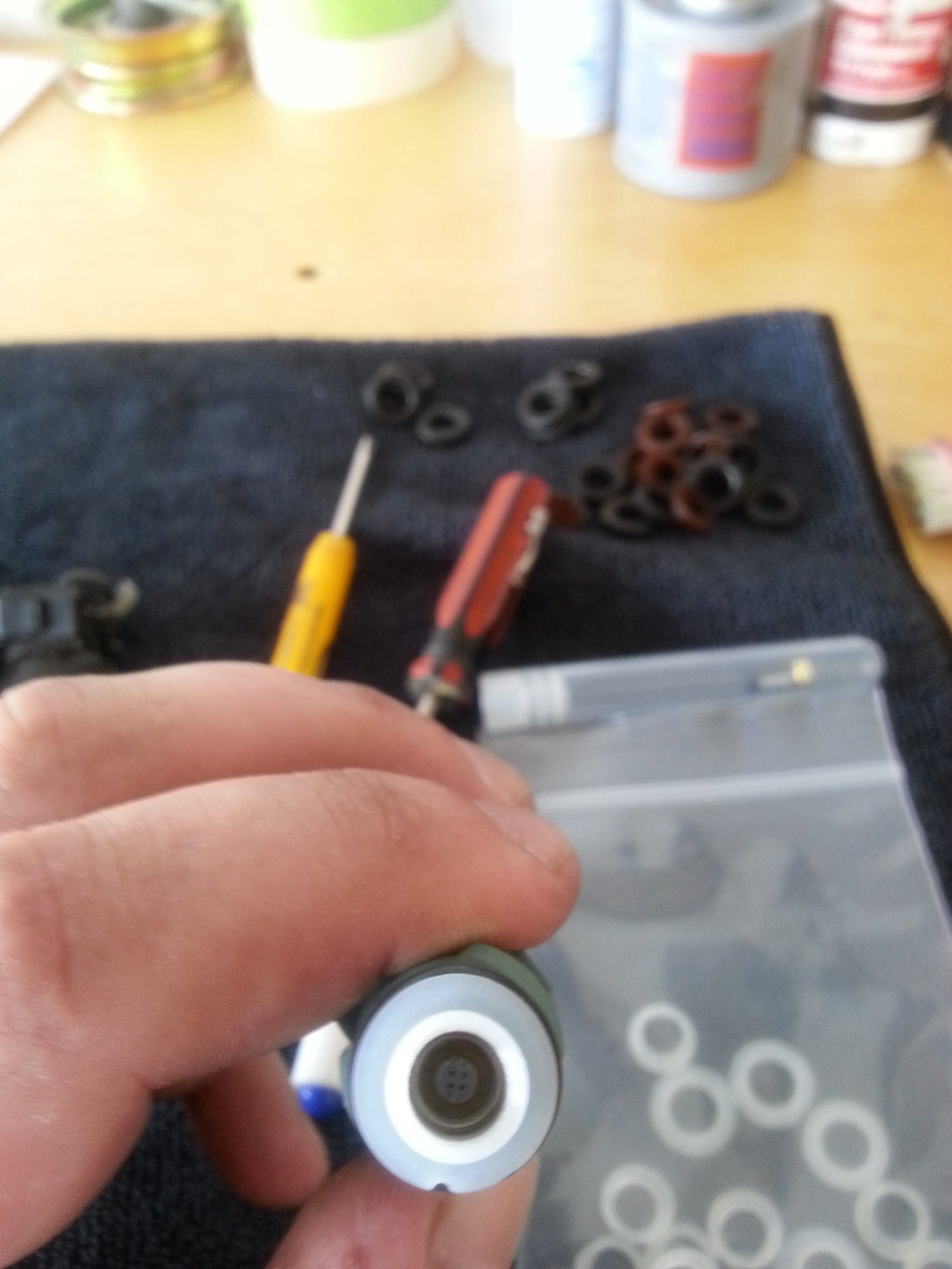

I bought a set of used Ford Blue Bosch III 24# Injectors from a member in the for sale section for $25.00. I bought a rebuild kit on ebay for Bosch injectors which includes new O-Rings and Filter Baskets. I rebuilt them and have been using these injectors for over a year without issue. Throttle response improved, and so did smoothness. I have a REALLY smooth running LT1 after various other mods I have done as well.

Rebuild kits are fine but they are part of the solution. The items do not include testing the spray patterns and flow volume.
