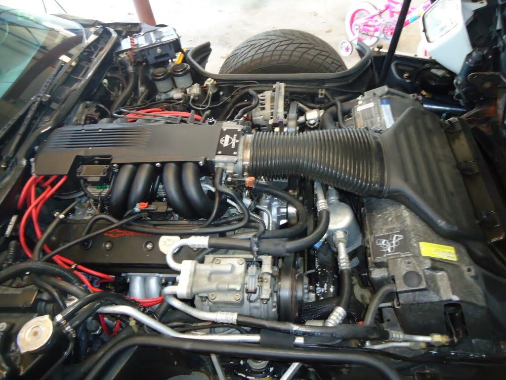

The top port goes to the valve cover and the middle goes to the EVAP purge solenoid. Not the best picture, but it should give you the idea.

Its the solenoid in between the runners in the pictures, with the red clip.
