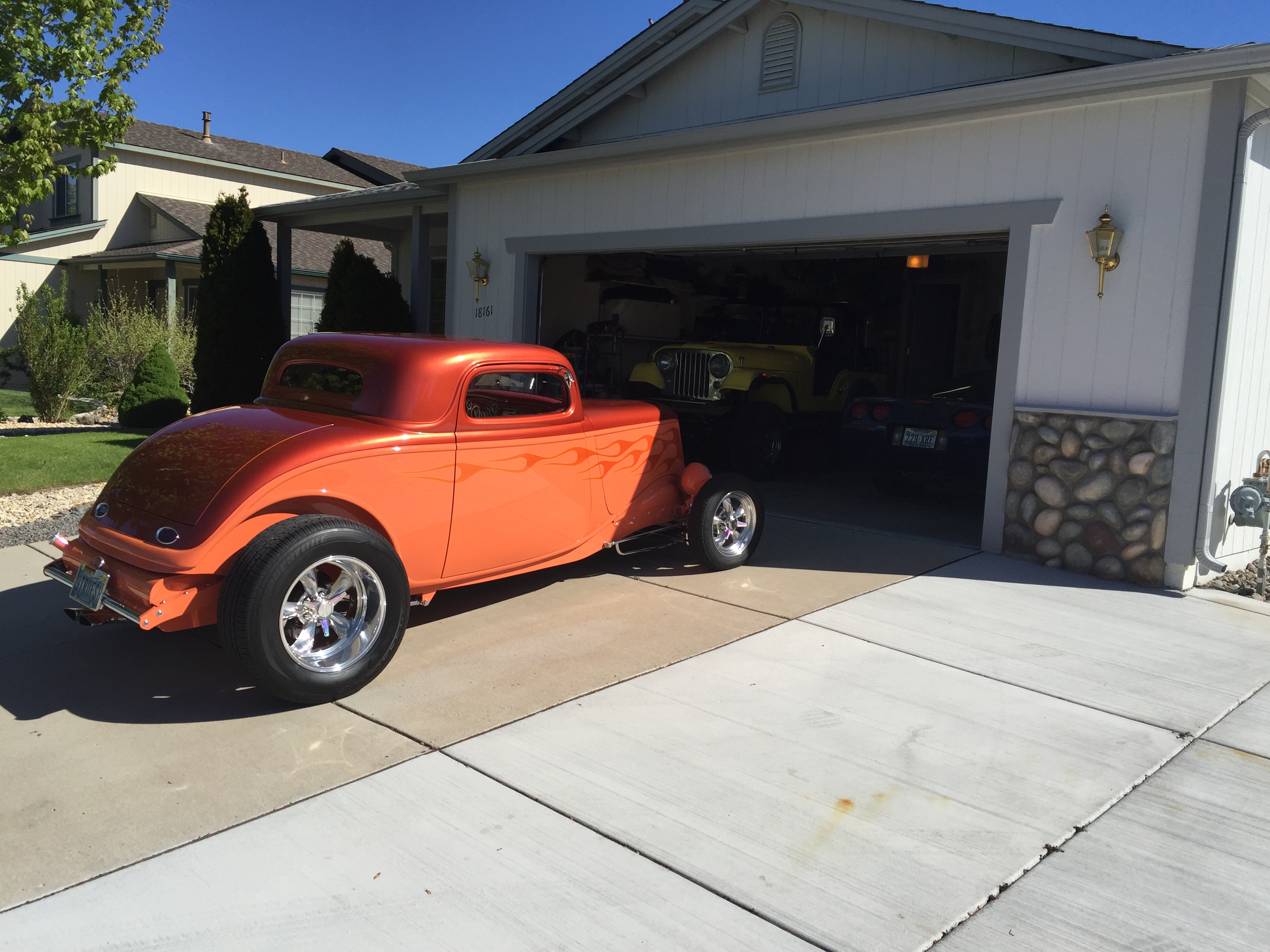

What is that supposed to show? Does not look like a G.M. site.

Sorry for the delay, I was tuning this.
Jon,
I talked with you about this injector back in 2012 (0280-155-700) and the testing I had done. I currently run 0280-150-563 at 48 psi and they work fine on stock programming. When I put the 700's in my BLM's skyrocketed and not until I lowered my programmed flowrate down to 19.8 lb did they come back in line. You're not the only vendor claiming this to be a 22 lb injector. I have reprogrammed numerous vehicles to 20 lbs and ask them to run them at 48 psi and it works. There have been several threads on this board about this issue.
Yes, I used to have you linked on my site but changed when you substituted 0280-155-890's instead of 0280-155-715 and claimed they flowed the same.
http://witchhunter.com/flowdatapix/b0280155890.jpg
http://witchhunter.com/flowdatapix/b0280155715.jpg
This changed force me to have to reprogram the car. The speed density system are so sensitive most people don't have a clue what's wrong. I'm just helping the OP out here and when he swaps in the 24's the problem will be solved.
Also, your claim of 19 lb at 39.25 or 2.7 bar doesn't wash or = 22. When run thru a calculator it equals 20 lbs.
http://www.csgnetwork.com/fiflowcalc.html
Both Witchhunter and Weiss disagree with your claims also.
http://witchhunter.com/flowdatapix/b0280155700.jpg
http://www.users.interport.net/s/r/srweiss/tableifc.htm
I'm really only interested in helping these people to get their vehicle to operate correctly. The Datalog doesn't lie and if you want to send me another set I'll test them again?
Scott
