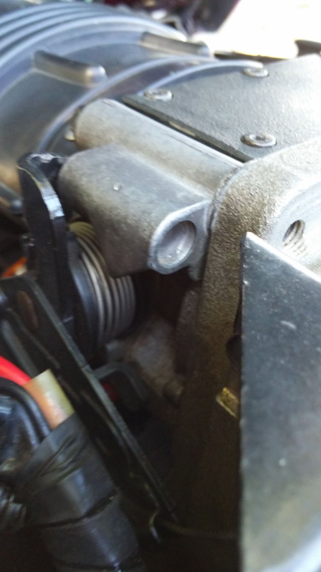

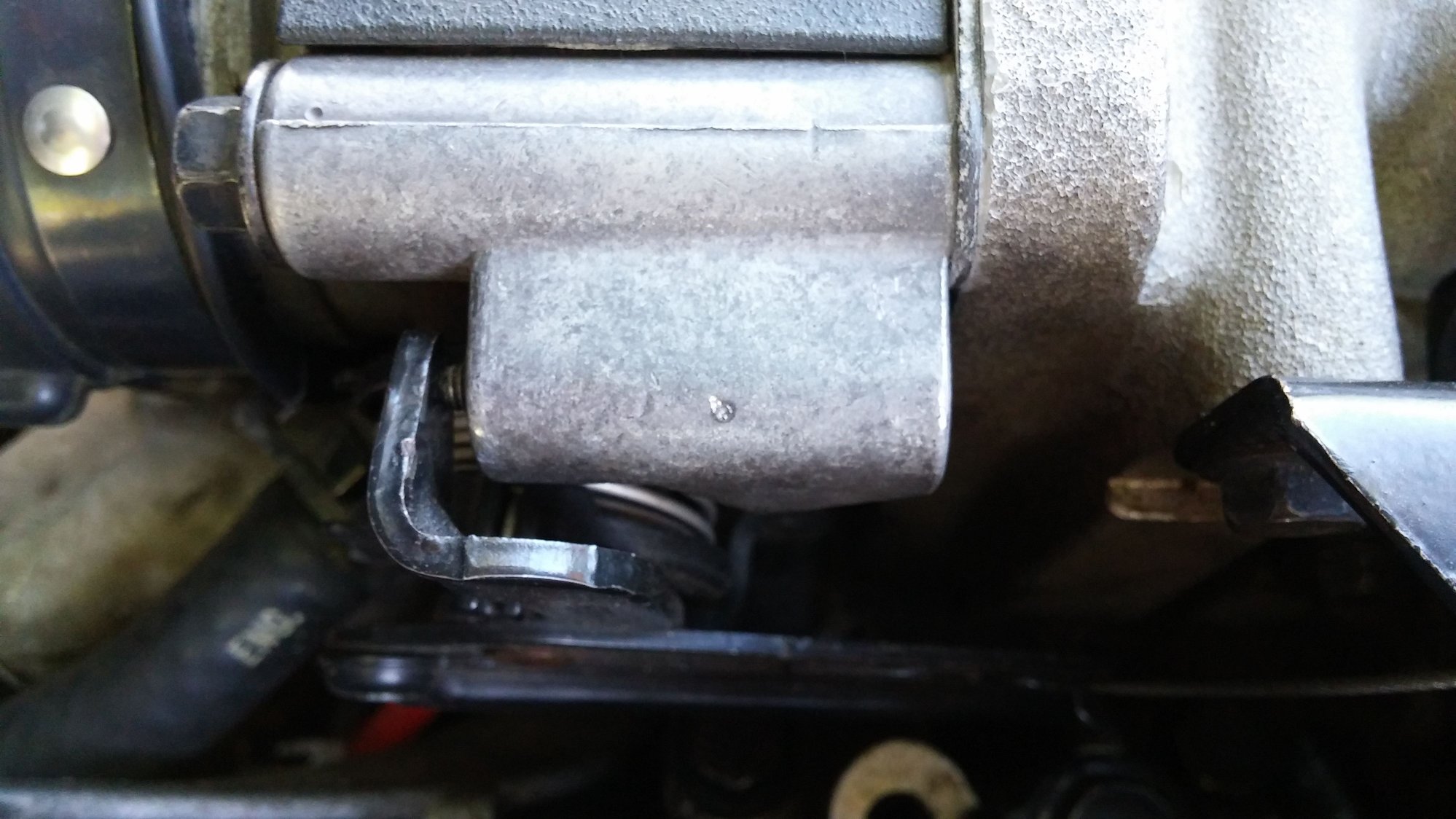

Just came back from two auto zone locations. They both had code readers only I was like nope, thanks. I can read those with a paper clip. I have no clue if it has been bent. Can anyone tell from these pics? <br > <br >

Looks fine to me
