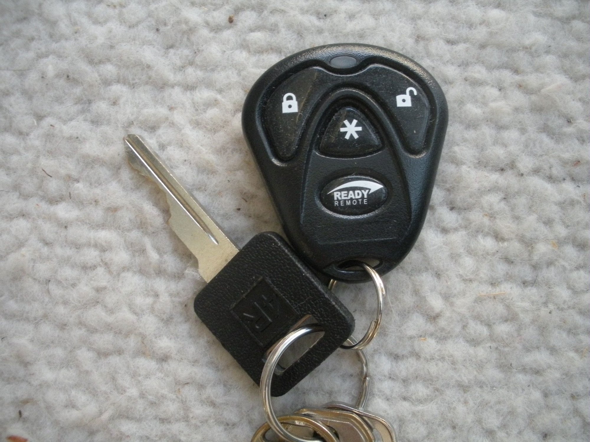

I found the remote for my '84 at Pep Boys:
Ready Remote. The instructions are very poor, so you need to be pretty competent with electronics, but I'm very happy with its performance!
Lock, unlock doors (interior lights come on), parking lights flash, hatch release, and control of the factory alarm. I've modified my antenna to allow me to leave it any position, so it's sometimes up when I want to install my car cover. I can lower my antenna with the remote, even if the car is locked. No additional power relays required.
When it comes time for the installation, there's lots of room for the unit behind your stereo, on top of the trans hump.
