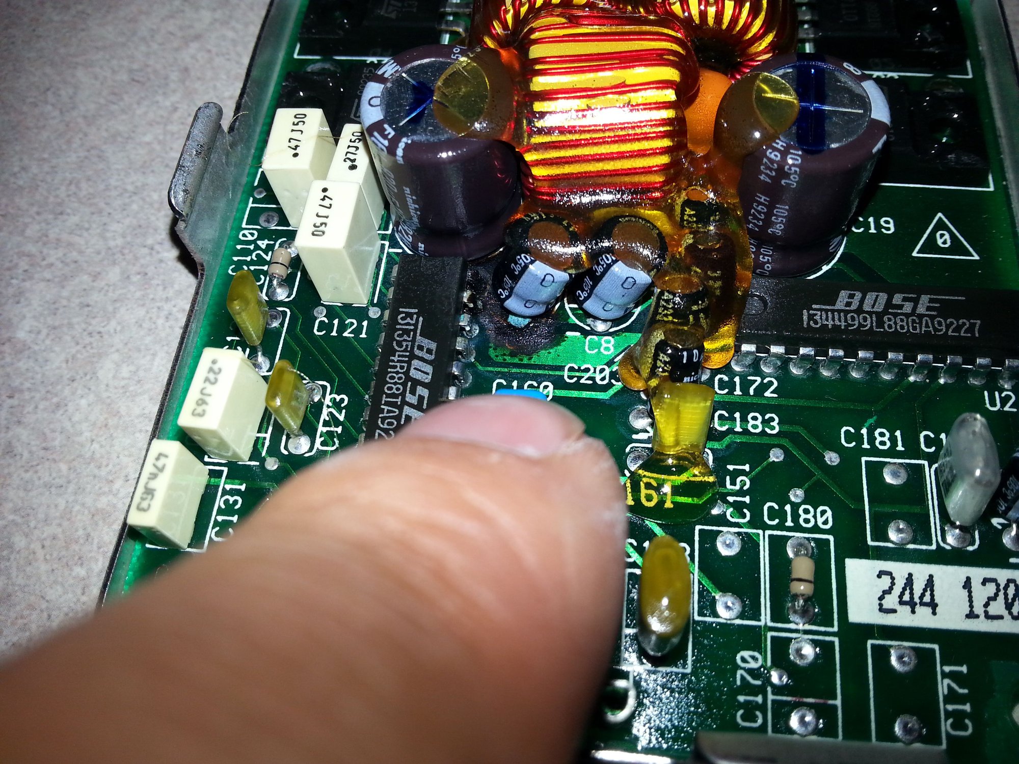

having trouble with amp on rear right corner of the car. reading on line the capacitor’s go bad and need replacing, I have replace capacitor on other things, but not sure on this I see black like burnt on the bottom of one capacitor I was think this is the bad capacitor that needs replacing any help or input would great thank you

well I replaced it I went to the local radio shack bought a 47 uf 35v capacitor easy fix works like new again, cost was $1.49
