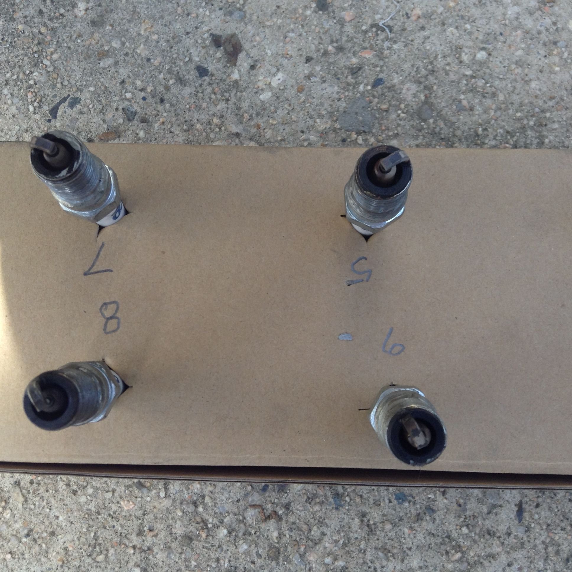

Default Spark plugs
Originally Posted by antfarmer2
Look at the o2 wire might be melted or worn by miss routing.
How do these plugs look? Removed about a week ago with about 900 miles on them? Plugs, O2's, plug wires and Bosch III injectors all all at about same time.
Thanks

#8 appears fouled they all but #4 look like engine is running rich. Of course misfires can cause over fueling. I would clean or replace plugs and check firing order to be sure wires fully seated at both ends and not crossed. It is possible to use oscilloscope to check ignition operation.
After removing plugs cleaned, checked gap and re-installed. Had the opti exposed so double checked the plug wire locations.
I'm taking the Vette into local shop this Thursday, asked them to do an oscilloscope.
Thanks

Well your plugs look like the end cyls/plugs are a little sooty and i believe the '93 cars were batch fire where all the injectors fire at the same time so my guess here is the fueling is ok and the end cyls just arent firing for some reason - at least not as well at the middle cyls.
