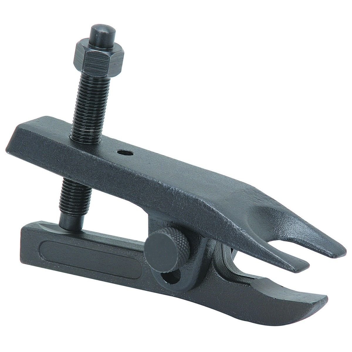

Yes they are! I ended up using my harbor freight ball joint seperator tool. I just drilled the heads off the rivets and then used a small bolt to press each rivet out. Worked like a charm!!

I used that same BJ seperator. I had to grind a taper on the fork to fit on the lowers though. Otherwise it wouldn't go in far enough. Worked great. Hopefully mine will press in without issue. I redid my rear suspension a couple years ago with energy suspension poly bushings and have no complaints. As for lowering, can't help you there. I don't want mine any lower here in NY lol.

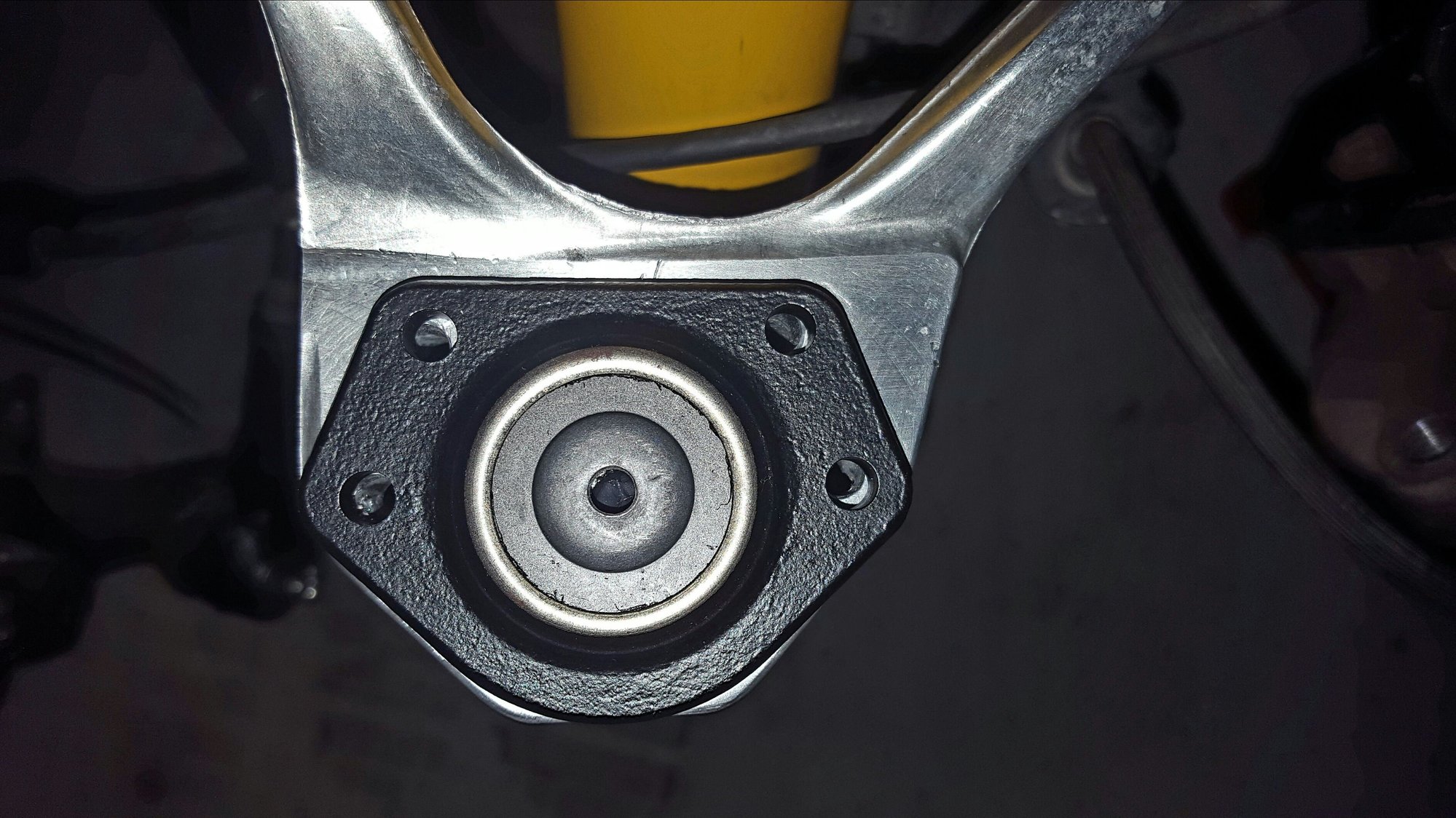

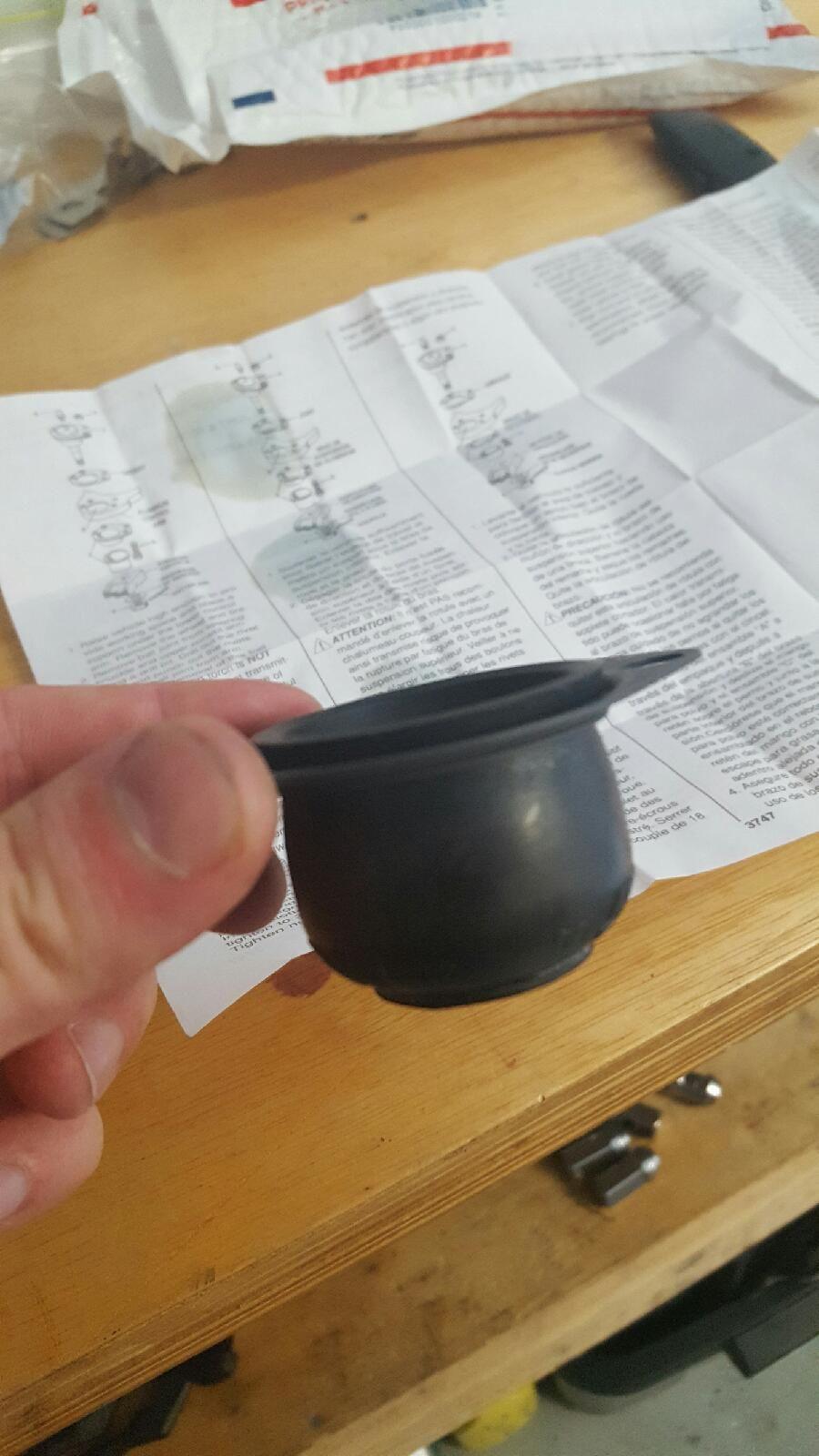

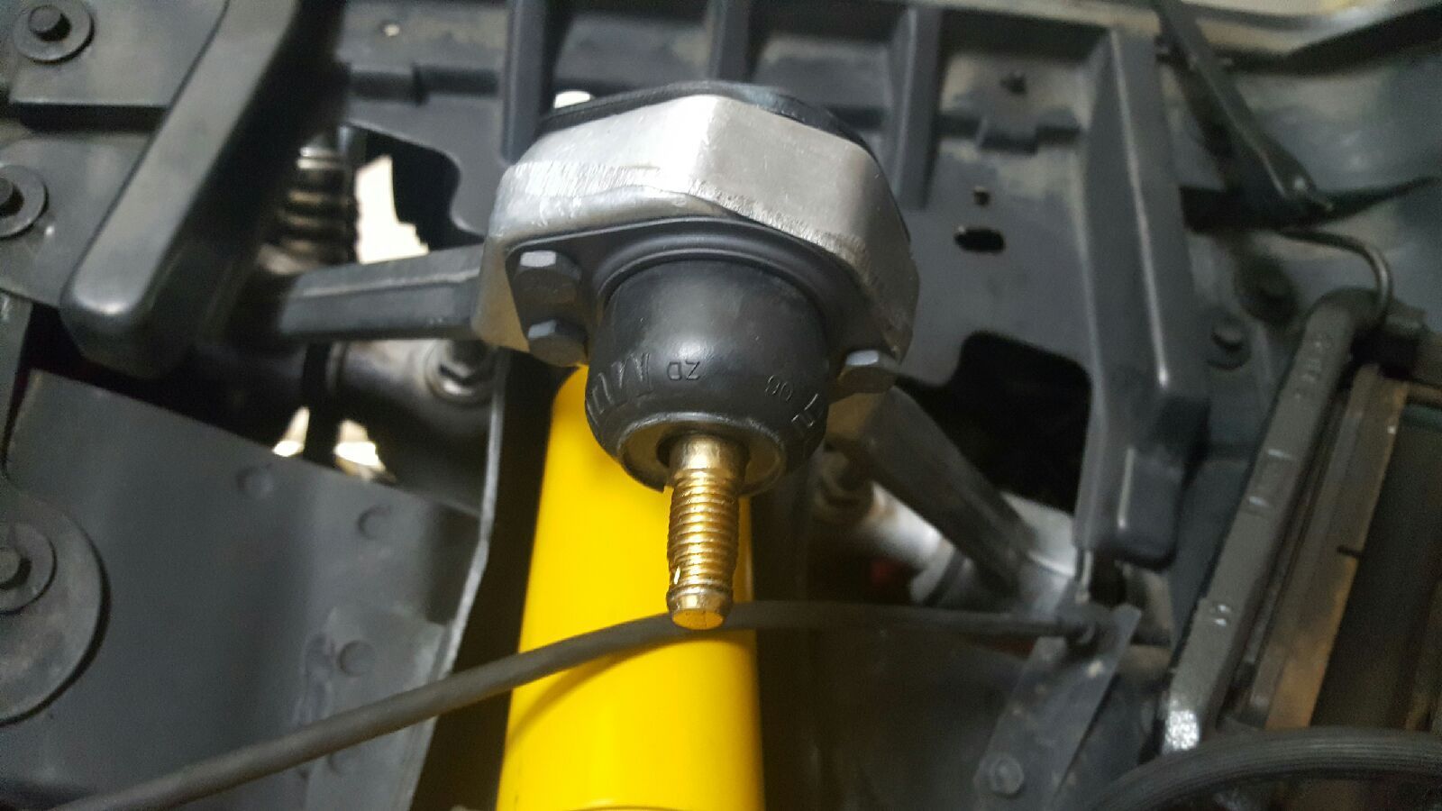

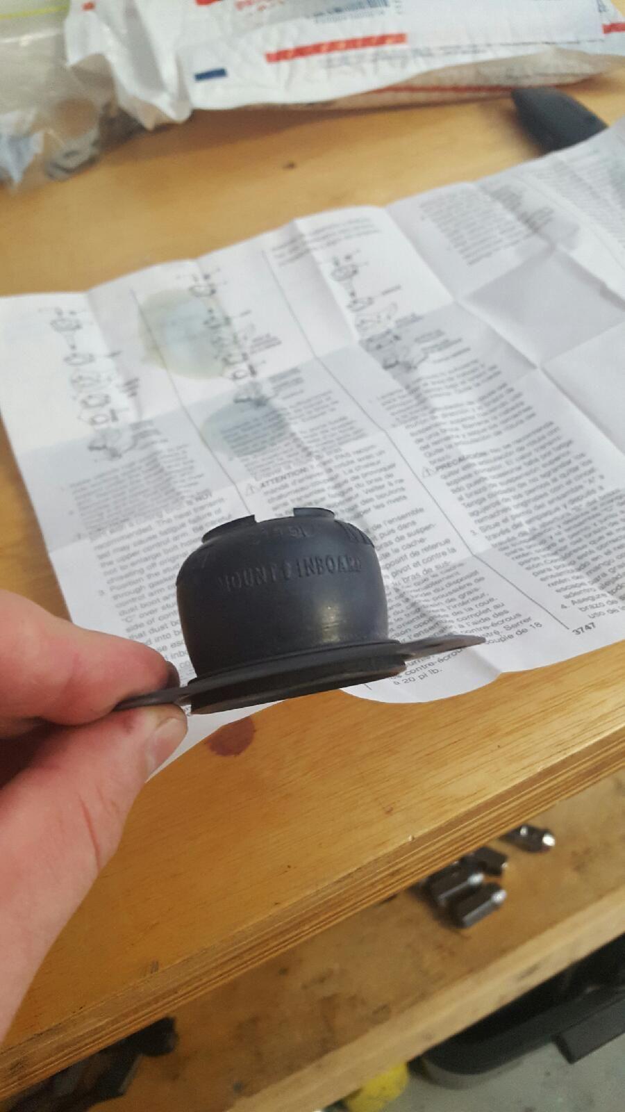

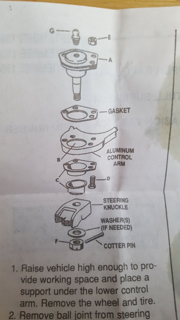

Now on to the upper ball joints. I received the Moogs. All the holes line up perfectly! for some reason I can't tell if I have this assembled correctly so if someone that is familiar with Moog upper ball joints can look at this and tell me if I am right. I just have it mocked up at the moment. No upper gasket and no grease zerk.
Instructions Diagram:
I believe this is correct. Was just hoping someone that has installed these Moog uppers before could confirm for me. Thanks!

Just finished the driver side lastnight. Did the lower on the pass side this morning. I have to wait to do my upper since the box was missing the boot, flange and gasket! You are correct, the boot lip sits inside the flange.

Are you serious with the thread engagement on those nuts? 2 threads maybe? It is nice to see 1 thread above the nut and scary to see not fully engaged. The gasket is for galvanic corrosion steel on aluminum.
Calm down bro. It's just mocked up. A wrench has not even touch those nuts. I just spun them in for the pic.

Also, doubt the gasket is for galvanic corrosion. The factory ball joint was on there for 22 years and 125,000 miles with no gasket. Its there to help seal the ball joint itself. Grease will fill the whole assembly.
