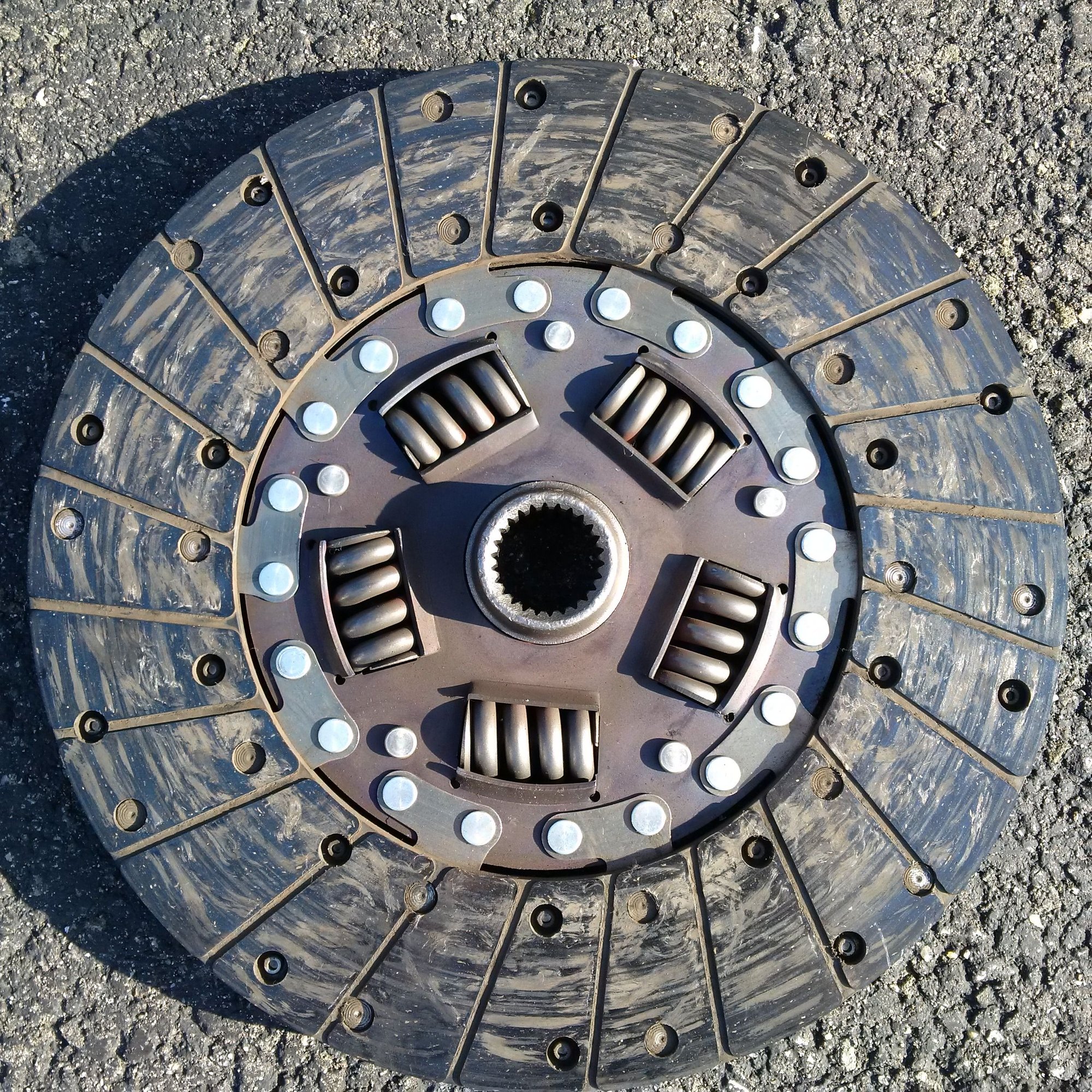

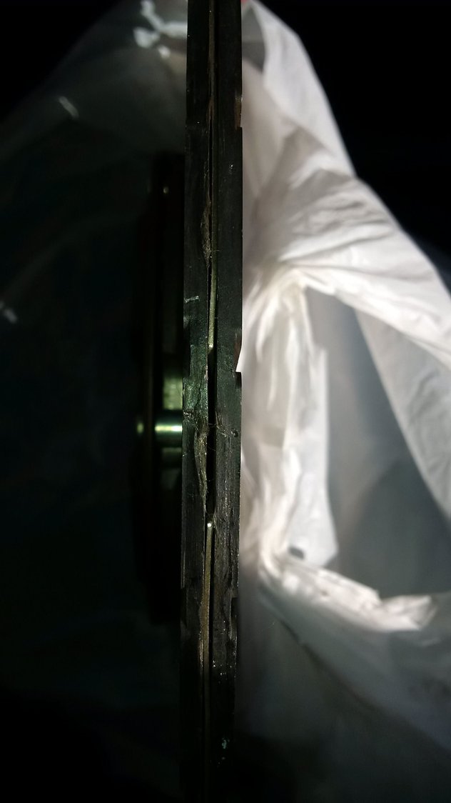

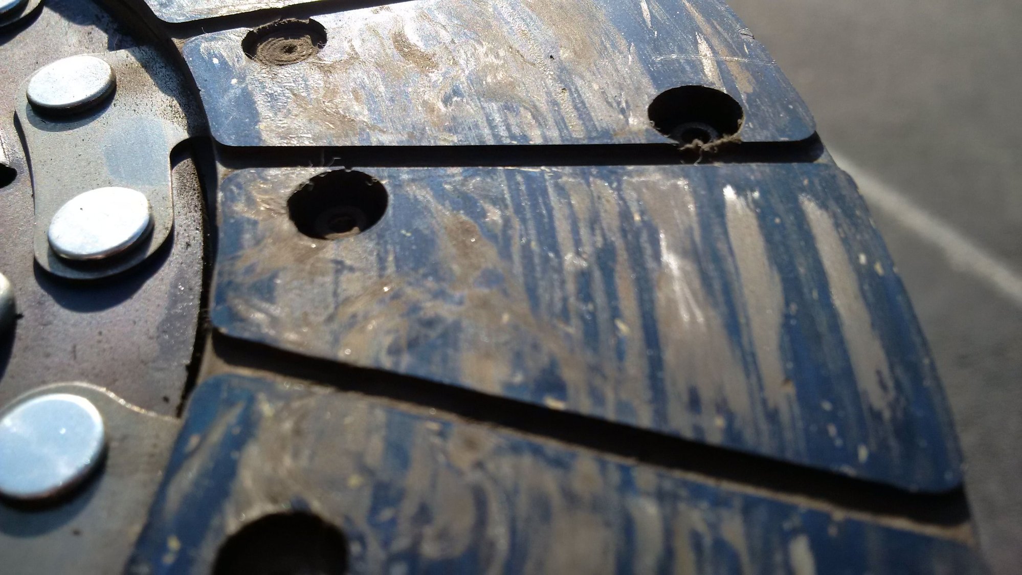

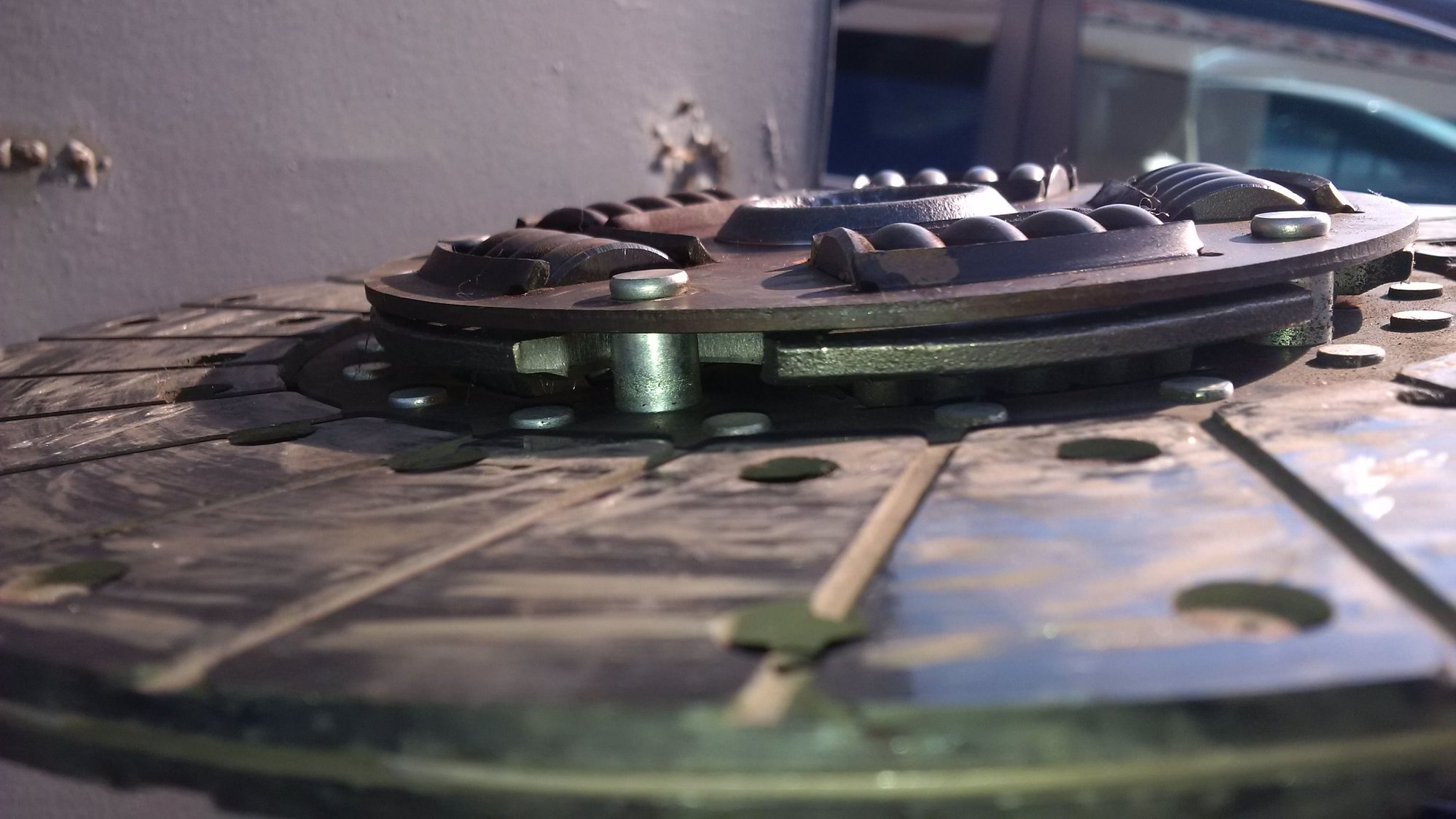

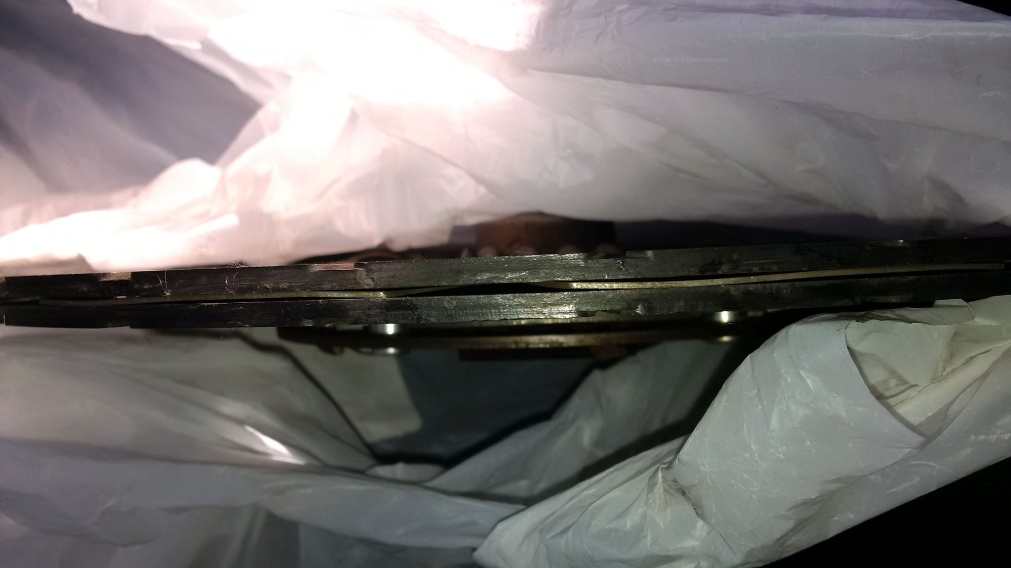

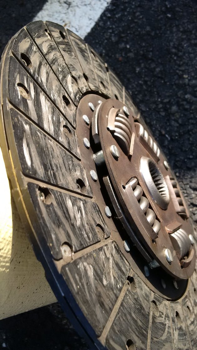

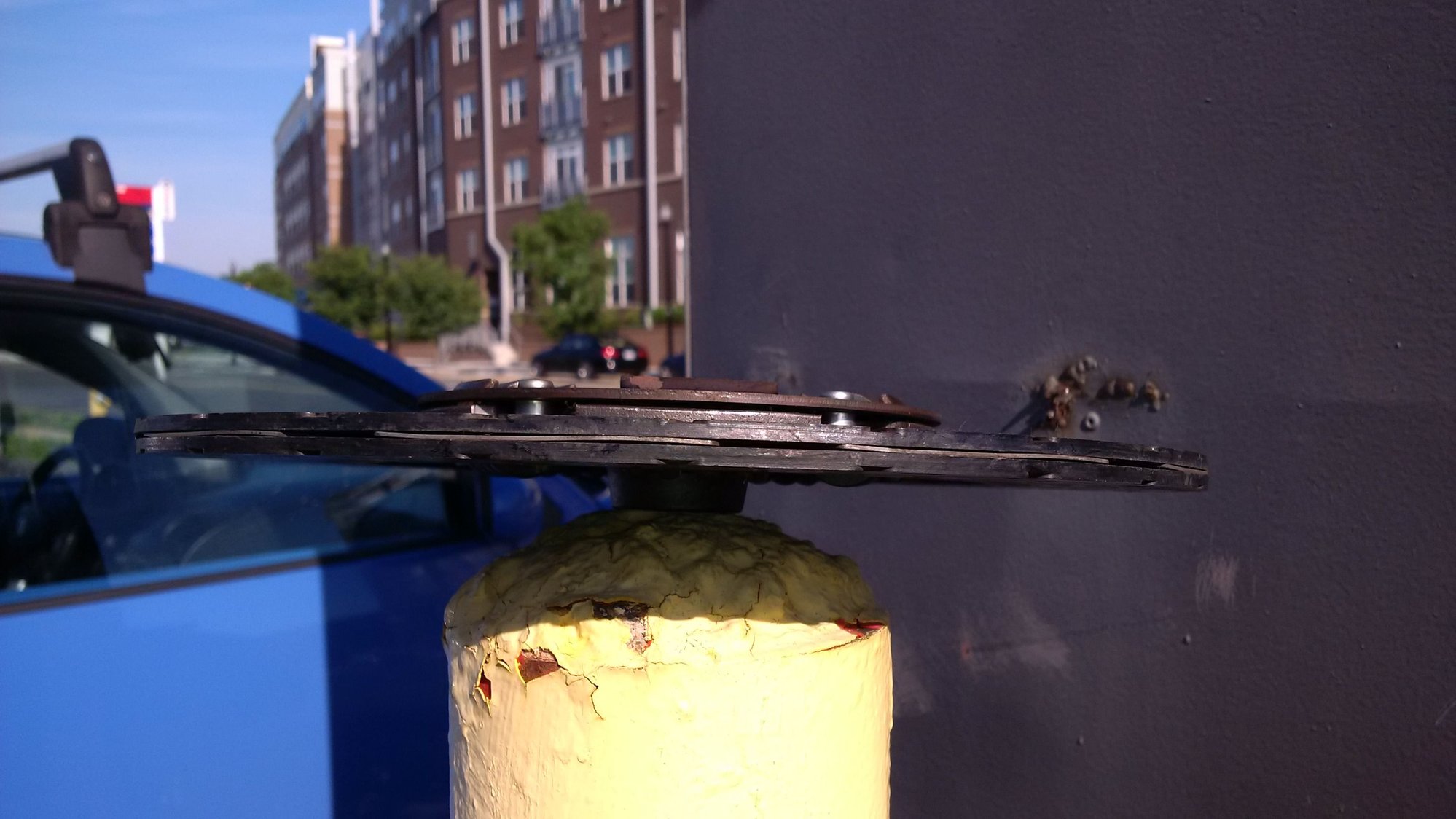

I'm adding some pictures of the clutch itself in case it gives any clues as to what the problem is. I have to have a solution by today and I'd really appreciate any suggestions; otherwise, the 'vette will go back together without trans... this is really my only opportunity to fix it in the next two years
Cushion springs seem properly waved
Not 100% sure I didnt accidentally do this while taking pictures

Is anything else discolored, blued? I would be looking at the face of the flywheel and pressure plate, were those surfaces cleaned before assembly. Also, the fingers on the pressure plate and throw out bearing fork where the bearing rides and inspect the pilot shaft bearing. Was there any freeplay in the pedal before engaging and disengaging the clutch?

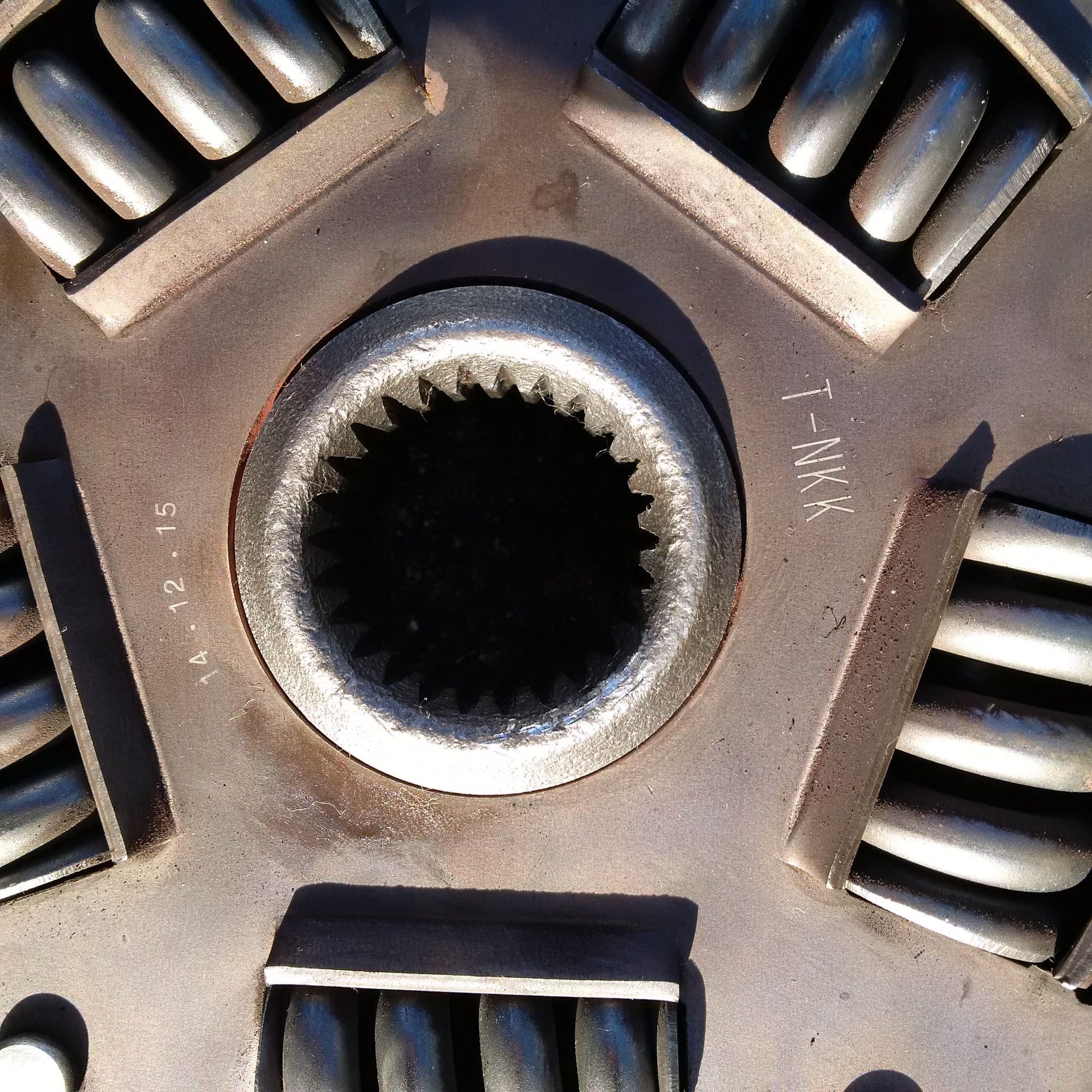

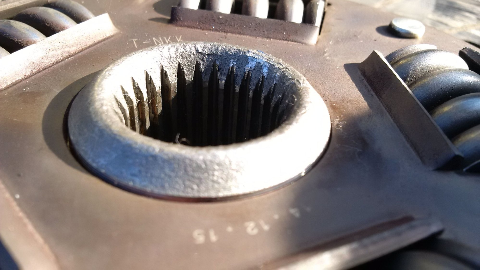

looks like date of mgr is 12-15?
Almost sounds like its a stacking issue but how if its Delco stuff. Receipts?

A (properly) machined flywheel will not cause this.
A bad TOB isn't likely to cause this either.
You need to break down the root cause; Hydraulics, mechanical actuation, or the clutch itself? What would cause a clutch to slip?
*Oil on the clutch (not present in your pics)
*A partially released clutch (actuation not releasing all the way)
*A faulty clutch; install, broken diaphragm etc.
The first thing *I* would check is, is the hydraulic system releasing all the way? If your pedal isn't returning all the way, the replenishing port won't be opened, and you could have pressure in the hyd line, holding the clutch partly released. I'd put the car up, get under and see if I could compress the slave. You should be able to by hand. If I could not...there is the problem. If I could, then with the slave compressed, (so the fork should be loose now), I'd try to move the fork and see if it hangs/binds in the limited travel that it would have at that point. If the slave were compressible and the fork seemed free, time to move on. I'd say the hydraulics/actuation system are fine.
The remaining checks would be inside the bell housing and the clutch itself. Not much other than the clutch that could cause this...other than the TOB binding on the input shaft sleeve. I've seen where this sleeve becomes so worn that the TOB gets cockeyed on it, and binds. This could happen, and prevent the TOB from coming back off the diaphragm fingers all the way. That would cause it to slip.
If that were in good order, I'd be scrutinizing the hell out of the pressure plate/spring etc. Something would have to be wrong in there.
FYI, a new clutch shouldn't slip under throttle/acceleration, "broken in" or not.

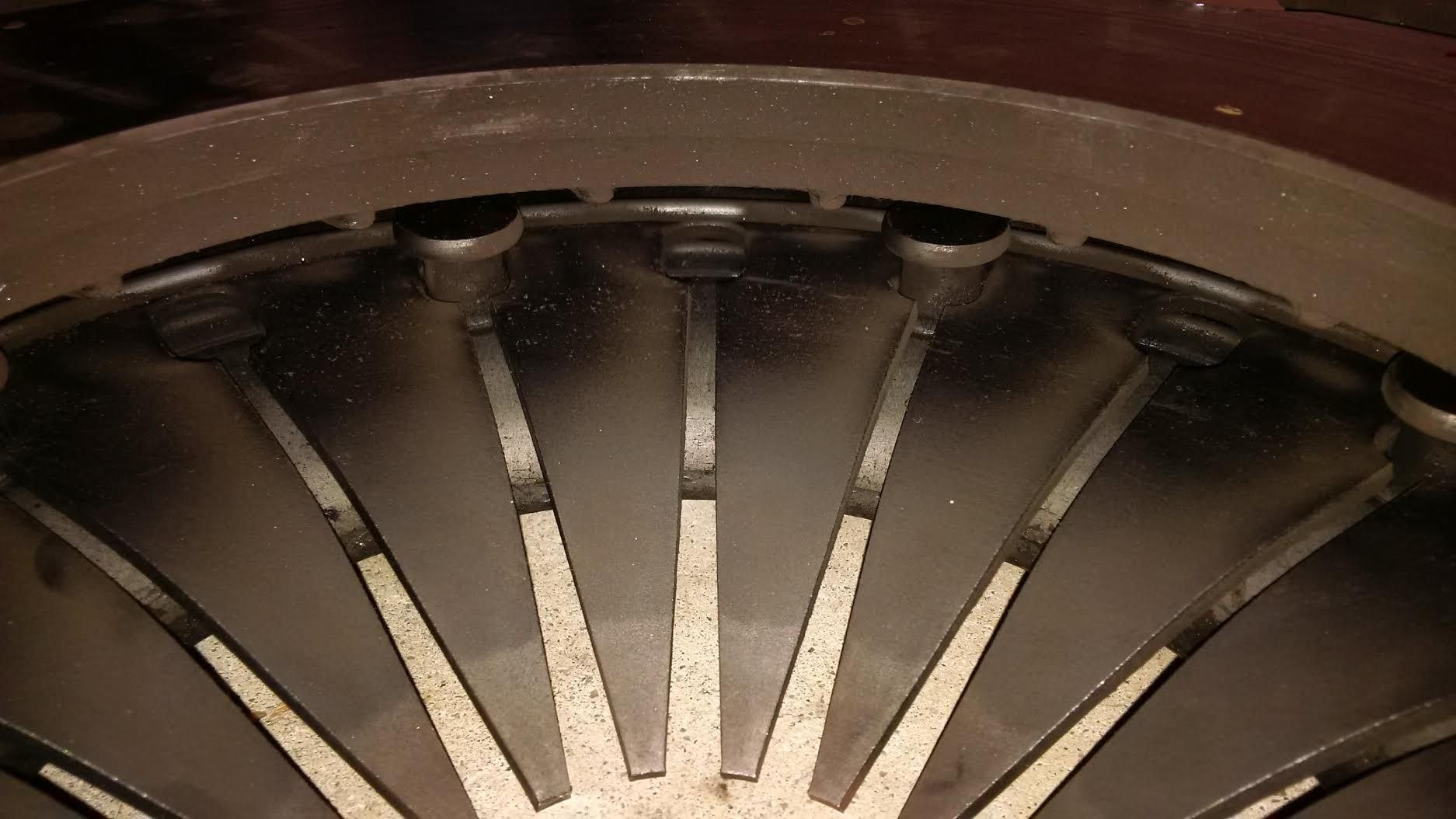

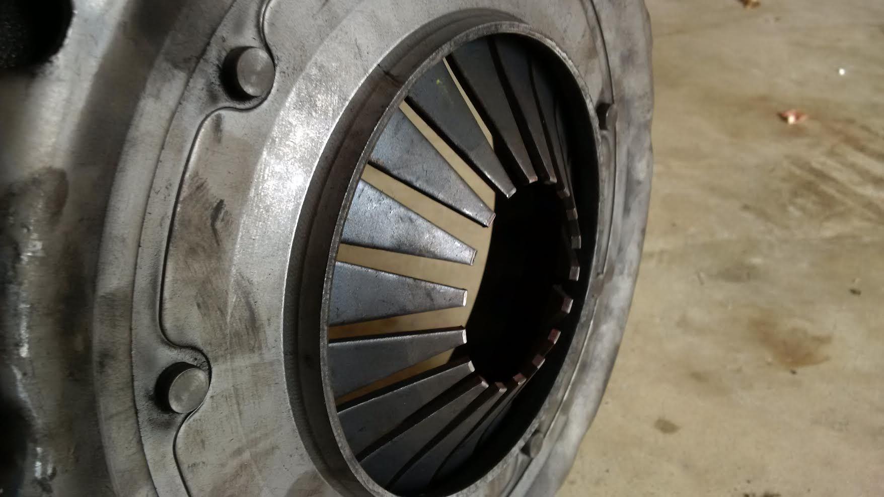

Here are some pictures of the pressure plate as I could definitely be missing something.

I believe it is a 12/14/15 date of manufacture, which makes it very recent. I'm getting AC Delco to replace the kit under warranty--which is nice--but I'm afraid the same result will occur. The mechanic is someone I've known a long time and while it would be most prudent to do as you would, I really have to resolve the issue more amicably. But you're completely right and it's certainly a frustrating situation. I'm honestly not sure if he test drove it, but it took a long time to get the mechanic next door to confirm the issue when he couldn't drive it to diagnose the issue as slipping and that probably exacerbated the issue. At this point I just want him to install the clutch properly and carefully (I even bought the shop manual and handed it over to him before the first one) and not charge me an arm and a leg. If there's an issue after this, it's going straight to the Corvette specialty shop that just opened up not far away The car is only getting worse after bad repairs, and it kills me to let this happen. It would've been cheaper anyways.

Old Jul 18, 2016 | 02:42 PM
mtwoolford's Avatar
mtwoolford
Joined: Jan 2009
Posts: 3,482
Likes: 196
From: folsom california
nothing looks that bad but
(1) the crankshaft does have a pilot bearing?
(2) put a flat edge across the face of the pressure plate and see if it has warped (seen that)
(3) put a flat edge across the flywheel surface and confirm that it is flat
(4) with the flywheel installed, rotate the crank and with a dial indicator or feeler gages, confirm that there is no "wobble" at the outer edge of the flywheel; ( I saw a barely perceptible burr at the crankshaft / flywheel mounting surface throw a 0.040 inch wobble at the flywheel outer edge)
(5) check the end play of the crankshaft, a worn thrust bearing / crankshaft thrust surface can induce clutch engagement / disengagement issues (seen that one too)

All the photos that were shown I didn't see any real wear that would make the clutch slip, Worn yes Killed No.

I'll be sure to do that and really appreciate the help. One last question: if I'm unable to get the push rod in a reasonable amount of time, would you consider it critical to install a new one (in theory or in practice)? Your endorsement of replacing it makes me lean heavily towards doing so (not to mention the worry factor), but it could be a matter of needing to vacate the car's current spot within the next couple of days. I think I'll be ordering a new reman unit tomorrow and see if I can get expedited shipping, but I figured I'd just throw in another stupid question while I had the attention of knowledgeable people
EDIT: Any opinions on this as a solution? Viable? https://www.corvetteforum.com/forums...post1585624677

Clean up the rod you have get the car back on the road, order up or find a replacement.
as for the home made rod link, no need not worth the effort to many donors out there and it's cheap new
http://www.ecklerscorvette.com/corve...1984-1988.html
I almost wonder if you even Have the right rod now if it is to long, with out having the car in front of me and seeing if the Slave is bottomed out in the bore (which it shouldn't be) when assembled you should be able push the slave plunger in and make the rod loose.
