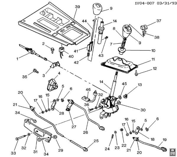

Well, the new clutch is in and everything appears to be fine clutch-wise. However, there's now an issue with the shifter; apparently the reverse rod will not go far enough to hook up to the correct location (?)
What the mechanic told me was that it was an issue with the shifter itself. I know this is more of a 4+3-centric issue, but at least figured that there could be some more minor culprit that would be related to clutch replacement. Reverse is part of the overdrive on these cars, but I'm not sure that's relevant to the current problem. As far as symptoms, I was told that the gear lever would simply not move to the left and into the reverse position. Thanks again for the help.

Just like the Clutch let's start with the Basics. The shift levers the T-10 Levers hang down(from shift rod), and I take it they are in Correctly since the car moves properly. the Reverse Lever points up(from shift rod) Opposite of the others.
The only other Question I have was the trans untouched, No repairs done to it Just a trans waiting for a clutch?

Just like the Clutch let's start with the Basics. The shift levers the T-10 Levers hang down, and I take it they are in Correctly since the car moves properly. the Reverse Lever points up Opposite of the others.
The trans wasn't touched; as you said, just a trans waiting for a clutch. I think I see what you're saying in the exploded diagram below. All the mechanic said was that the reverse rod/linkage would not reach far enough and that the issue seemed like a problem with the shifter itself. I don't really see how a clutch job could cause this problem, but I figure there might be some sort of simple solution. I'll go by tomorrow earlier and try to get more details.

I am sure it is something simple, it's a unbolt re-bolt process so I would start with a even more basic look, Make sure the Key is in the Ignition and the car is in Neutral. remember when you secure your car and you want your Key back you need to lock in Reverse and that I believe locks the rod too which would make sense.

there's a simple procedure for initially aligning the shifter forks...no I don't have it at hand, but any decent manual or google search should reveal it...and the bushings, no. 5 , tend to wear over time and need replacement...stock are usually Teflon, so they don't last forever. That's about it (p.s. there are metal "performance" bushings available but stay away from them; not so much the vibration as the constant "buzzing" they make).
the shifter arms need to be aligned; see my previous post

Went back to the mechanic today to run through the possibilities. He said that the reverse rod simply wouldn't extend far enough and was about an inch too short. He also said that if he were to hook it up with the car in reverse, it would mean that the car would have to be started in reverse every time. I urged him to look at the shop manual I gave him, but he seemed confident that no further information would help to fix the issue. While I thought this was probably somehow related to the reverse ignition lockout, he insisted that it was a separate issue that didn't surface the last two clutch jobs.
So is there something blatantly obvious I'm overlooking here, or could it really be a problem with the shifter? Whatever it takes to get the car back on the road...

If you try to hook up the Reverse linkage wrong it will be short, I am Sorry to say I am loosing Confidence in your Mechanic, And I try not to be Judgmental anyone can have a off day
Put someone in the car go through the gears clear out the shiftier gates. Make sure the car is in Neutral in the shiftier and in Neutral below (that means you can spin the wheels by hand) make sure T-10 arms are hanging down from the rods and Reverse is pointing up from rod and try again
If the rods are put though their paces are they moving, unless the Reverse rod was pushed in and is jammed in the tower, but that would take a big push with a very worn Shiftier.
