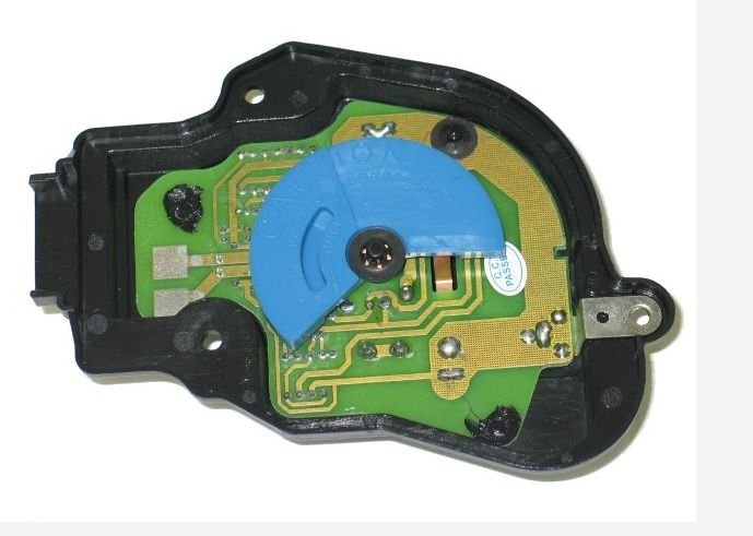

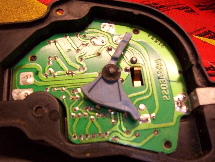

I believe there are two different caps for the wiper motor, the first, like my 84.
The second for 88-96.
Not sure if they are interchangeable..

Thanx for the pics I need the one like the 84 anyway any clues on where to get one? Jay
