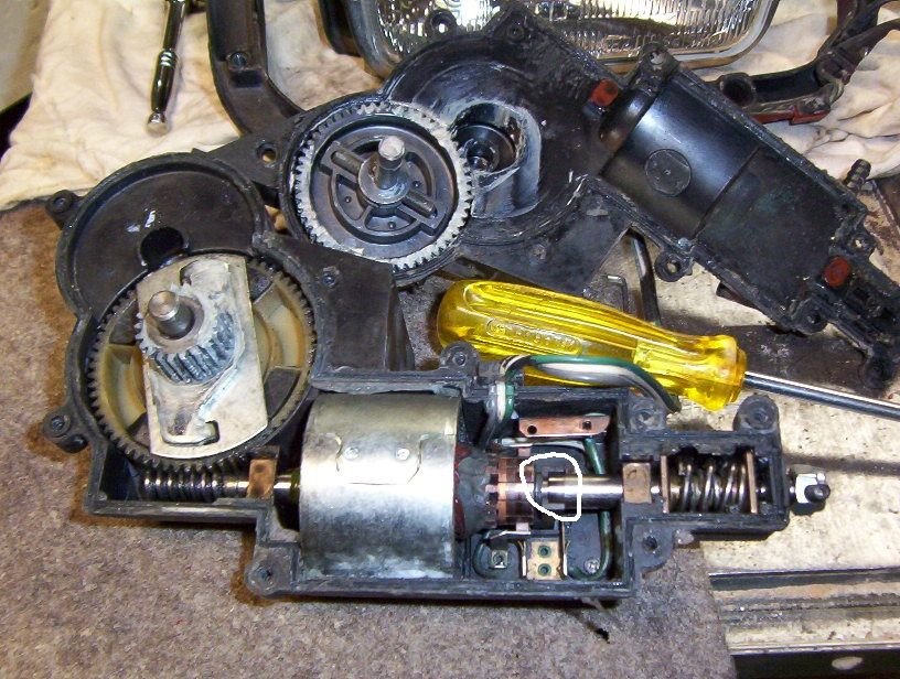

What you probably need is the large white gear in the pic. Over time the worm gear wears a grove in it. With the motor out and plugged in it will keep running and never reverse. It requires the motor shifting the light either to open or closed stops to shift the armature and open internal contacts..

Since the headlight will go up when you bump the headlight door, and will go down okay, that tells me your gears are probably good. And since you didn't say anything about hearing the motor run but the headlight door not moving, that also tells me the gears are probably good. When you remove the motor, it will continue to run, just as you have explained! The headlight door needs to bump into the stops at the end of its travel, either up or down, to set the limit switches, which causes the motor to stop as it should.
Cliff Harris has a good description for fixing the early ('84 - '87) headlight motors. In his post, he shows the worn out gears (which I don't think is your problem) and the limit switches. Try cleaning your limit switches. If they get dirty, the motor will stop at the wrong time! Apply some light weight white grease to the motor bearings. The motor armature needs to shift up and down in the bearings when the headlight door hit the stops to actuate the limit switches. Here's his post:

Here is a pic showing the contacts (circled in white) that are used to shut the motor off when it reaches its stops, opened and closed. Also the brushes are circled in red, I'd be interested in knowing how you changed them???

I'm confused. What did you replace? ccrazor has an excellent picture showing the limit switch contacts and the motor brushes.

In the pic in post #3 I used the white to indicate the piece that is attached to the armature shaft to open the contacts when it reached one stop or the other..
