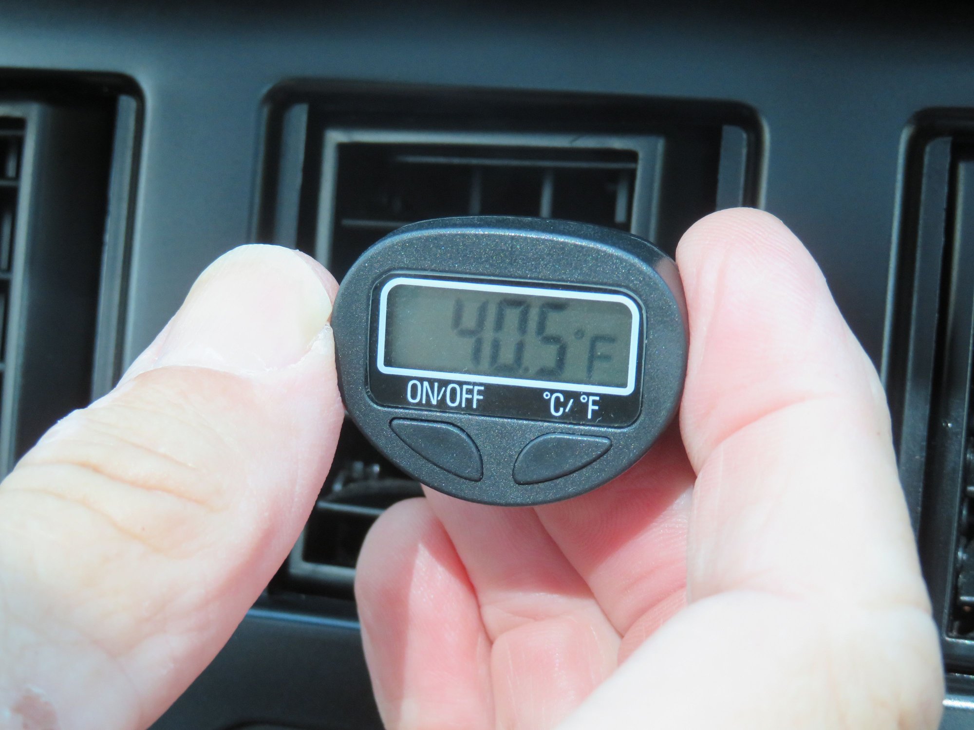

on checking the HP/LP cycling switches, and while it may not cool quite as much as R12, my 134a conversions gets pretty friggin' cold - hot, humid, and in florida...
40.5° cruise, about 55° in stop/go traffic, and outside temp, around 90° -- it may not be perfect, but it works for me....
Not a "may not". More of a "will not" from what I have seen.
