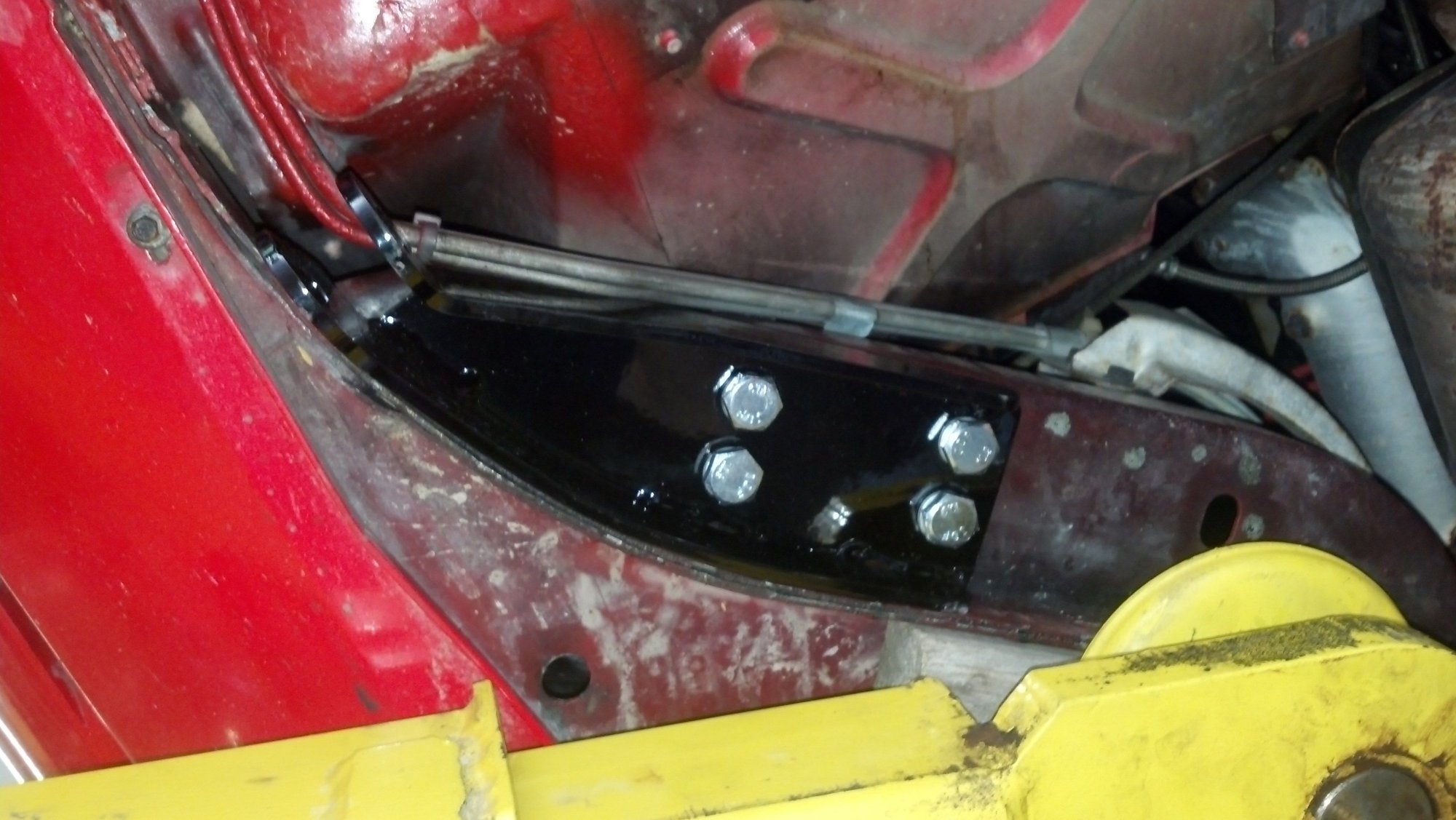

Why can't you just jack from the factory recommended jacking point...and then put the stand right next to the jack? Front and rear? That's what I do. I had my car in the air and jack stand'ed in ~4 minutes a couple weeks ago.

I'm not going to take a pic for you, but if you jack from the front jack point (which will lift the entire side of the car off the ground), then use your eyeballs to look under the car, you'll see that you're jacking on what is essentially a frame rail. The rail is made from stampings spot welded together forming a seam that protrudes downward 3/4" or so. That is what your jack is lifting the car on. From the front jacking point where your jack pad is, follow that seam forward (and it bends inward too). Put your jackstand anywhere along that seam...but why not as close to the jack as possible? Cool?
Then if you use your eyeballs again and look under the rear of the rocker area, you'll see that the rear jack point is currently unused; since you've already jacked the whole side of the car from the front jacking point. So, throw your rear stand directly under the rear jack point. Lower the jack (still at the front jack point), the frame will settle onto the two jackstands and one side is done.
Roll your jack around to the other side, jack car from front jack point, place stands in the same relative positions, lower jack, try to push car off stands as a test...car is stand'ed. Less than 5 minutes.

Here is a pic I found on this very forum, that shows where you can put a jack stand. If you jack from teh recommended jacking point, then you can set your (front) stand about where the lift pad is on this two-post. Easy.
