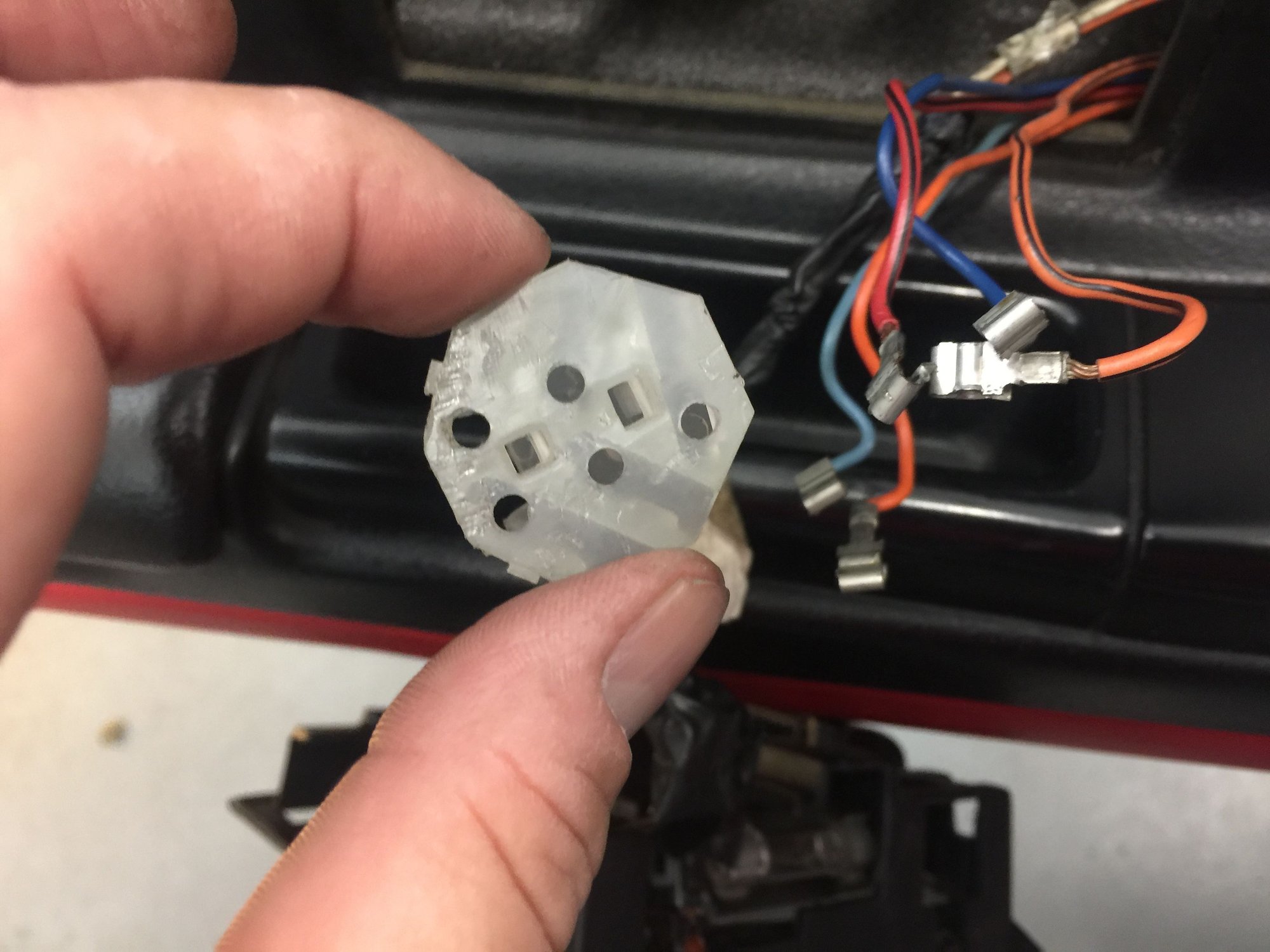

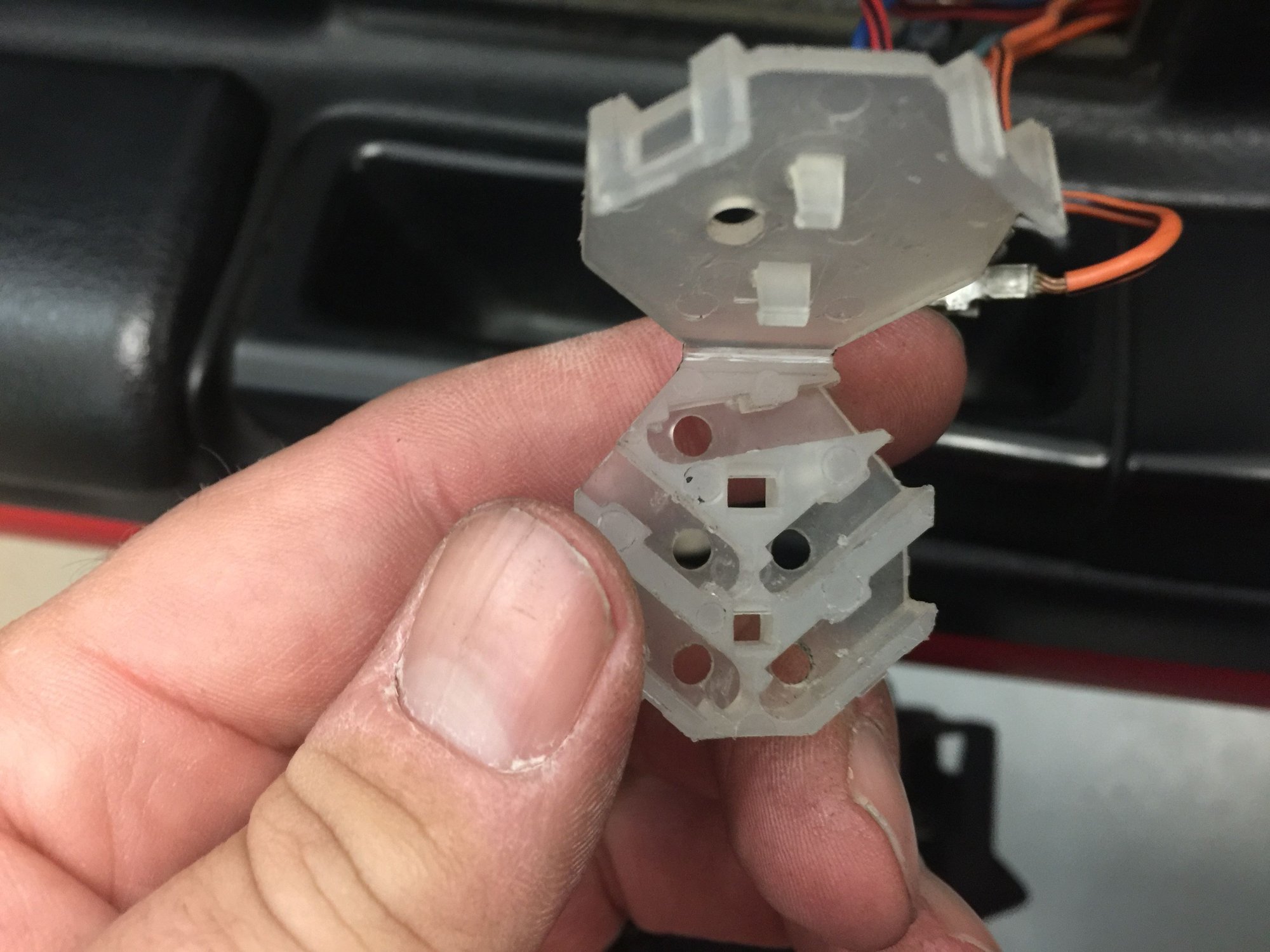

Which wires go in which slot. This is a 94 Corvette.
I need to know which wire goes in which slot.

These 2 images should do it for you. I don't see a BLK wire in your snapshot so I'm quite sure you're in the driver door.
A - ORANGE
B - ORN/BLK
C - LT BLU
D - LT BLU
E - RED/BLK
If you happen to have the FSM 8A-132-0 but I assumed you likely don't.
You might need to swap your LT BLU to correct LOCK/UNLOCK
