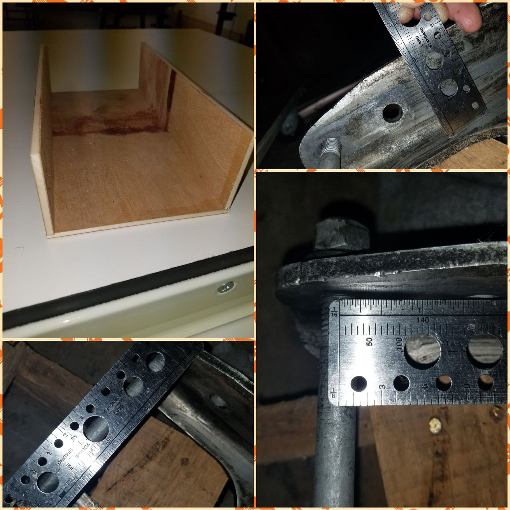

Everyone builds them slightly different. Mine has full gussets everywhere. 3/8in and 1/2in steel throughout. Others make it with aluminum or 1/4in stuff.
template is just fit it around and weld then test fit.

Aloha all,
So I will attempt to build on myself yet share my results/ dimensions to help others hopefully. These are my results your may be slightly different, use this as reference only.
NO measurements will be in pictures till the final fit to ensure erroneous info is not out there.
First draft of the C Beam piece.
First draft of the bottom plate.
